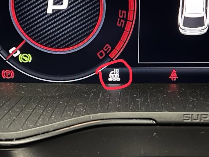

  3. Is there a heated button on your steering wheel? I heard that we need to have new steering wheel with the heated button to get the icon on VC.
  4. I am using MATCH PP 86DSP & 7S-D with my Kodiaq 7-seat for two years. It works perfect with MIB2.5 High and PP-PAC 92b cable.
  5. Does anyone know how to show heated steering wheel icon on VC? I can activate steering wheel heater from Climate Control of head unit but my VC doesn’t have any icon. Skoda Kodiaq 2018
