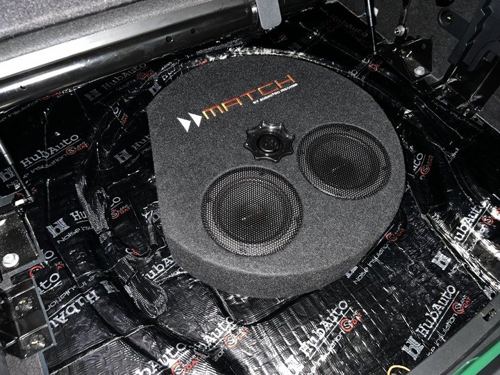

I am using MATCH PP 86DSP & 7S-D with my Kodiaq 7-seat for two years. It works perfect with MIB2.5 High and PP-PAC 92b cable.
Yes but you use without spare tire. I want save spare tire and subwoofer. From yesterday i mount Audio System US8 Active Evo. Today probably finish. When finish i show....
How connect you subwoofer to MIB 2.5 high ? Activate output for subwoofer by mods eeprom ?
There is an extension cable(plug and play) between MATCH PP 86DSP & 7S-D. So I don’t need to do anything to get it working.
