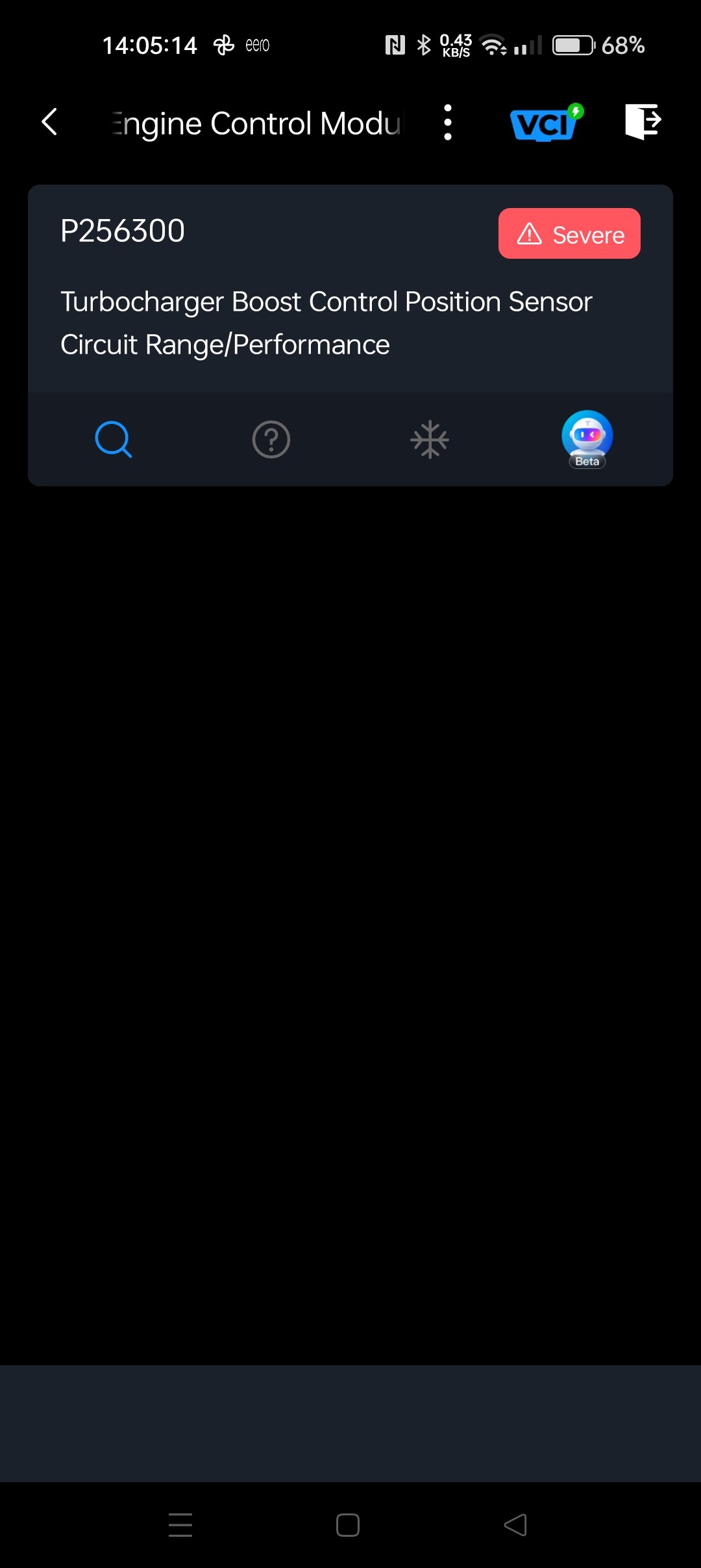

  6. ok i now have it solved ,time will tell but its looking good . it was doing it more when getting off throttle so the code was being thrown by the low boost end of the actuator which needed setting . as per the vid below i set the actuator with key on engine off ,back probed the middle wire on actuator with multi meter and had a vacuum pump on the pipe which feeds actuator from solenoid as my vac pump pipe was to big for the actuator fitting . loosened the nuts on actuator rod and pumped vac pump until meter read 0.7 volts dc (neg side of multi meter was on car battery neg terminal) then tightened the top nut down to that position ,i then released the vacuum and the arm came up to read 3.3v . i think the fault triggers under 3.3v and below 0.7v at the other end . i did have to mess a little with the settings after tightening up and ended up with 3.35v and 0.78v which seems to be fine now .. if it comes back i'll follow up this post . hope this helps somebody .. thanks for the input .. Dave ...
