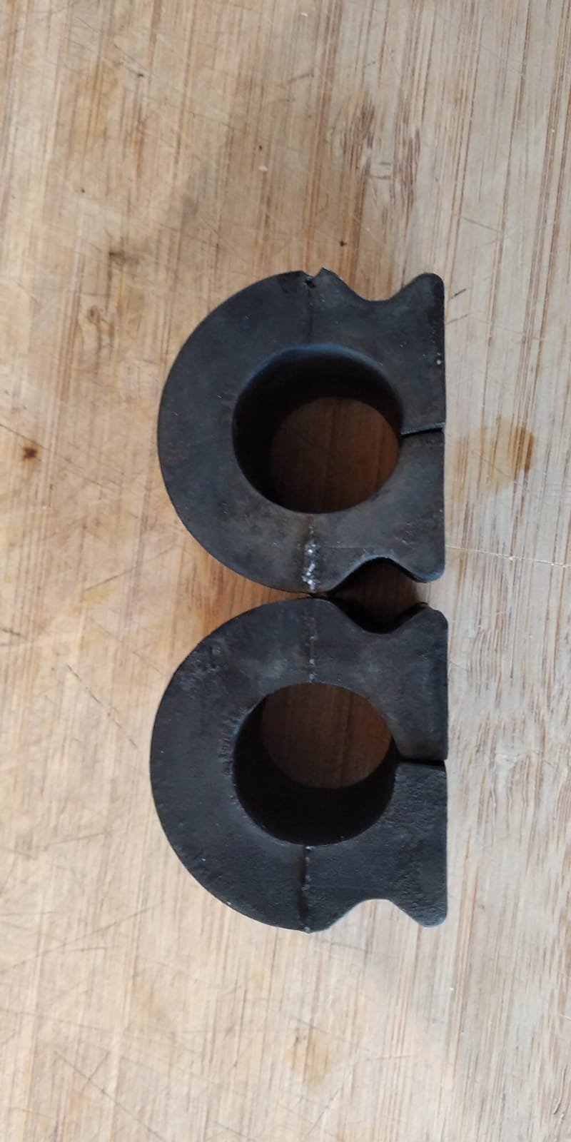

Just fitted new anti roll bar bushes
I had a clunk noise on the nearside front prob down to the sorry state of the roads , Anyway I took wheel off and got pry bar out nothing really obvious with drop link/ball joints etc ,All I could find was a very small amount of play in the anti roll bar bush so I ordered a set and did em today (both sides)  and the clunk is no more 😉 .
They didn't look perished or worn to be honest but but you can see the difference on the noisy one ,The flat side is thinner and softer. Only posting this incase it helps others for a cheap fix (£8)

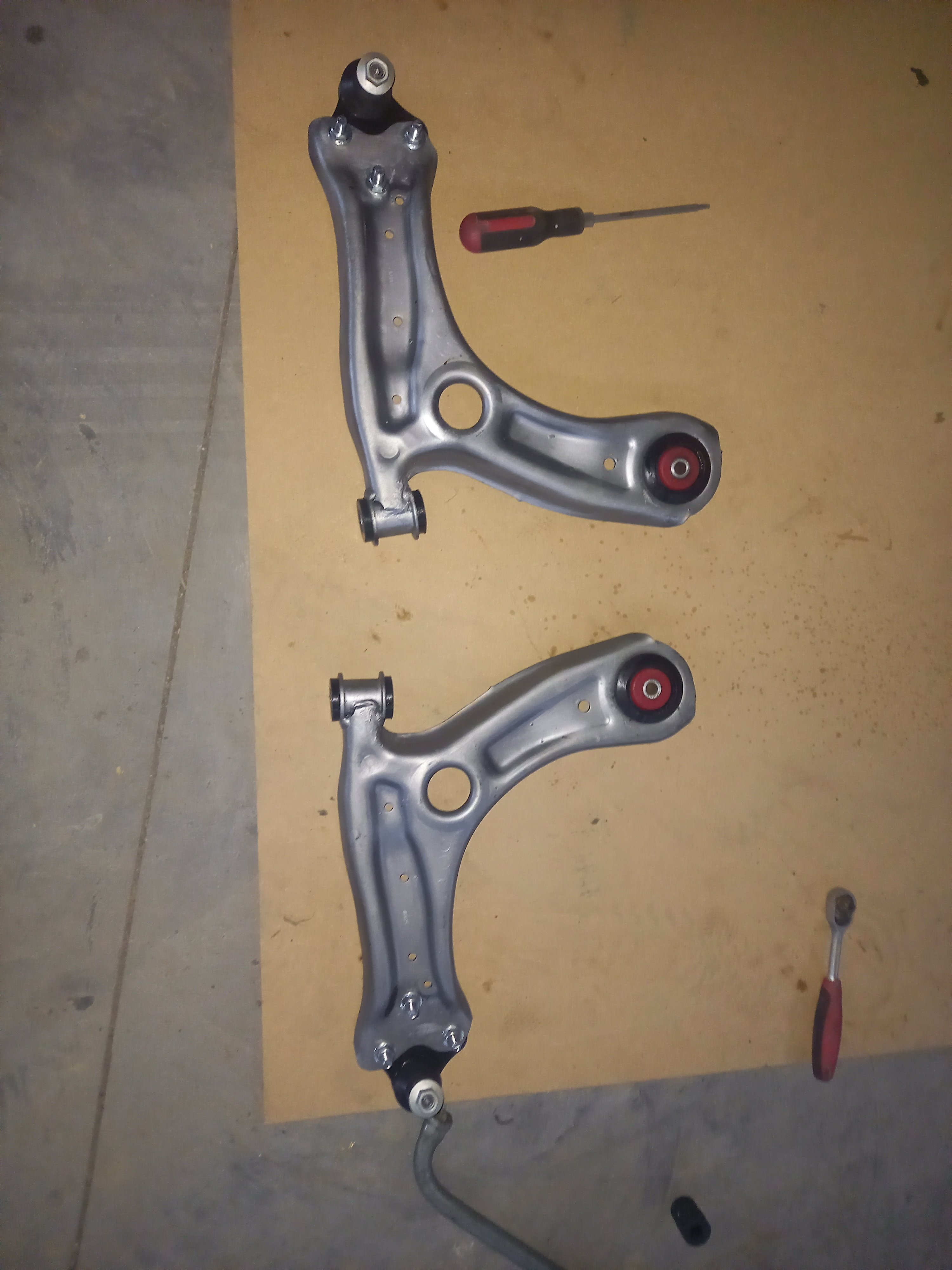

I have PSBushings ones, almost every bush they do aside from the rear beam bush (which will be done soon). They're cheap and do the job well.
If you do the wishbone bushes you'll really only need the rear one, front ones hardly ever wear out although I did do both on mine.

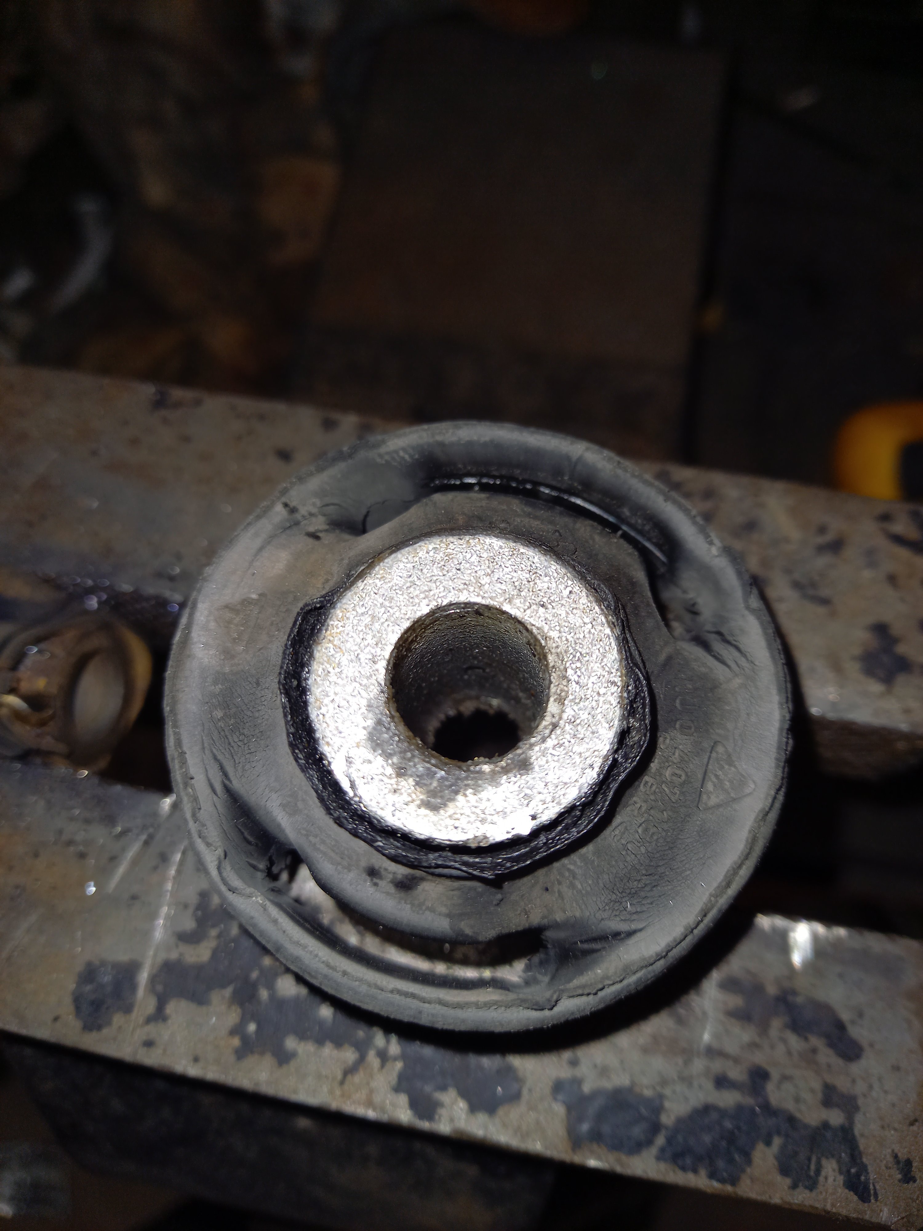

My old ones practically fell out of the wishbone:
Vs the new PSBushing ones:

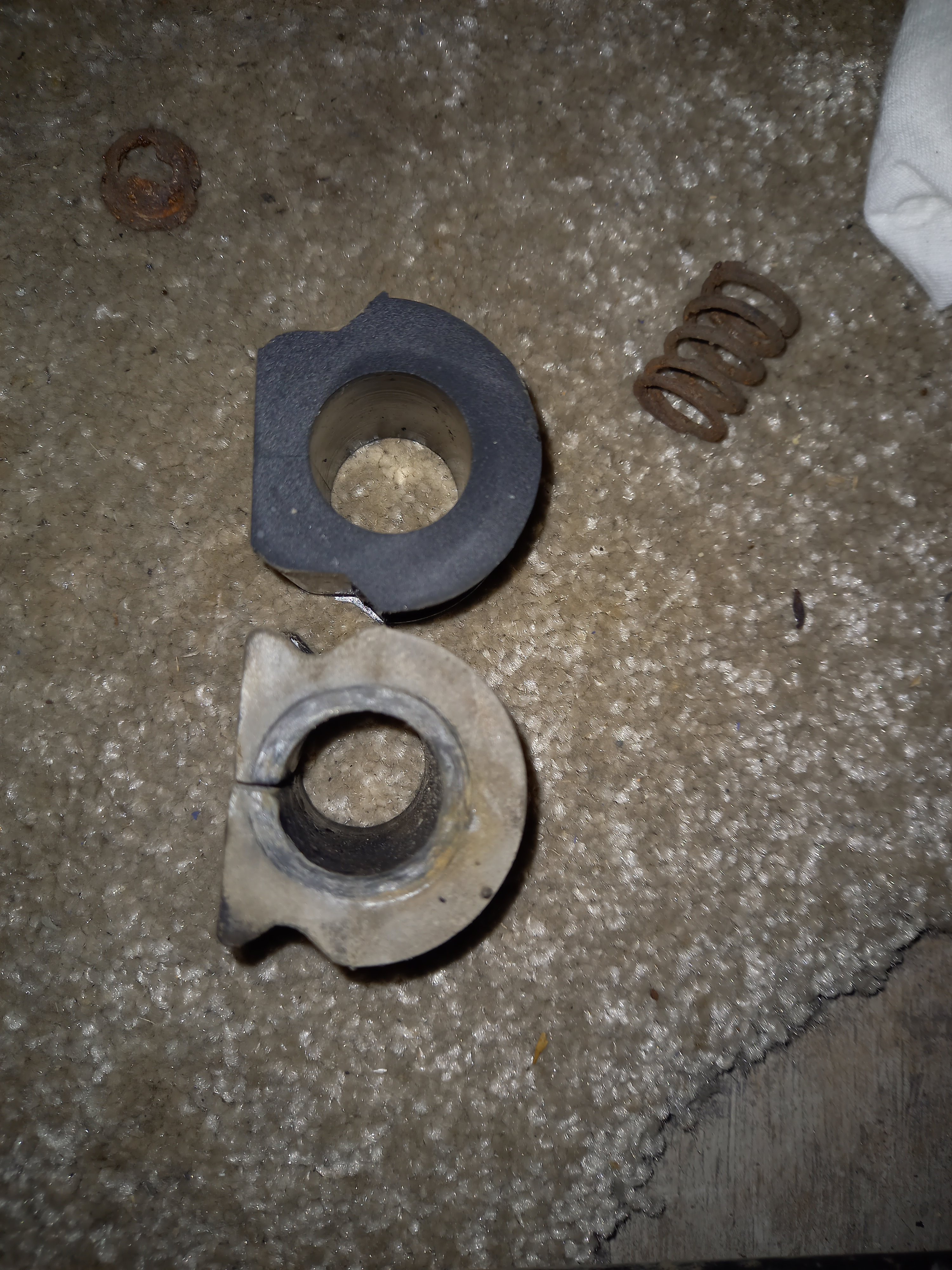

I changed my arb bushes for PSB ones too, had new Rubber ones bought but put these ones in instead, only reason being I got a "kit" of bushes for another fabia, and got the right size arb bush for my car.
