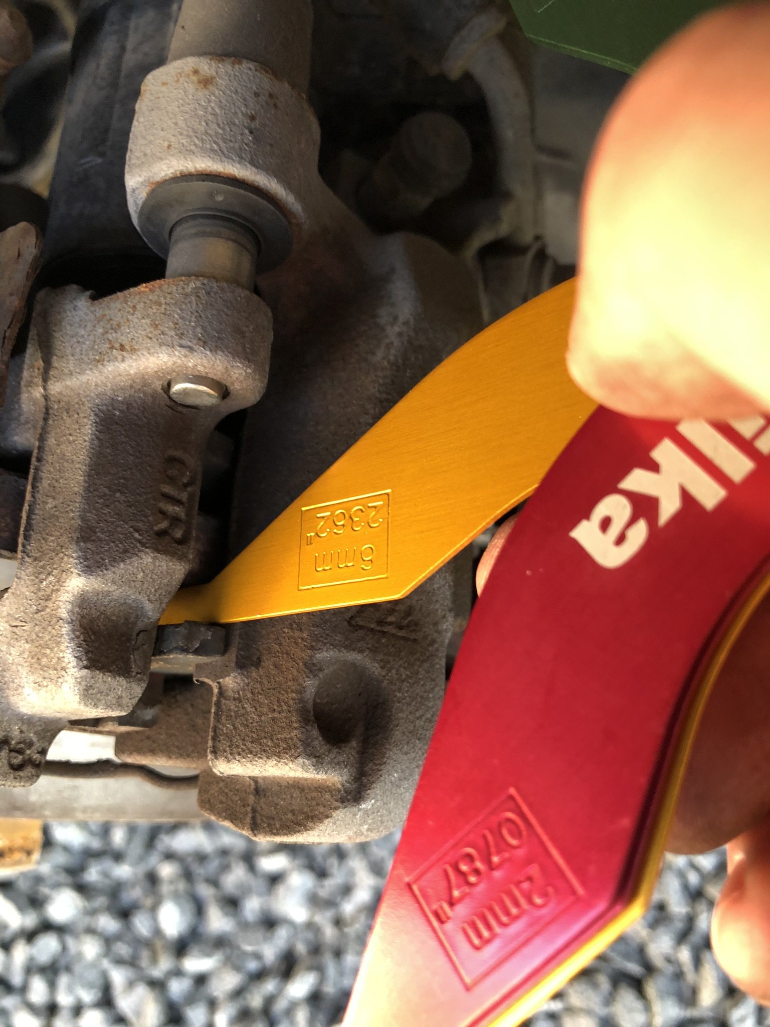

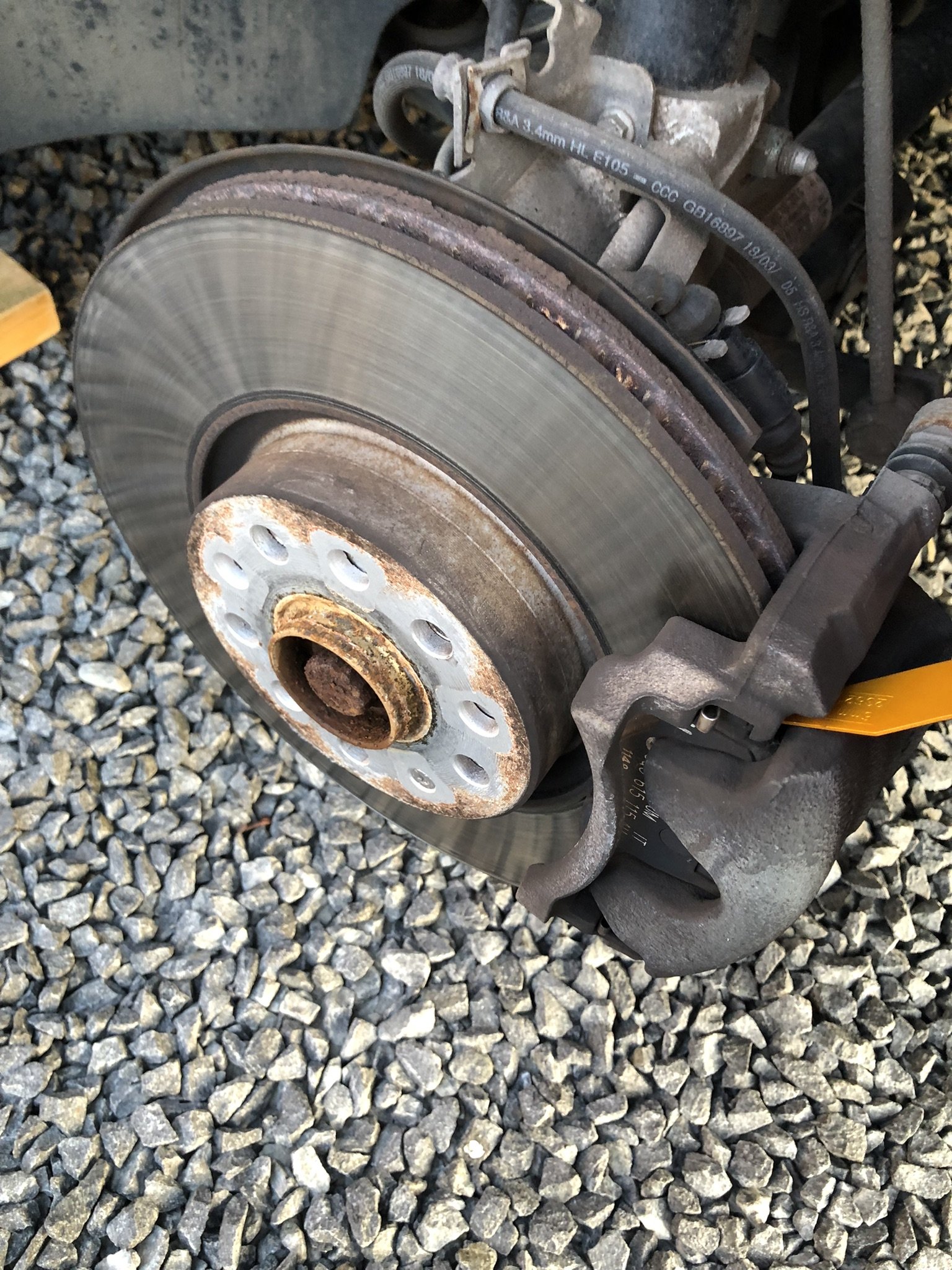

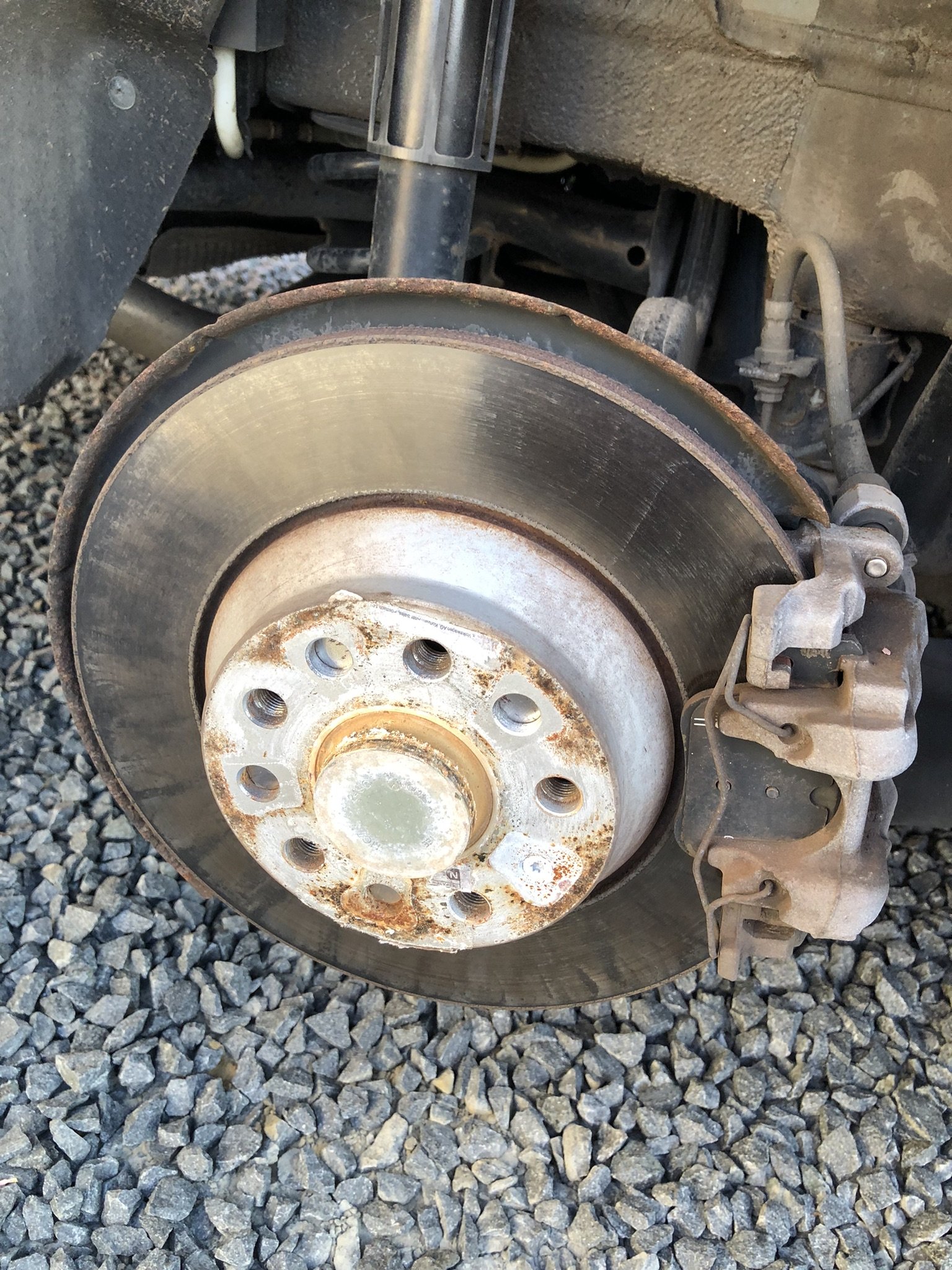

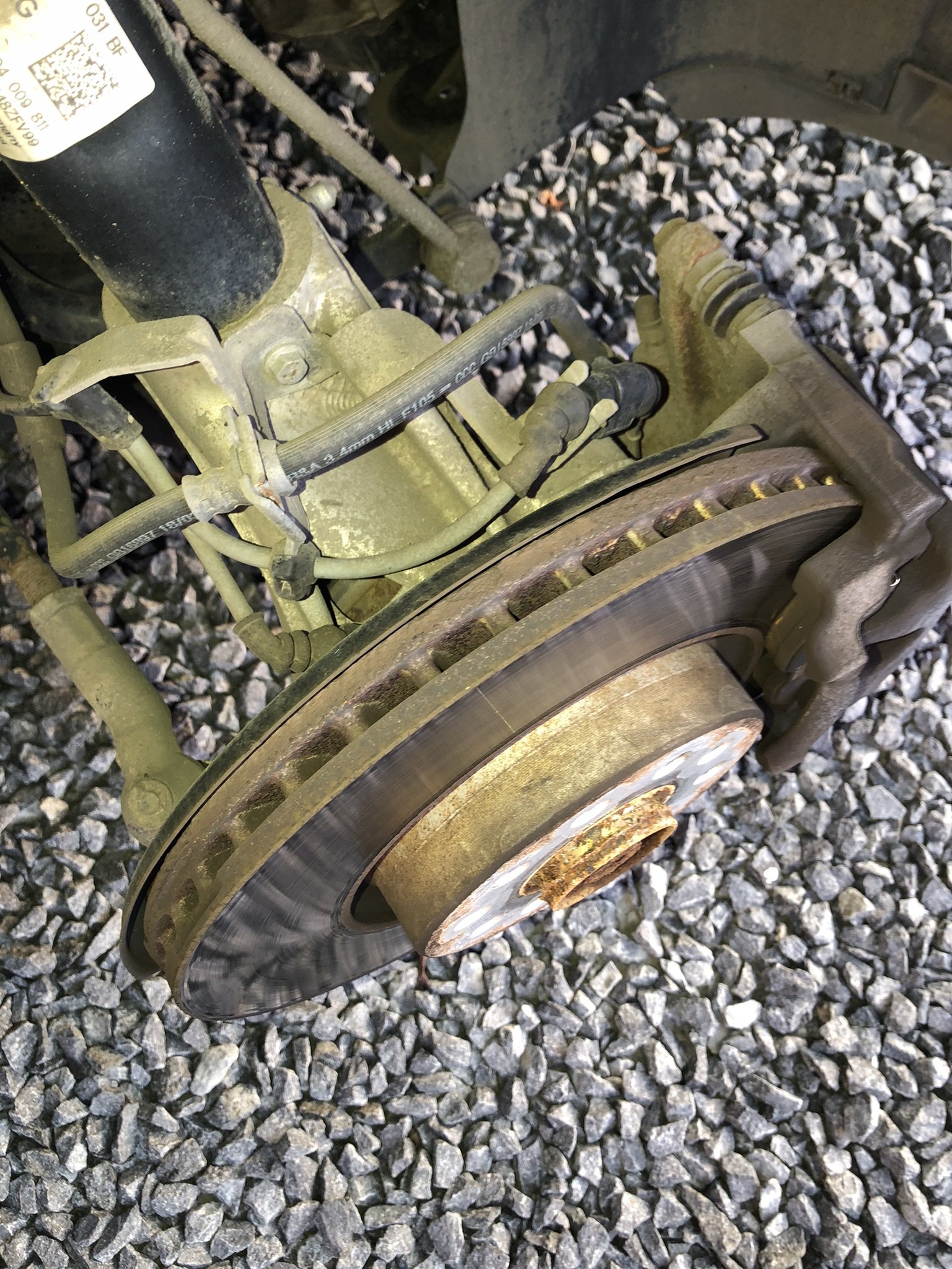

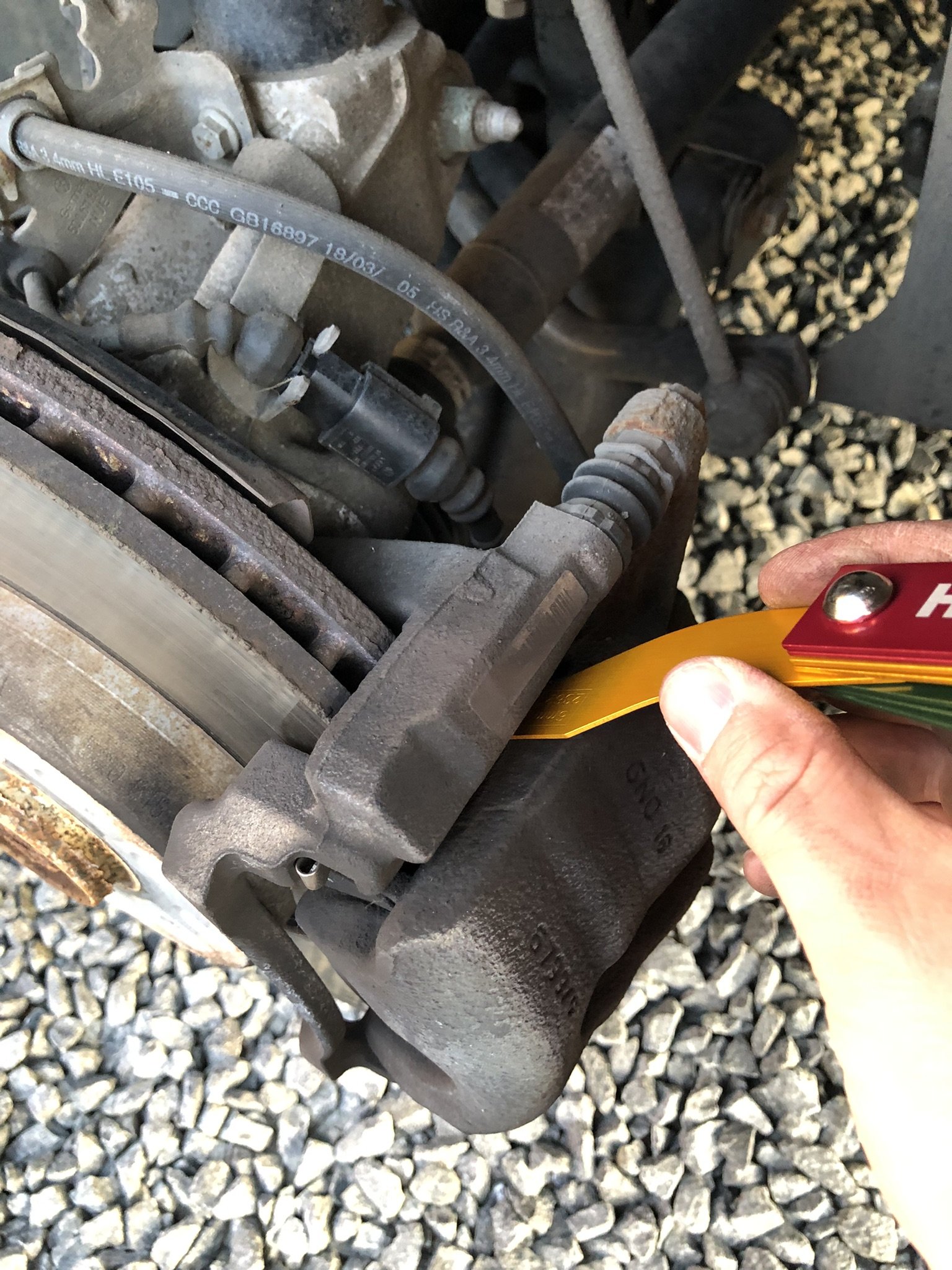

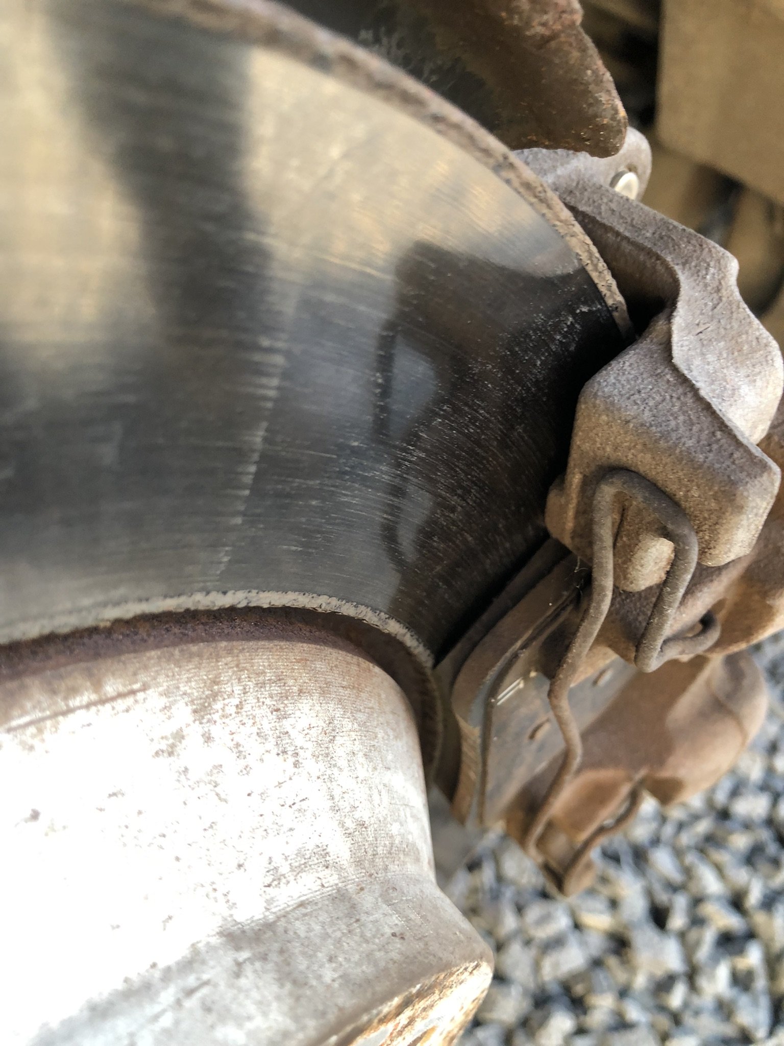

  4. Thanks all for the useful observations, apologies for the delay getting back to everyone but I had to procure some tools to be able to take the wheels off and measure the pads in order to make my own checks. The rear discs do appear to be about 25% worn, a rough measurement suggests 0.5mm wear on each side and the maximum appears to be 2mm each side (original thickness 14mm, minimum thickness 10mm). However, I was disappointed to find the rear pads look to have 6mm left: The front pads have roughly the same: I measured the front discs and they are original thickness 25mm, minimum 22mm, and wear is about 0.75-1mm each side, so about 60-70% thickness remaining, however I have no idea if the garage is correct in their assertion the front discs need to be replaced due to corrosion or not: I'm probably going to take the car asap for it's MOT which is due in four weeks to a local independent MOT Test only place and see whether they fail the discs, I don't personally think the pads need doing at this stage.
