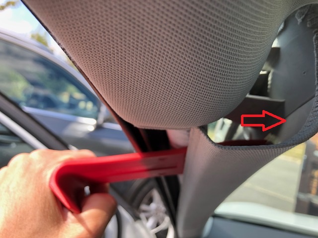

To remove the A-pillar trim panel, use a large and flat lever (a wooden spatula should be ok too ;) ). Insert it on the upper part between the door seal and the trim panel, so that you can push approximately the center part of the panel on the rear side to unclip it:
http://img114.xooimage.com/files/b/0/6/img_3359-57ad4c7.jpg

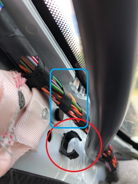

Once this is done, if you have a sun roof, start uncliping the water drain hose of the sunroof (red circle), to get a better access to the spreader rivet which fixes the park tickets retainer (both in blue rectangle):

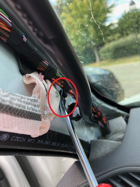

http://img113.xooimage.com/files/b/e/a/img_3361-57ad4e6.jpg
Then you just need to pull the spreader rivet head (if necessary, use a small fork ;)):
http://img114.xooimage.com/files/3/4/5/img_3362-57ad4e8.jpg

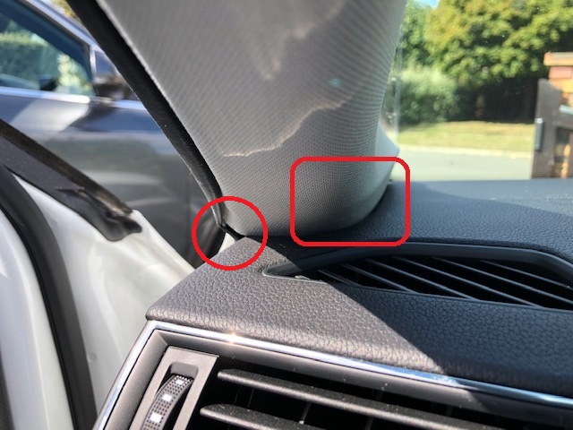

You can now start reinstalling the A-pillar trim panel. Be sure to engage correctly the lower outer corner in the door seal and the lower inner edge in the dashboard:
http://img111.xooimage.com/files/4/2/2/img_3364-57ad4eb.jpg

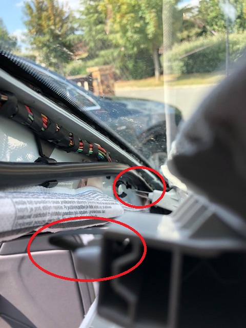

Then get out of the car and stand along the A-pillar and adjust the trim panel height, looking thru the windscreen:
http://img111.xooimage.com/files/1/3/b/img_3365-57ad4ed.jpg

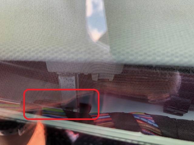

Check the lower clip is in front of the slot in the A-pillar. Do the same for the upper clip
Then just press firmly the trim panel, starting with the lower clip. If necessary, don't hesitate: A firm hit with your closed fist 😁!
Press the trim panel at the upper side to completely clip it.

Merci beaucoup! Did this tonight. Took 10 mins total using a OEM wooden spatula as you described. Right hand drive cars don't have the sunroof drain tube to worry about. A very fine blade screwdriver lifted the spreader rivet head out, carefully keeping a finger on it, making sure not to lose it down the adjacent vents on top of the dashboard. Hardest bit  for me was refitting the windscreen pillar cover without marking or damaging it. I found the best way,  was to use the spatula to force the rear edge of the cover into the slot nearest the door and its rubber door seal, then guide the leading edge into the slot nearest the windscreen, then finally shove it forcefully downwards. The new ticket holder is very tight now.
