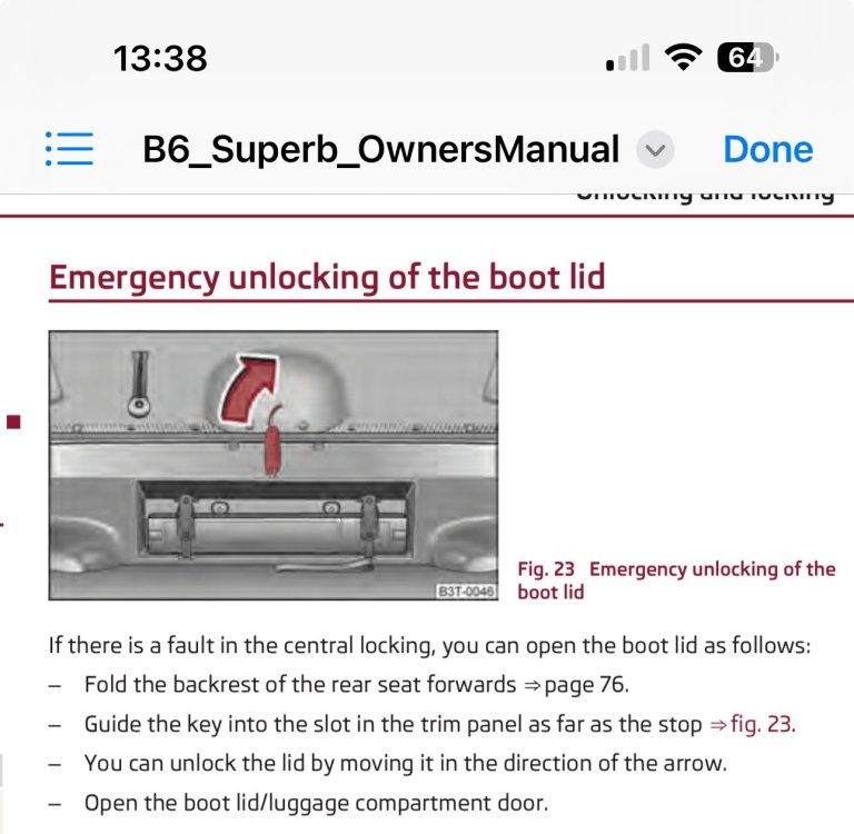

2 hours ago, Pixels said:
my question is how can I open the boot to attempt the repair as in the guide on the forum?
is there an emergency pull/lever?
There is (should be) an owners manual in your car, which describes (among many other things) also this procedure.
Advice: Read that manual and learn many functions of your car you did not know yet.
there is a fault in the central locking, you can open the boot lid as follows:
– Fold the backrest of the rear seat forwards ⇒ page 76.
– Guide the key into the slot in the trim panel as far as the stop ⇒ fig. 23.
– You can unlock the lid by moving it in the direction of the arrow.
– Open the boot lid/luggage compartment door.
Emergency unlocking of the boot lid

Just been out to the car… nowhere for my key to go there is no slot which is worrying 😞

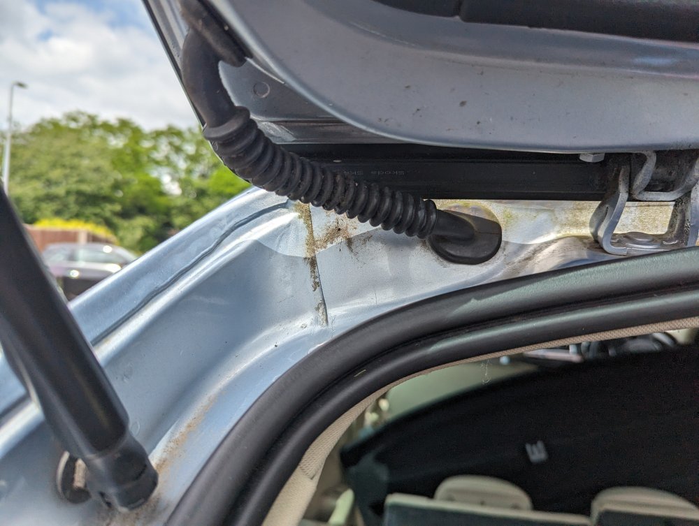

I have the same problem, boot wouldn't open and no near side reversing light.
I have read various forums and I believe it is a wiring issue.
I found by wiggling the corrugated flexible rubber tube that goes between the main body and the rear hatchback by the top left hinge, it all started working again!
I took this rubber off each end and slid it back but could not see any broken wires?

Have to drop the back seats and crawl in.
On the door just left of centre is a slot. Put a screwdriver in and slide upwards to release the catch. Left as you look at it from inside.
The slot is not easily visible. It's like a knife cut in the fabric liner.
Using a torch helps locate it. It's actually wider than the slit in the fabric.
I think it shows it in owner's handbook.

I peeled back the corrugated rubber tube but couldn't see any breaks, etc.
But the action of wiggling the wires made it work again.
Apparently the wiring loom connectors are just in the roof lining, so maybe it was dry connections that needed tweaking.

Drop back seats and climb into the boot. There is a small hole inline with the lock. Insert a screwdriver and flick upwards.
Just had mine repaired. There were breaks in 2 wires.
1 for boot release and 1 for reversing light.
The breaks in the wires were by the hinging system for the single boot lid opening. The brake lights still flashed when operating the hatchback release.

Emergency boot opening is detailed in the owners handbook.
So I had a Quick Look…
got into the boot via the back seats dead easy!

very strange.. I’ve had a go to on the second part of the boot.  Removed both bolts and now I’m trying to wiggle the black hook out of each side.. no luck yet 😞
Mine did the same. Obvious now, wires were making occasional contact.
To open hatchback, you need an extra pair of hands.
Person outside operates the hatchback release button, brake lights flashing, then open from inside.
Hatchback section locks itself after about 10 seconds, so not really enough time to do it by yourself.
Ahhhh I see…I did remove 2 metal pins the gas’s sections moves up a little bit but I still can’t get the black hooks out 😞
