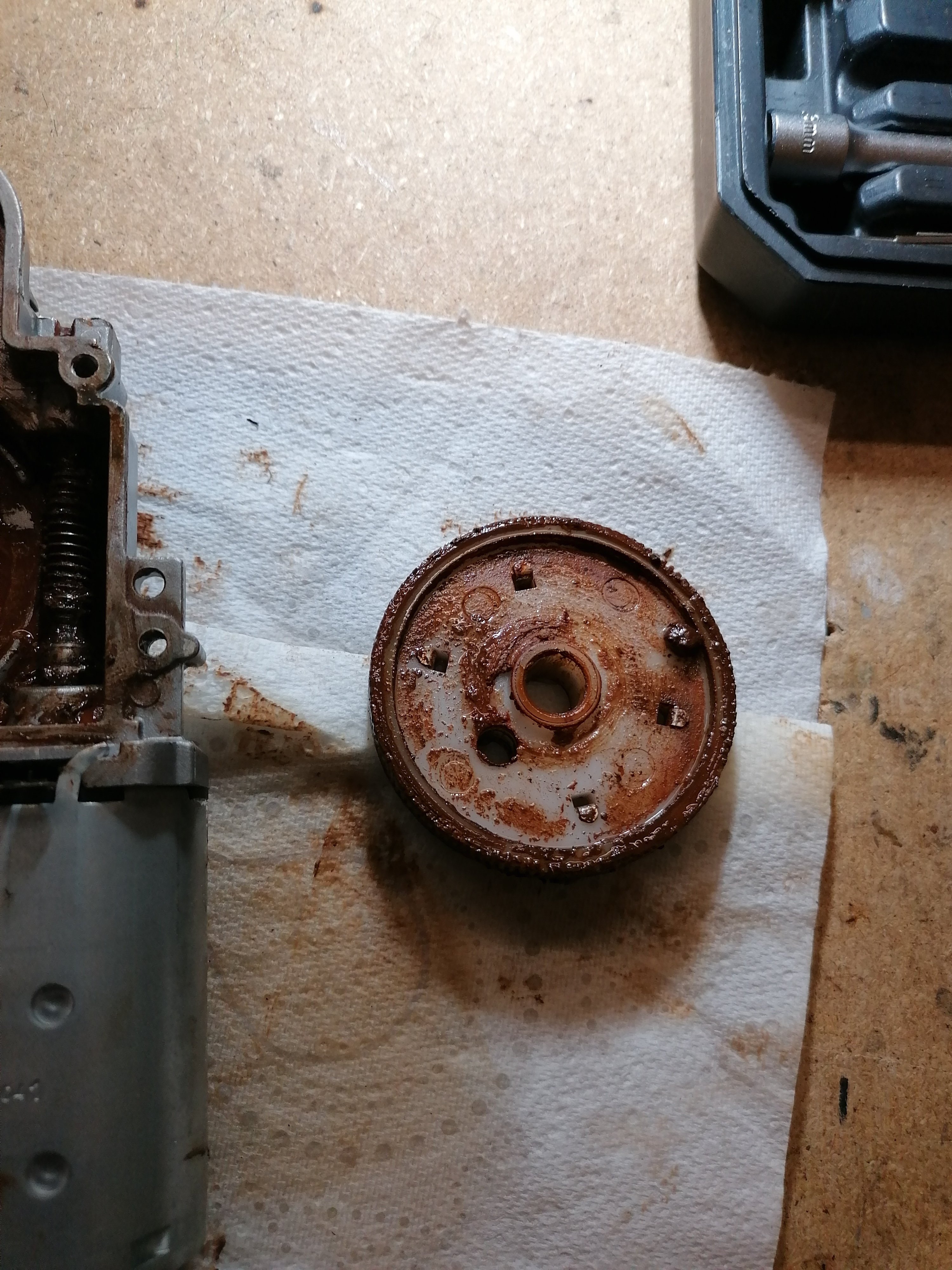

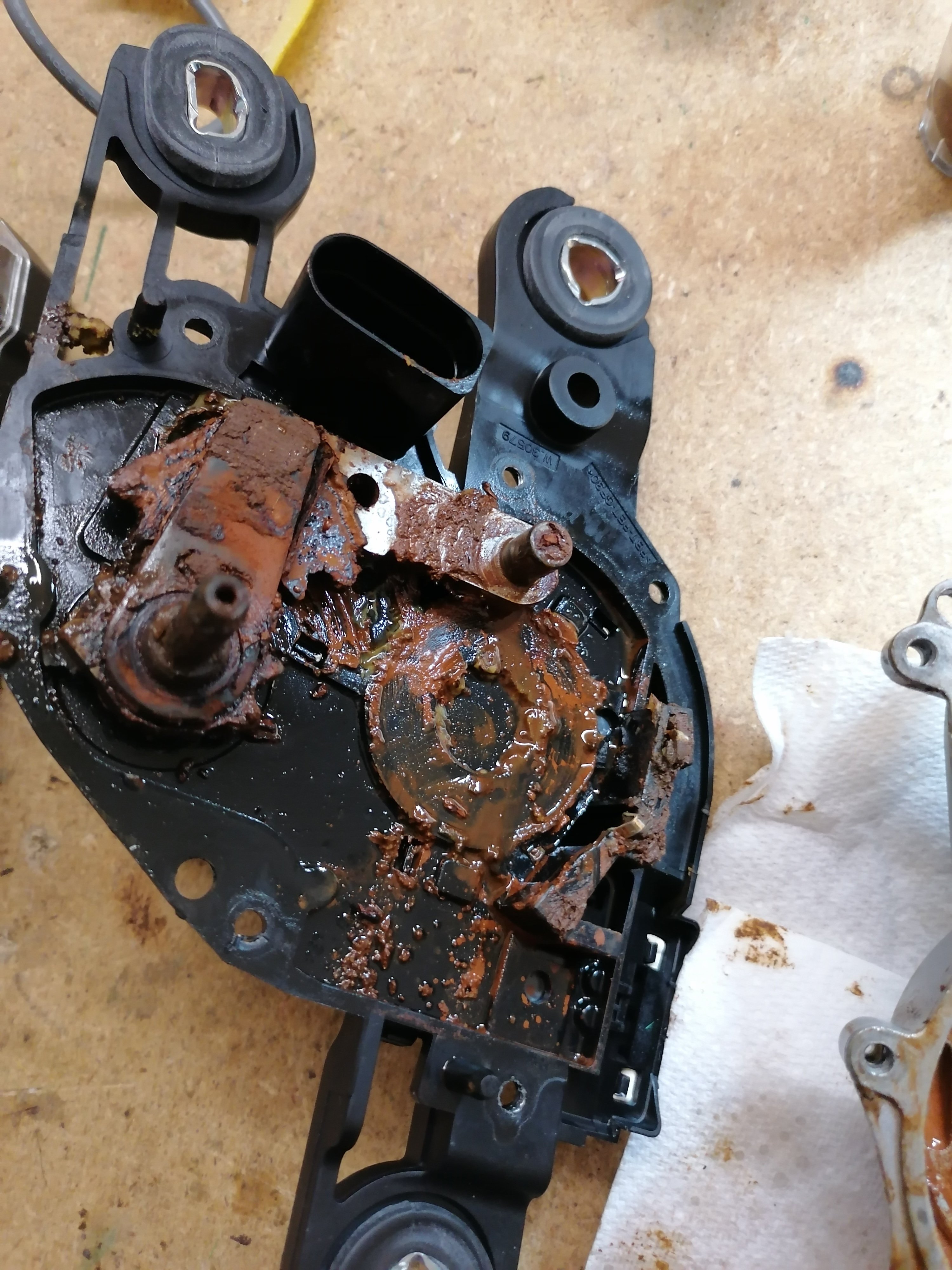

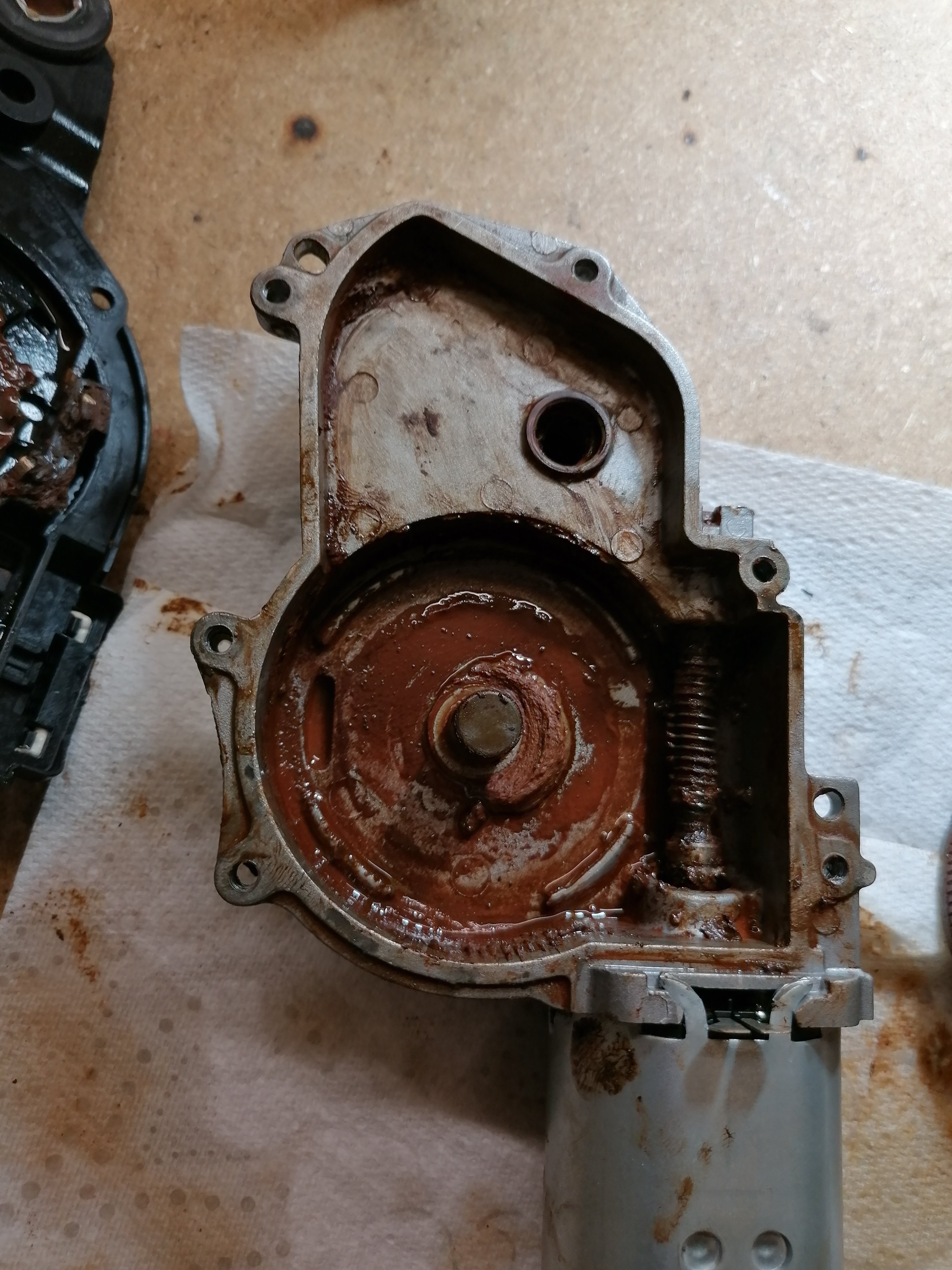

  3. After I thought i'd fixed mine , it lasted about three days before it stuck again so off with the motor again cleaned it up and it only lasted half a sweep of the screen. I'm going to get one off e bay, I did this for my mk2 vrs and that one was still working when I sold the car two years later. At least I know how to change it.
  4. The only grease I had to hand was copper slip, maybe not the best thing to use but it works. A friend of mine is a retired fitter but still does a couple of days at Wards in the Boro, he suggested petroleum jelly,aka, Vaseline, apparently all grease has water in it and breaks down eventually whereas Vaseline doesn't. If it moved, I greased it, the spindle was well seized but soon had it loosened with WD40, I also greased the worm gear. If you see me out and about in town, give me a blast on the horn,
  5. Mine was doing this then it eventually stopped working. I removed it and took off the plastic cover to find it full of rust and gunge. I cleaned it all up with WD40, freed the seized parts, regreased it and fitted it back on the car, works an absolute treat, took about an hour. There are vids on you tube on how to remove the motor and if I can do it then anyone can

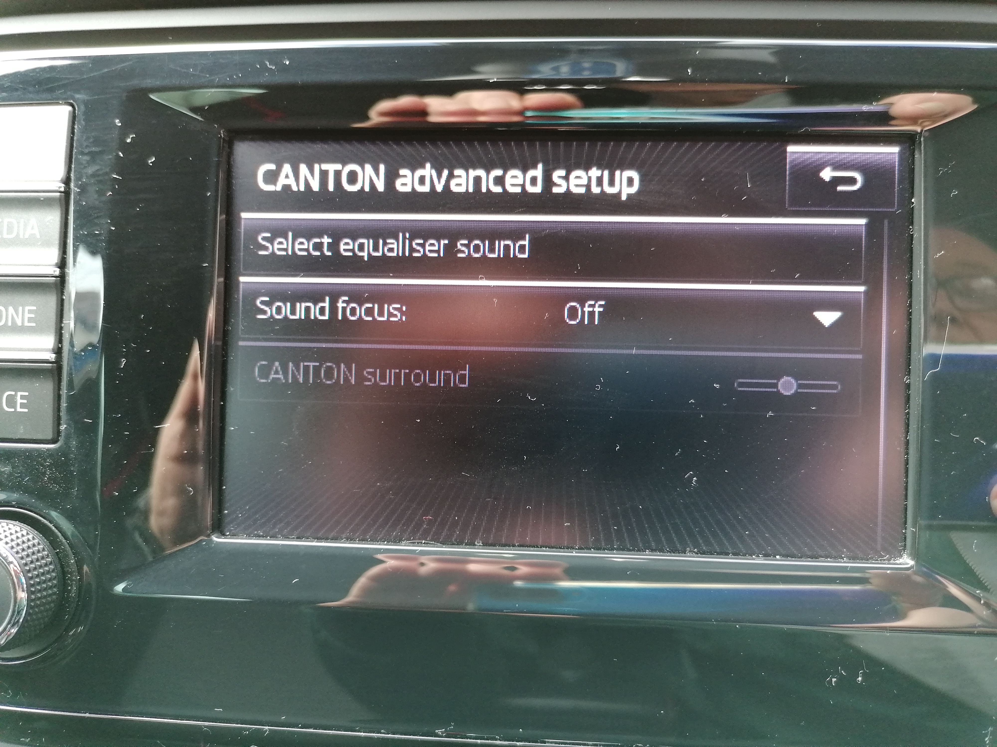

  6. I was checking the sound settings and came across this, Canton surround isn't highlighted and can't press it. I'm not a tech geek, but what does it do? and will it make any difference to the sound, Thanks in advance.

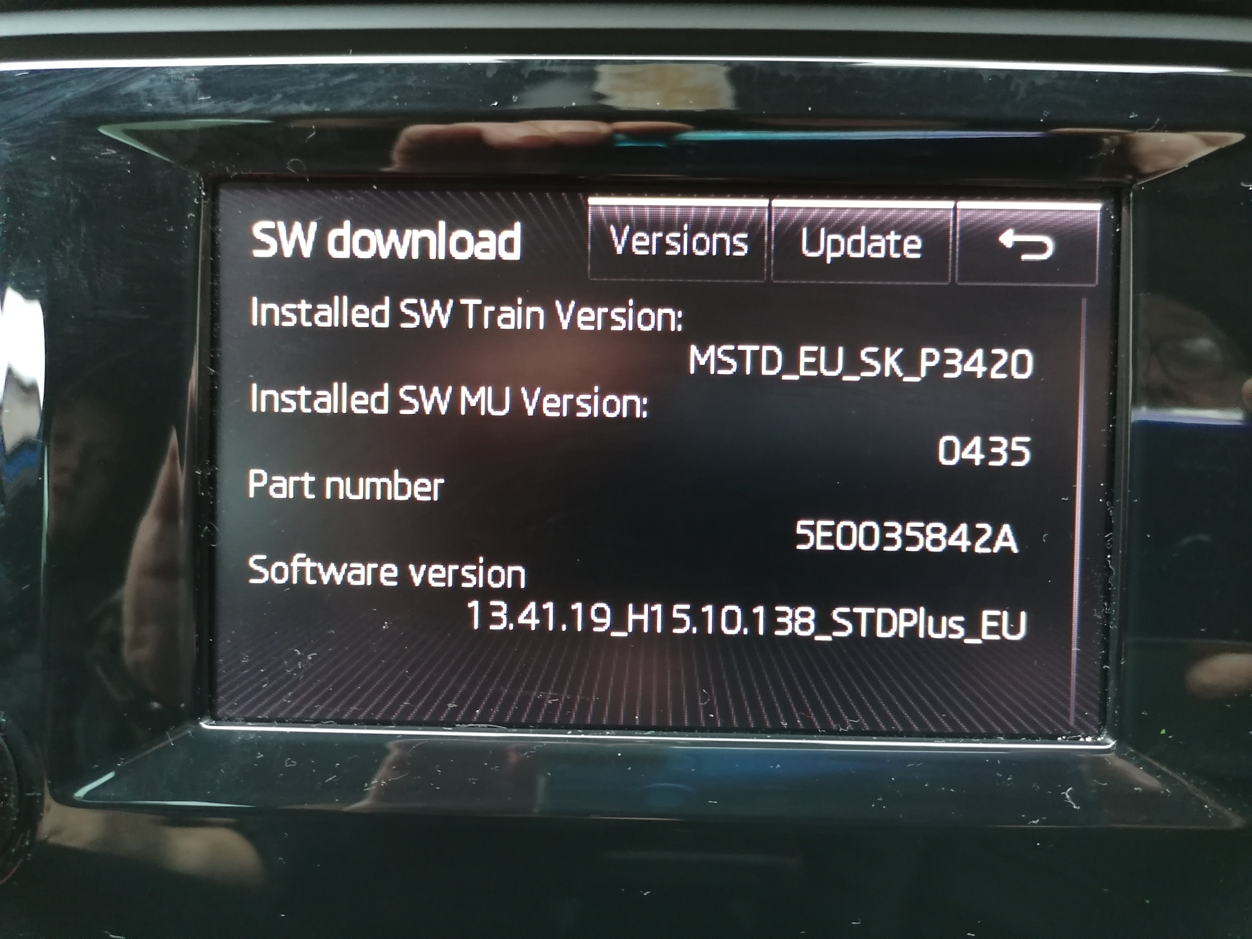

  14. I think i've got the right screen,
  15. Thanks for your reply varoom, i've just spotted the other thread on this problem, so it's not just mine. It does it for the first 200/300 yards then it works fine. I'll have to try an update.
