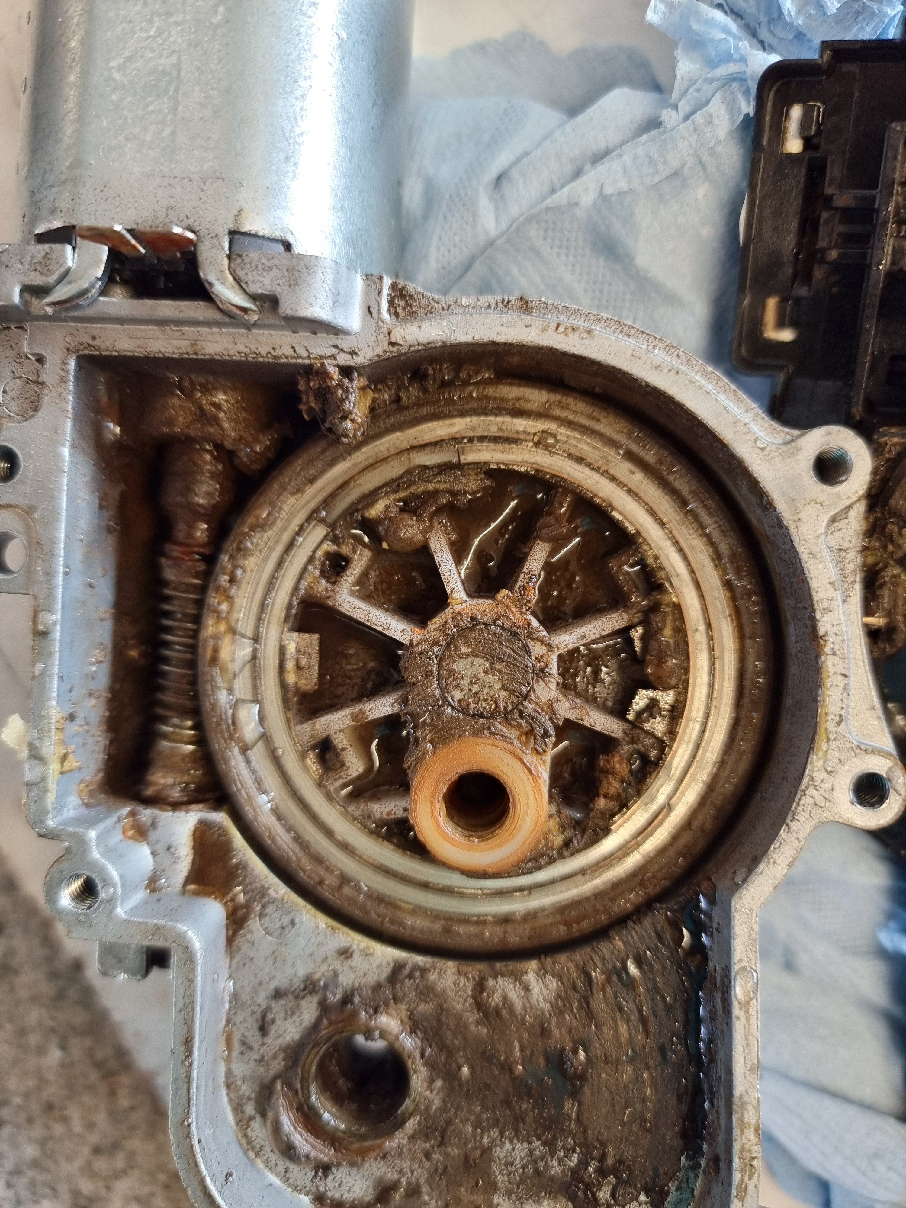

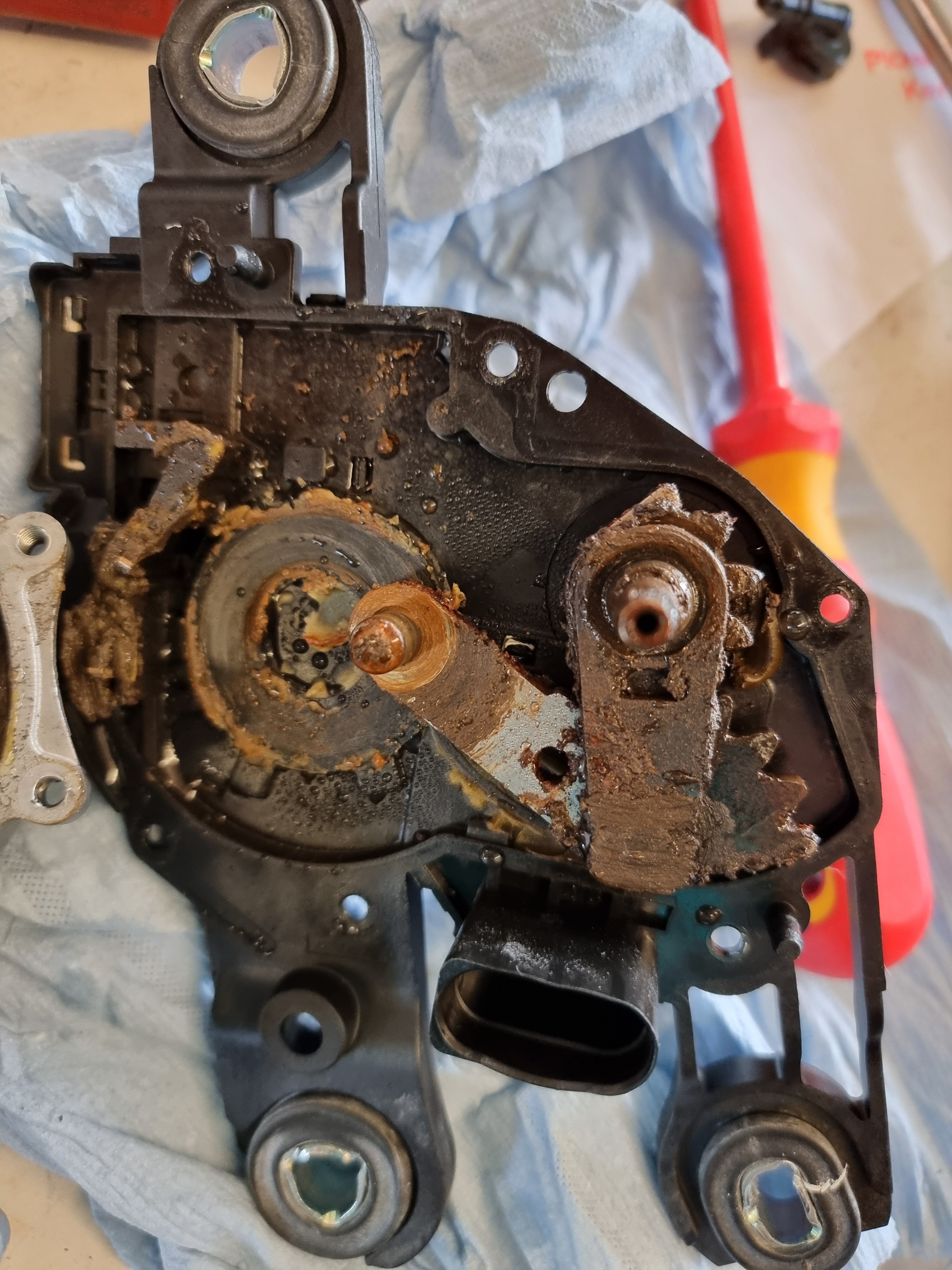

Mine was doing this then it eventually stopped working.
I removed it and took off the plastic cover to find it full of rust and gunge.
I cleaned it all up with WD40, freed the seized parts, regreased it and fitted it back on the car, works an absolute treat, took about an hour.
There are vids on you tube on how to remove the motor and if I can do it then anyone can

Yeah, that's what the issue will be - the washer fluid is coming out with a slight rust tinge to it. I've seen the same thing on Audi's in particular - its why so many of them drive around with the rear wiper pointing to twelve o'clock. It seems a bit of a naff design.

I might look at refurbing it myself then, out of interest what did you use for re-greasing it and whereabouts? I'm guessing white grease or similar around the spindle and on the 'rotor'?
Cheers
The only grease I had to hand was copper slip, maybe not the best thing to use but it works.
A friend of mine is a retired fitter but still does a couple of days at Wards in the Boro, he suggested petroleum jelly,aka, Vaseline, apparently all grease has water in it and breaks down eventually whereas Vaseline doesn't.
If it moved, I greased it, the spindle was well seized but soon had it loosened with WD40, I also greased the worm gear.

Mines lasted quite a while, I gave it another clean out, as I had it off, better than before too!
Had more fluid in there, I think some was washer fluid, so I sealed the shaft in from the inside as well, with some silicone.
I also have some nice silicone super lube now, so spammed it up with that all inside.
