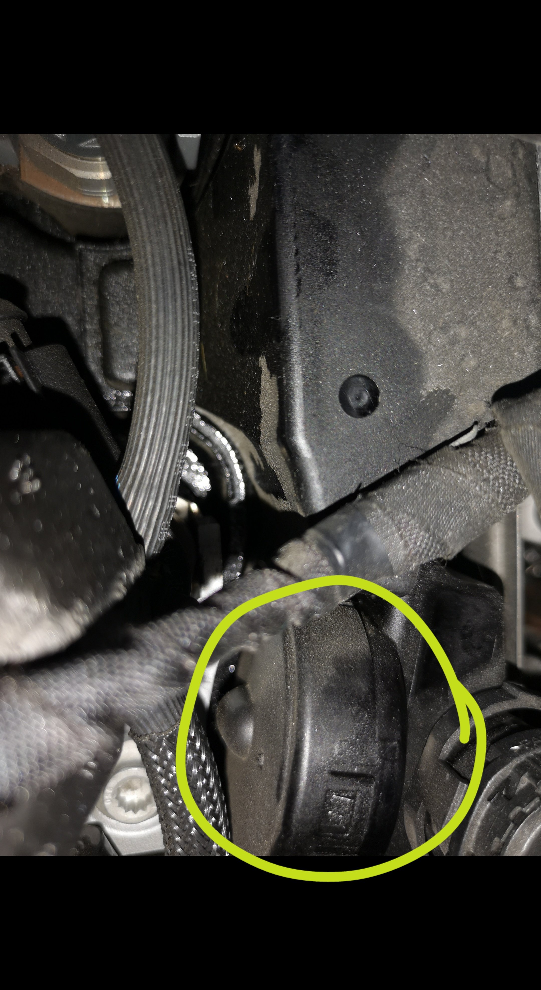

  5. Hi, My car has had high oil consumption for sometime. Never really looked in to it too much was consuming 1litre 1800miles now 1 litre every 700-1000 miles. I was looking for another problem on my car and i came across this which i am thinking is a pcv/ccv valve. Seems like theres oil all over the top of the engine where the fuel injectors are think this could be the cause of my high oil consumption. Anyone experienced similar also could somebody confirm this is a pcv/ccv valve if so whats the part number. My car is a octavia vrs 2014 2.0tdi engine code: cupa. Any help will be much appreciated thanks.
  6. Is this a pcv/ccv valve? Can see oil around it and all over top of engine near fuel injectors. Have had high oil consumption for a while.
  7. Hi, I have a 2014 skoda octavia mk3 5e vrs 2.0 tdi i am experiencing high oil consumption i have read this could be the reason due to it being stuck open/closed pcv valve. I have read some new cars don't have a pcv. Does anybody know if my car has a pcv?
