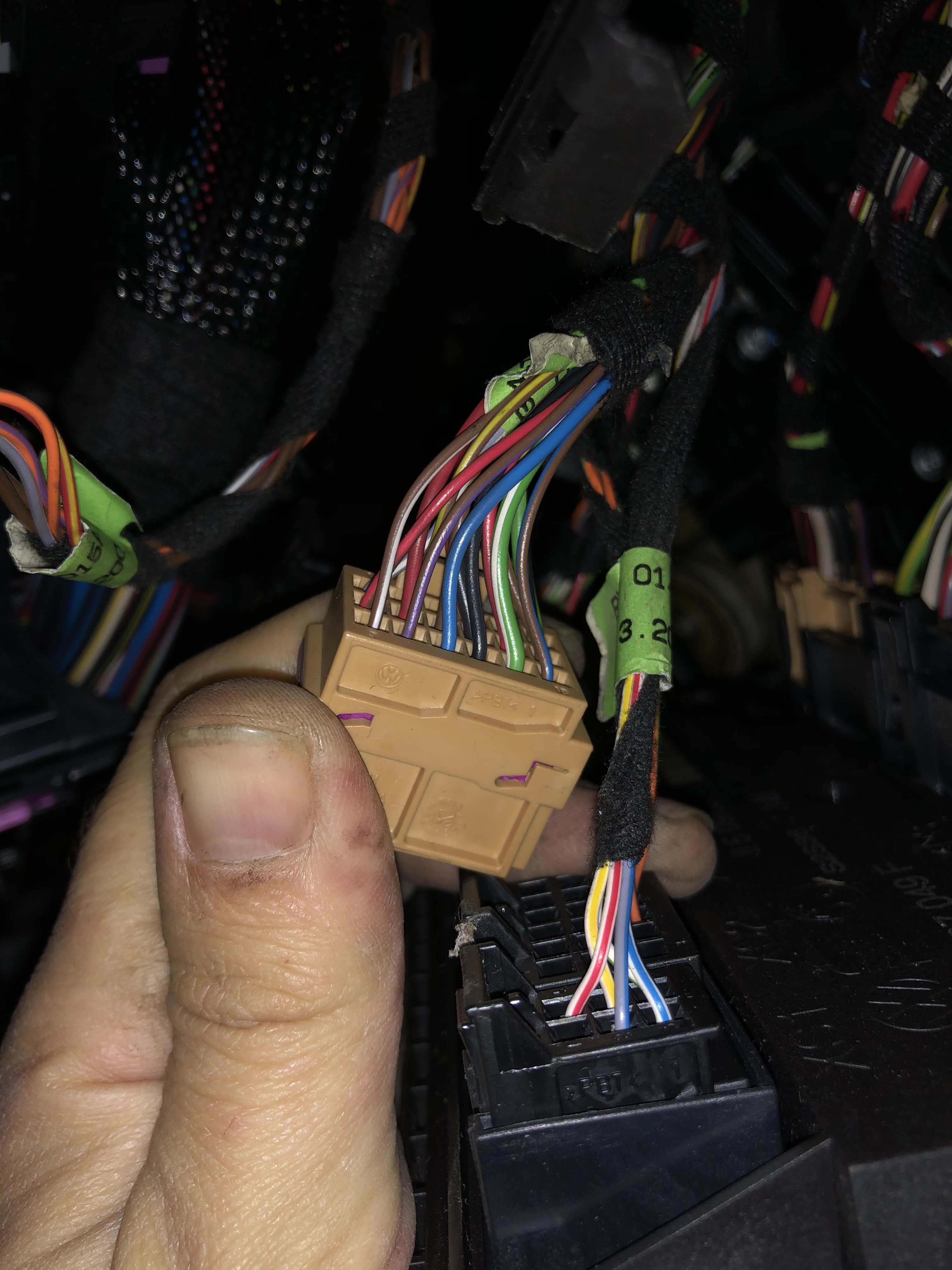

  1. Pulled the scuttle covers but all looked good as far as the loom goes in there. Ended up running a new cable from the plug under the dash to the alternator along the original loom route. All seems to be working as it should now, light comes on with ignition and goes out once started šŸ‘ Cheers for the help!
  2. Not getting anything when taking it to ground so don’t think it’s shorted anywhere but not getting any continuity if I go end to end on it either?? Showing 11.9v at the blue cable on rear of the brown plug above, but 8.2v at alternator socket. I’ve just ran a piece of cable straight from the blue wire on the brown plug to the alternator and the battery light is now coming on with the ignition like it should. I didn’t start it to see if it extinguished as the air box/maf and battery are still out of the car and it’s now gone dark. I’ll carry on with it tomorrow.
  3. Cheers for the help! I’ve had the battery tray and air box out and checked the wiring along the chassis leg up to the bulkhead but there’s nothing obvious wrong. Looks like it goes up into the scuttle rather than straight through the bulkhead. The car doesn’t have DRL’s. I’m just trying to figure out how to access the module above the pedals now. I’ve removed the polystyrene cover but looks like I might need to remove the lower part of the dash and move the module to allow for the plugs to be removed.

  6. With just ignition on, the brown with red tracer was showing 12v and blue just over 8v at the alternator plug. The blue was unchanged when running but brown/red was showing 13.8v after I gave it a blip of the throttle. I was getting the same figures at the other side of the plug near the starter and there was no resistance showing in the short run of loom between there and the alternator. Not sure how to check with alternator plugged in? This was with the alternator unplugged. The wiring looks good after taking the small black Flexi conduit of up to the point where it joins a larger loom under the battery. Looks like it runs along the chassis leg then but can’t see a lot with the battery and air box there.

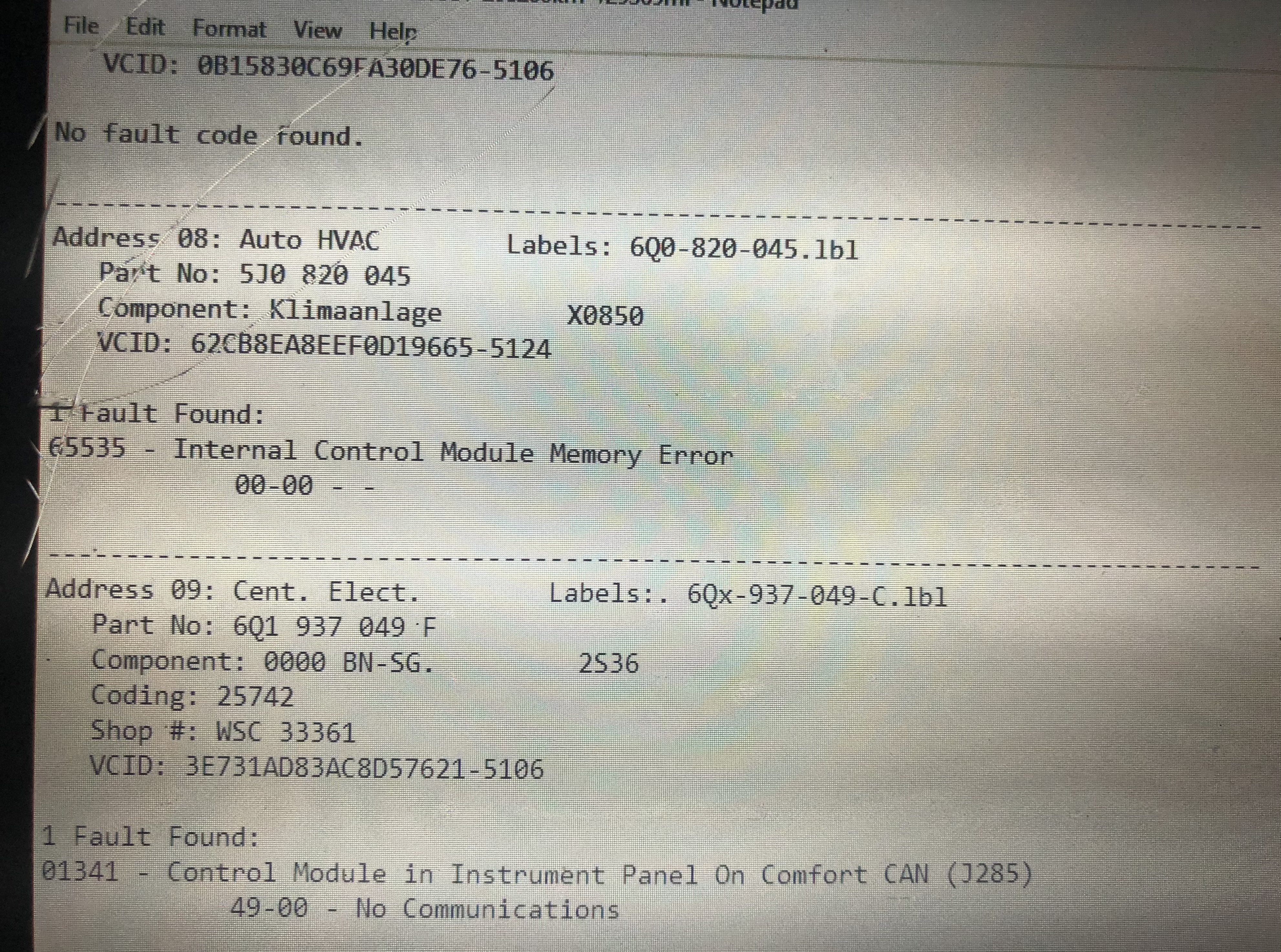

  8. The faults showing up in VCDS scan seem to relate to a faulty heater control panel but just wondering if signals are sent and communicate ā€˜through’ this panel?
