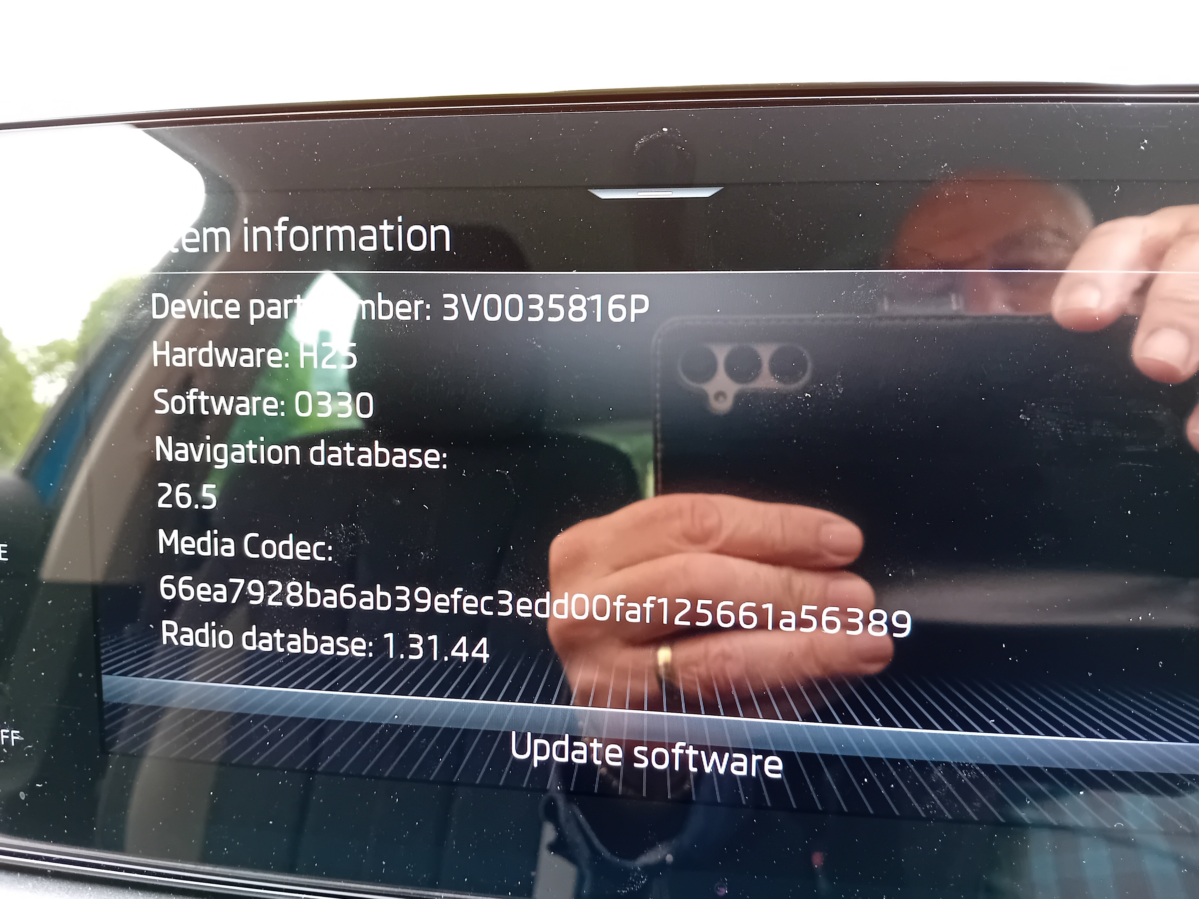

  6. On my Scala which has the MIB3 Amundsen it doesn't have a SD slot but does have USB-C sockets. For music I have a low profile USB-C memory stick with .mp3 music files on it. My understanding is that to update the maps (if you havent paid for the OTA map updates vie the eSIM) go to the Skoda update portal, enter your vin number and sownload the map for your car. I then copied this to another USB-C memory stick and the instructions say put this in a front USB-C socket and drive. No update option as it does it as you drive, it is suggested you check System Information for the Maps version number to see if it has completed. Others say you get a message to say it has updated - not seen that.

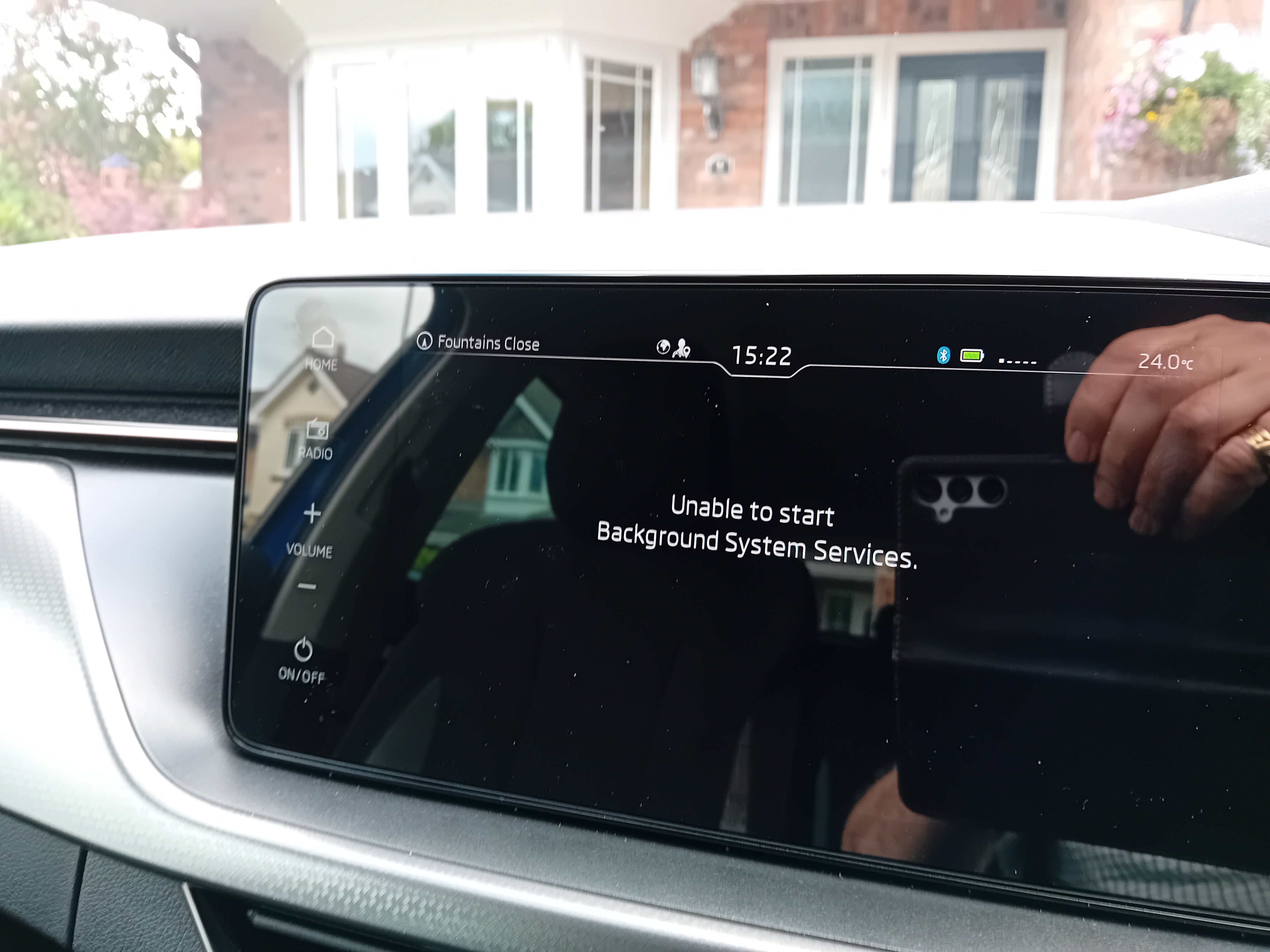

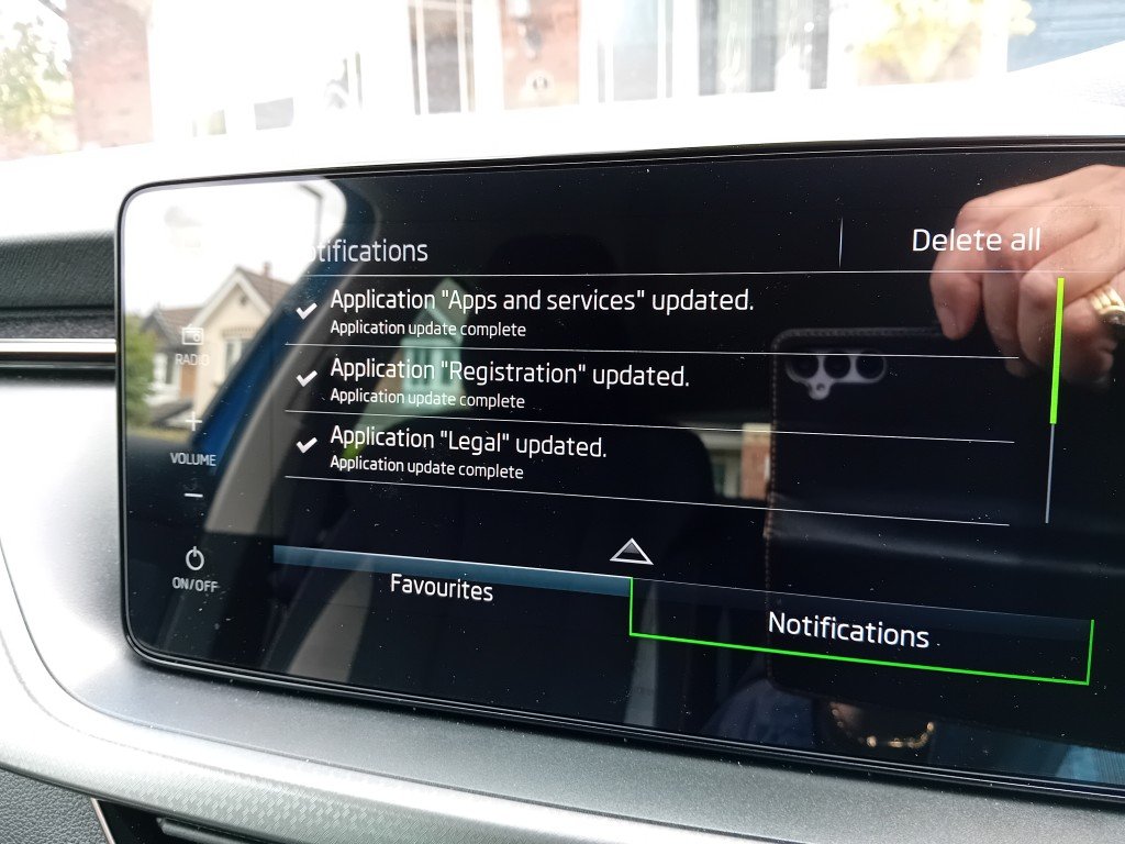

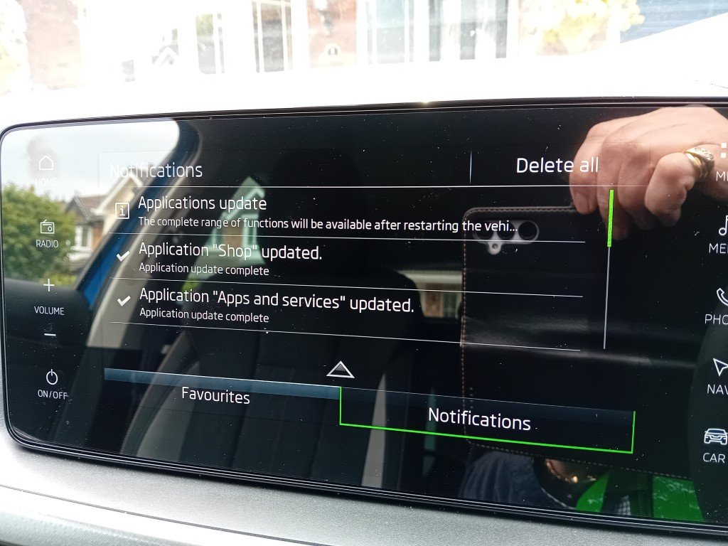

  13. It has to be in "P" if it is an automatic, no idea if manual. Maybe try with engine off and ignition on. I find when I stop the engine and touch somthing quickly on the screen ignition stays on. When getting in the car just press the start button without your foot on the brake.
  14. I have a subscription but don't think that makes a difference with OTA system updates. Difficult for me to say if the procedure will work for you, has your car got the built in satnav? If I get the update message and am on my way home, I leave it on the screen until I get home, park with auto in "P" and with the engine running click update now, then turn the car off exit and lock. Some of these updates look like they would update when you are driving and some only when you are parked up. When you get the update message you can also pull down notifications to see about the update. If you get a prompt for more info you can only look at the extra information about the update when you are parked. The next time you start the car, wait a couple of minutes and look at notifications to see if the update has worked. Yesteday it wanted to do another 7 updates, the biggest seemed to take several hours when I was parked and then today with another 2! I also got a message yesterday saying "Unable to start background system services" and the infotainment screen stayed blank while the big update was running!! Just come off the phone to Skoda Chester who were not much help but if it carries on after the weekend send them some photos of what is happening. Good Luck.
