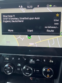

  6. Hi Although I've no trouble with my Navigation and how it worrks here's a shot of a random street near where I live showing that according to Skoda(VAG), Germany won the war as England is now in Deutschland!
