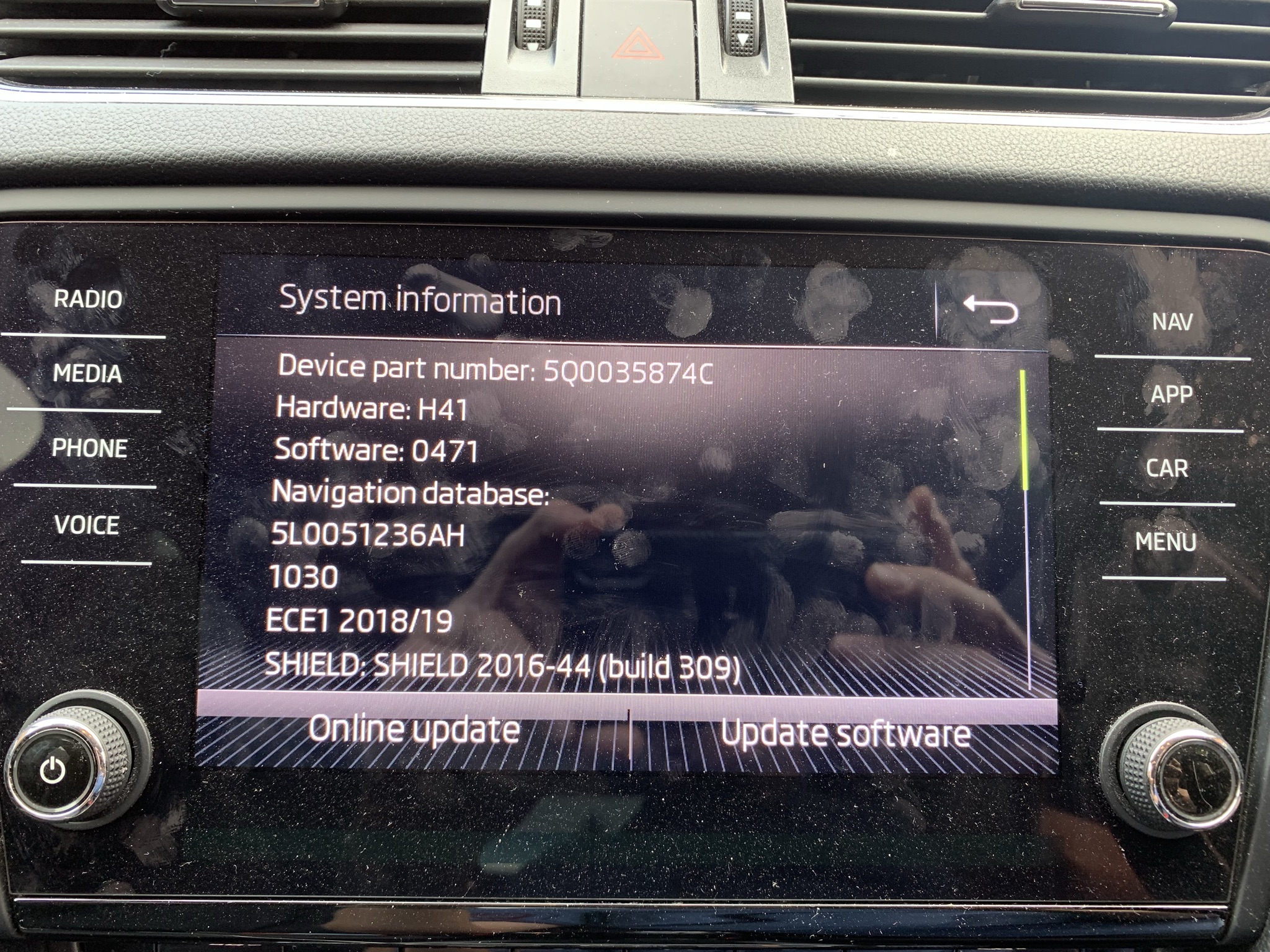

  2. not sure what i'm doing wrong, trying to update the software on my H41, using a sd card formatted as exFAT and tried ms-dos (i have a mac so not sure if that is part of my problem) i have the correct file from pab567 MST2_EU_SK_ZR_P0478T, press an hold menu, launches the software update, it recognises the sd card, press update but then say unable to read file, ignition is on, can't think what else to try? thanks for any help
  3. thanks, i tried resetting my personalisation, and removing from my phone. on my phone its doesn't even recognise the car is connected. so far this hasn't helped the software is 0471, hardware is H41 same style screen as this online update doesn't seem to work, but i probably need to go through the Wlan setup which i didn't have time
