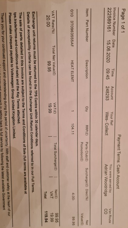

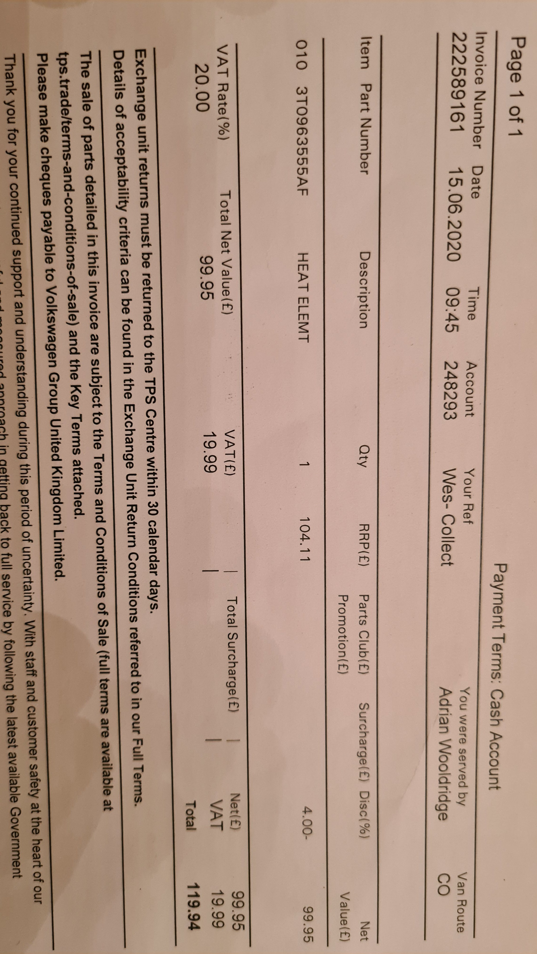

  1. Yes, seat needs to come out. Only 4 bolts and 1 multi plug.
  2. I changed my seat mat myself. No special tools required. Remove seat, work your way around the cover then with 2 pairs of plyers, open the upholstery clips. Fit new mat, and put back together. 1 hour for the base mat start to finish. But I agree. Takes a fair time to get hot.

  5. Just an update, after checking wiring thoroughly and measured voltages, fault found within drivers base heat mat. Replaced with genuine skoda part, all good. Easier job than I expected.
