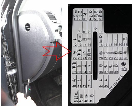

  6. Yeah I know it's mirrored, my board looks like the attached one, showing #41 (which is actually #44) as the wiper fuse when it's actually #18 (which is actually #15) . Very confusing! 🥴 My manual does however seem to show the correct numbers!
  7. The card on the back of the fuse box cover shows #41 as the rear wiper fuse and #18 as blank, however I've just fused #18 and now the camera turns on and off with ignition but the wiper is still stuck, so I'm assuming the problem lies with the rear wiper motor? Thanks for your help.
  8. #41, second from the right on the second row from the bottom.
