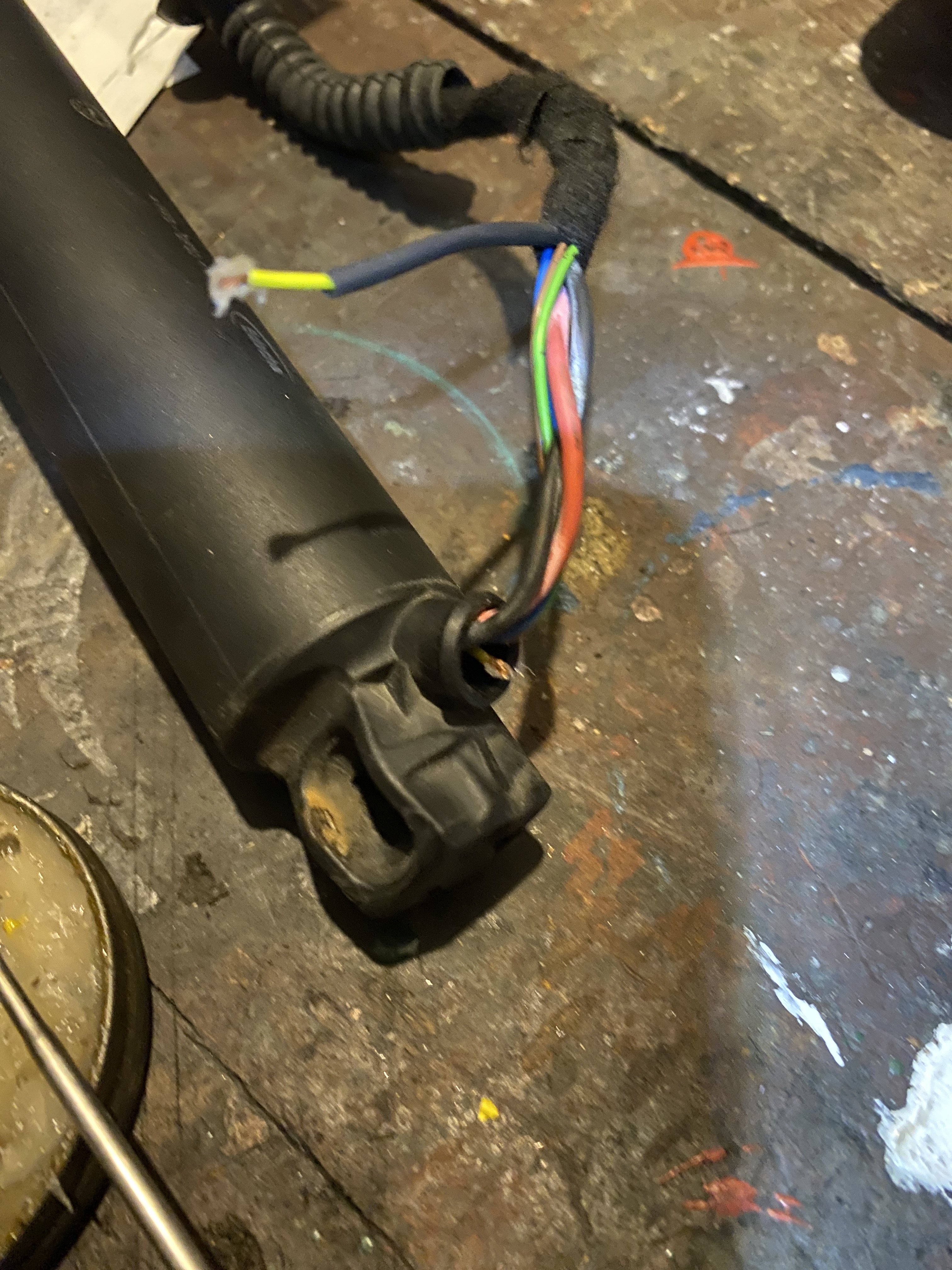

  3. Hello guys.Today I got same ereor with electrical trunk opening/closing only three beeps.I run a diagnostics and there was afault of Hall sensor on Strut nimber 2-right one.I decided firstly to check if rhe wire in the rubber hose is not broken and voila,cable was broken.I made a connection there,made isolation and everything is running well. So if you have the Hall sensor problem,not everytime it means strut to replace.
