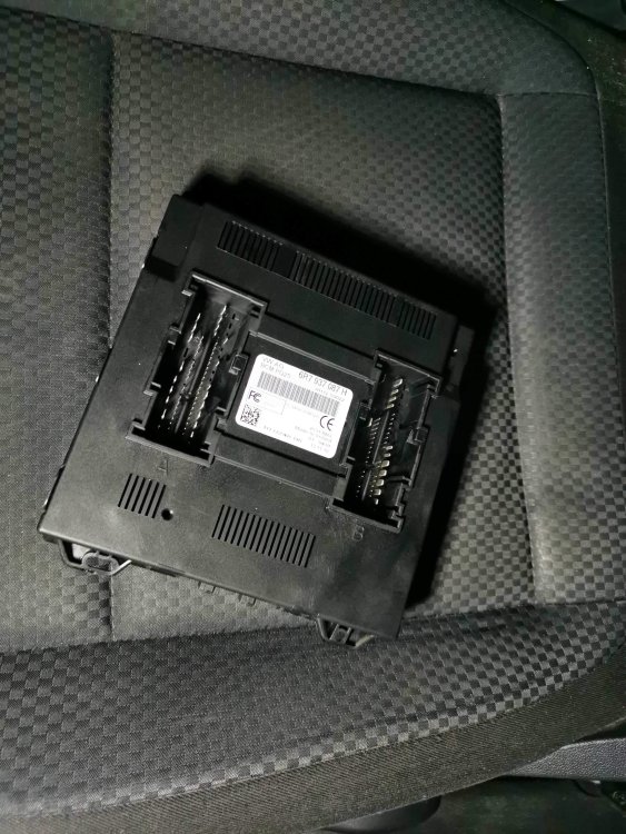

Update I now have a new unit, but have not had the time to test it. I need to program it first (among others the radio code is stored there?) Is it only possible with vcds or is there an cheaper option? I will have to rent regardless, but n vcds near me available. Mean while, I disconnect the battery and bring the Bcm with mee inside if I leave the car outside for a longer period of time. The bcm bord looked flawless under 10x microscope magnifying. I did resolder all pins 73a and 73b, and all relays... Same problem. This is a multilayered PCB, so I guess its a internal crack or bad connection between the layers. Any sugestions. I have all diagram for the car, but the actual relay is not presented. Only the connections going to and from it, j519 unit.

I have the same model, year, engine as you. Everything you are mentioning is related to the BCM PQ25, 6R7 937 087 H, located under the stearing wheel. Is it cold outside? You can read my thread 🙂

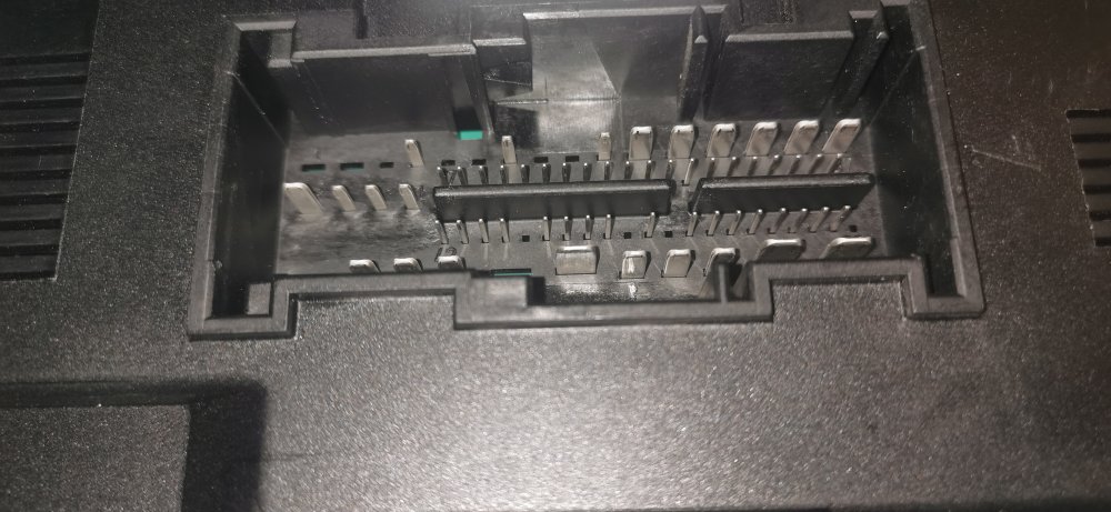

What are you interested in seeing Breezy_Pete? I can not attach any more pictures in this therad 😞 Can I pm you pictures? I only Saw a clean pcb with clean pins:-(

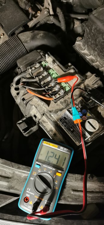

Have you checked the voltage of the battery while the car (and the alternator) is on?

Wow, what a great site 🙂 I have now bought one, waiting for it to arrive. And I also need to find someone that can Code it/copy my old. I can add that it's Not a fuse or relay issue for sure. My generator is also good, sits around 14.4 volt when driving... It 99% the BCM. For the first time since a bought the car, new codes have appeared regarding tvs diodes, 03301,03302,03303 and 03304. I know this will be sorted when a new revision is installed of the BCM (h version before week 2011 45)

Happy new year 🙂 Pictures, not the best, noticed my camera was not clean.. Was only able to add one..

Stay tuned, I will take new pictures when I release the BCM again. But not until next year, since I am not at home currently 🙂 That photo was taken in a semidark garage and fast:-). Mayby I should use electronic cleaner before I mount it again 🙂 Visually it looked clean, no corrosion nor grease on the contacts 🙂 I am VERY comfortable when it comes to electronics... When I park the car next year (tomorrow) it won't be using it for a while.. So I am going to disconnect the battery and remove the BCM again (and the radio since I might have broken the front PCB yesterday...) While BCM is of the car, I will clean it, and disassemble it (have to drill in the plastic housing on some points I guess??) saw no screws, and something else than the side clips is holding it together. I will use a microscope to check all suspected points.. Any advice before I proceed? 🙂

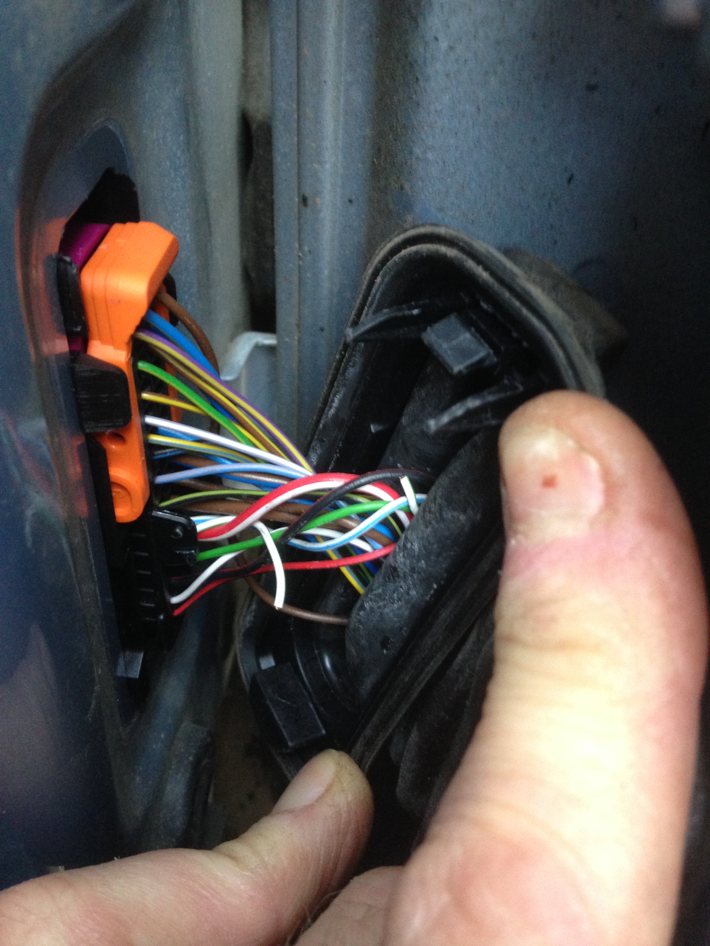

😞, good idea, I will try checking it next month, although I purchased the car 2020-Januari, from a private person (only owner). On the way home I noticed that no WINDOWS could be opened, the side mirrors could not be adjusted, no heated mirrors, I called him and he probably lied and said he had not noticed. Saw at least one complete broken cable, and several on their way. I bought a completely new lhd door loom and fitted it in Feb 2020. Everything startted to work after that. More ideas please:-) Sidenote: I now accedently destroyed my Radio (all three fuses checked, one in radio and two under steering wheel) it's completely dead, but I can communicate with it thru "Obd" reader. I will just buy a new one of the car ever get sported.

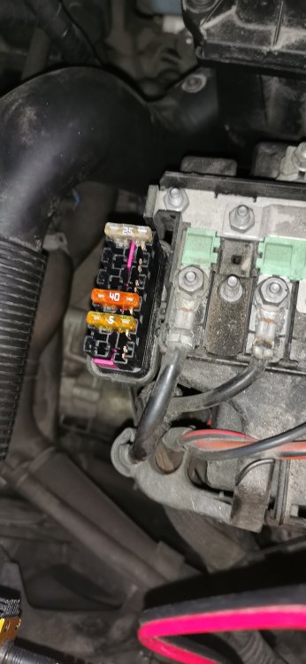

Hi and tanks for joining in:-) Yes, there are 3 standard fuses. All three are good, specially the 5 amp one, since I tested it with 4 amp load and it was all good 🙂

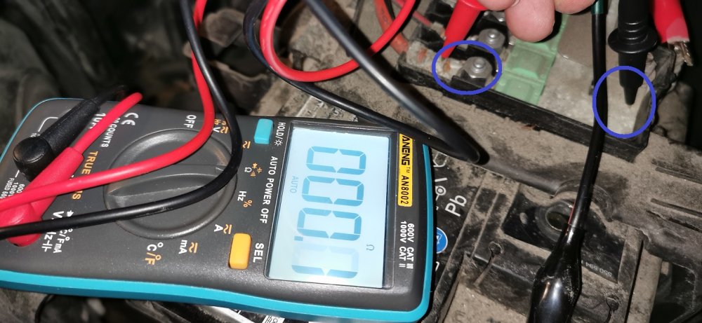

I have now measured Continuity, at all 6 Fuses, (one did not have a cable), all showd 0.1 (measurement error from my multimeter, it never show zero). I opened the door (remote)....(no heat) and after few seconds, disco light, the light in the roof started to blink (NO key in ignition), and i could hear som relay clicking. Tested to touch every relay i could see, but none felt "clickin". I also laid my hand on the BCM, and no klicking there that could be felt. I could hear the ????? fuel pump???, prime, in the same frequency as ONE off the clicking noice...ended upp disconecting the EARTH lead on the battery, and left the car, What is next :=( VID_20221229_115012.mp4

Thank you for your advice. I also suspected a loose connection to the BCM. I started with the easy part, removed the earth terminal from the car, and then removed the BCM, by releasing two connectors, and after released the BCM, and it slided down. It looks really really clean, and no surprises there, since it's never parked outside in rain. At home I park it in a garage with ambient temperatur (now days its sub freezing, water would be ice. Hence heating as I do should result in melting of ice, and thus more water.... And at work I park in garage with 20C degrees, 68Fahrenheit. Never seen a dropp of water under my feet. Can add some information. This have been ongoing since September, every day its is cold outside. So I did not use the car for over 2 months. The car was parked and not touched for more than to months in heated garage, October, November, and I got it again mid of December. The car did behave as normal,(opened with remote, I was surprised since I thaugt the battery would be dead after 2 months) the car started easy, and no faults. I parked in garage at home, ambient temperatur, next day it would not open with remote (as september) , and all errors back. And every time I leave it for more than an hour or so, in cold weather, the problem is there. Next to test is to see if the plus battery terminal is clean as per your suggestion, and also measure continuity of the (big) fuses on the battery. The 5amp fuse looked fine, tested previously. More ideas would be nice, like mounting a diesel heater in the car compartment haha... Edit: mounted back everything this morning, and now after 2 hours, the problem is back ( I was hoping that removing and reconnect would mayby solve something :-() Heated for 3 minutes, locally under bay, and voila.. Damn it.

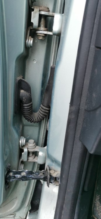

It's Either the micro switch in the door locking mechanism, or most likely the wiring loom going from the door in to the car body, check for broken wires. Image from BRISKODA.
