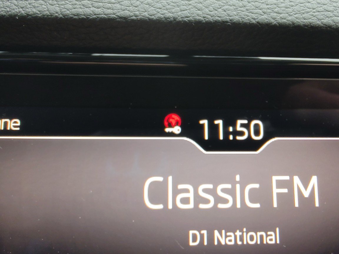

  2. Being a technical numpty, could any of you kind folk educate me as to the meaning of the red globe and white key symbol? I have looked in the manual but it may as well be written in Mandarin Chinese as far as I am concerned.

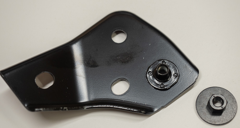

  4. Thank you Skomaz you hit the nail on the head. The part number stamped on the bracket confirms your suggestion. The odd thing is that I do have these rails, both of which are firmly fixed and work correctly. Perhaps they were left in the boot on a Friday night for fitting on the Monday morning and the fitter went sick

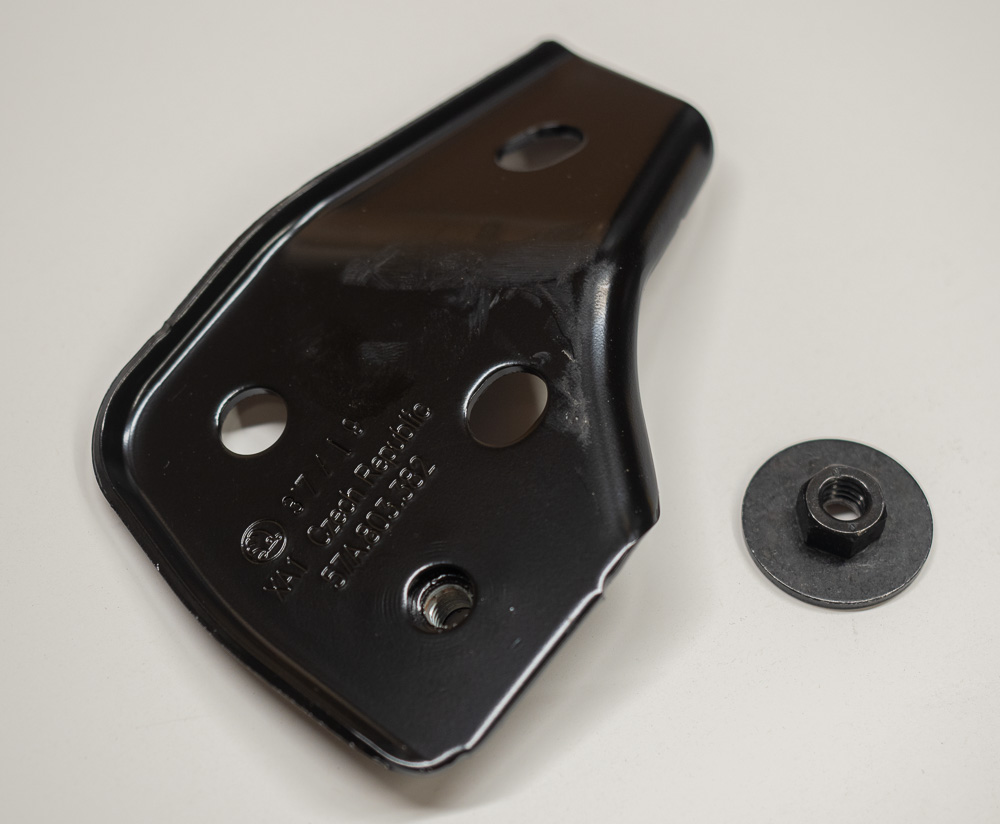

  5. A test for all you Karoq owners: What are these components? I found them loose in the spare wheel well when I took out the space saver to check the pressure.
  6. Thank you for your erudite comment.
