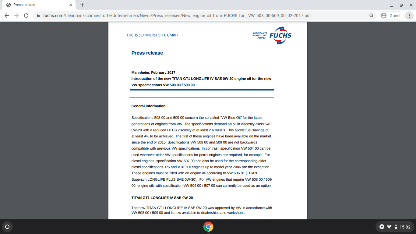

@CJJE So VW Group / Skoda have VW508 00 as the recommended oil for Variable / Flexible service intervals.
What are the recommending for 'Fixed Interval' servicing for those that do not want Long Life oil used, given that you can use Long Life for fixed or variable.

I've read somewhere that the DKZA engine requires VW508.00 oil, but can't track it down now. This is one of the changes from the earlier 2.0TSI engines, and is of course common across all VAG cars with that engine.

Did I read somewhere that the adoption of VW508.00 oil was prompted by emission control compliance?
Pre WLTP / RDE certification all in the factory got VW508 00 / 509 00.

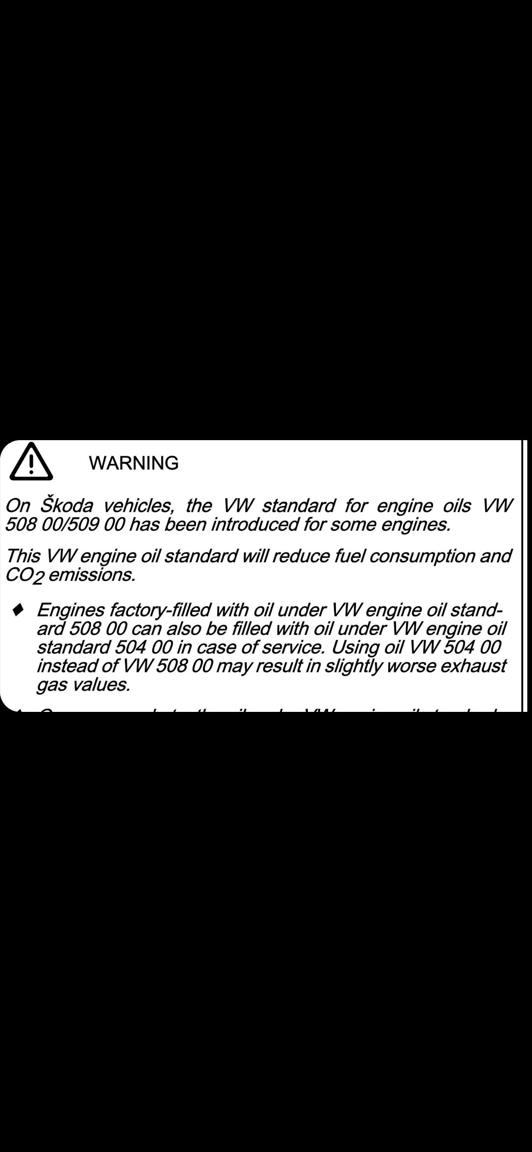

So if the VW508 00 is a must so be it.  But VW502 , 5w 40 FS can be used for Fixed Servicing.   Like using VW504 instead of VW508 the Emissions might be affected.
But then maybe your TSI will last more decades than with the Oil VW Recommend because of the viscosity.

They supplied an oil that can be used but not what was in the engine when delivered from the factory that was VW 508 00 / 509 00  so 0w 20 FS IV.

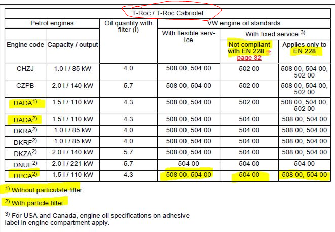

vw long life iii fe 0w30 for dada, dpca, dfya...

for all engines DADA or DPCA, you can also use 0w30-long life 3. see attached picture.
