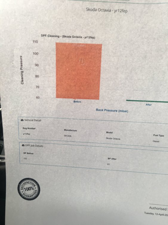

Hi, posted sometime ago about DPF issues. Searched the forum but cannot find the posts as it’s a couple of years ago. Having had the DPF cleaned, off the car which showed the pre and post back pressure values, still having issues with the car pushing out white smoke after sitting ticking over or when undertaking sudden acceleration from a lower speed. Plus it still has the problem of (appearing) to try and continually regenerate once it has got up to temperature. Until then there is no sign of any smoke, nor when driving along. It has also had, throttle body replaced, oxygen sensor replaced and EGR valve replaced. Think it is pretty obvious that the white smoke is due to the additional fuel being injected when trying to regenerate and then being blasted out when pulling away? Have got VCDS and there are no faults recorded, although before the DPF clean the DPF light would come on, otherwise none. Would like some advice from anybody well up on VCDS what live data I should be looking at to try and find out what’s going on or anybody in Kent, UK that might be prepared to give up a bit of time to assist? I would point out that it had the software ‘fix’ before I bought the car and have considered getting it remapped to regress to the original or as close to as could be to see if that made addition. Chopping out the DPF and mapping it out is not an option for me I would add. Skoda Octavia Estate 2.0 TDI CR CFHC engine.

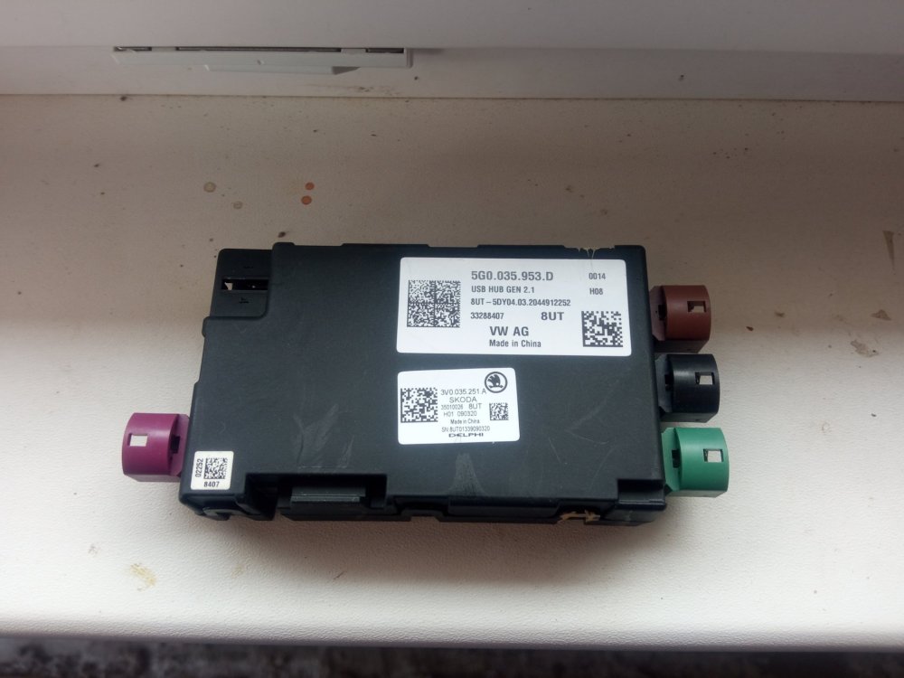

So, been having another root around to see what I can find about the USB set up. It seems that there is a "hub" connected to the infotainment system, Part Number: 5G0035953 (may come with various letters at the end, C, D, or X.) It appears to have a single input to the unit but with 3 inputs or 3 lines in through 1 input? If that is so then there are 2 additional inputs available. The part that fits in the centre console would appear to be: 5Q0035726 (again may come with various letters at the end, C, N, M and E, although the one ending in L appears to be a double one?) If you Google some of the part numbers they come up as Seat and visually look different. Not sure how you could wire them in for the minute as I cannot find a harness listed for them so may have to find a breakers where you could strip out the part of the loom you may require or get in touch with the local dealer and see what they can come up with? My thought is the plug on the unit end going to the USB sockets. As for the rear of the centre console there are 2 rear carriers listed and 4 inserts on zap7 so perhaps one of them along with one of the usb plugs is what I am looking for?
