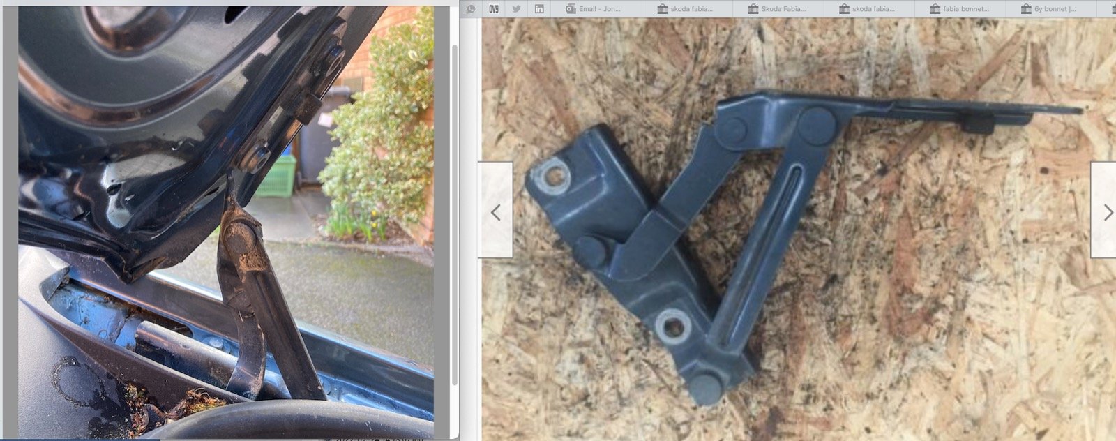

Update, if you're interested. I got the bonnet off thanks to the HatBoyHarvey video above - two T40 bolts each side. The hinges were also held on by two T40 bolts each. There is a round black grommet each side to get to one of them - the ones that are nearer the front of the car. For the rear ones there was limited space - on the driver's side I was able to get enough space for a tiny ratchet spanner by stopping the wipers in the vertical position to get the wiper arm out of the way. I marked round the hinges before removing to help realignment later. In the pic I have reattached the bolts where the hinges go, to avoid losing them.

Hi, So like an idiot I went out and forgot the bonnet wasn't latched. (I use a trickle charger on the car). Got up to about 50mph and the bonnet came up and smashed the windscreen. Luckily I was near home and stopped safely in a straight line whilst not being able to see where I was going. I've ordered a couple of hinges from eBay to replace the bent ones and am hoping the bonnet will sit flush (enough) on new hinges. Can anyone tell me the method to replace the hinges please? Thanks. Pic of left hand hinge in situ vs what they are supposed to look like 😞

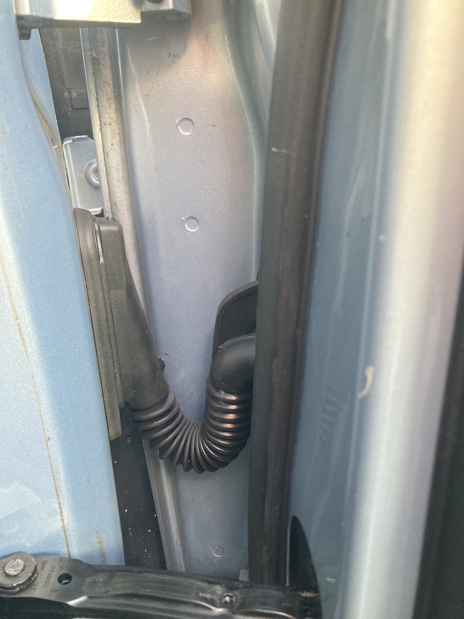

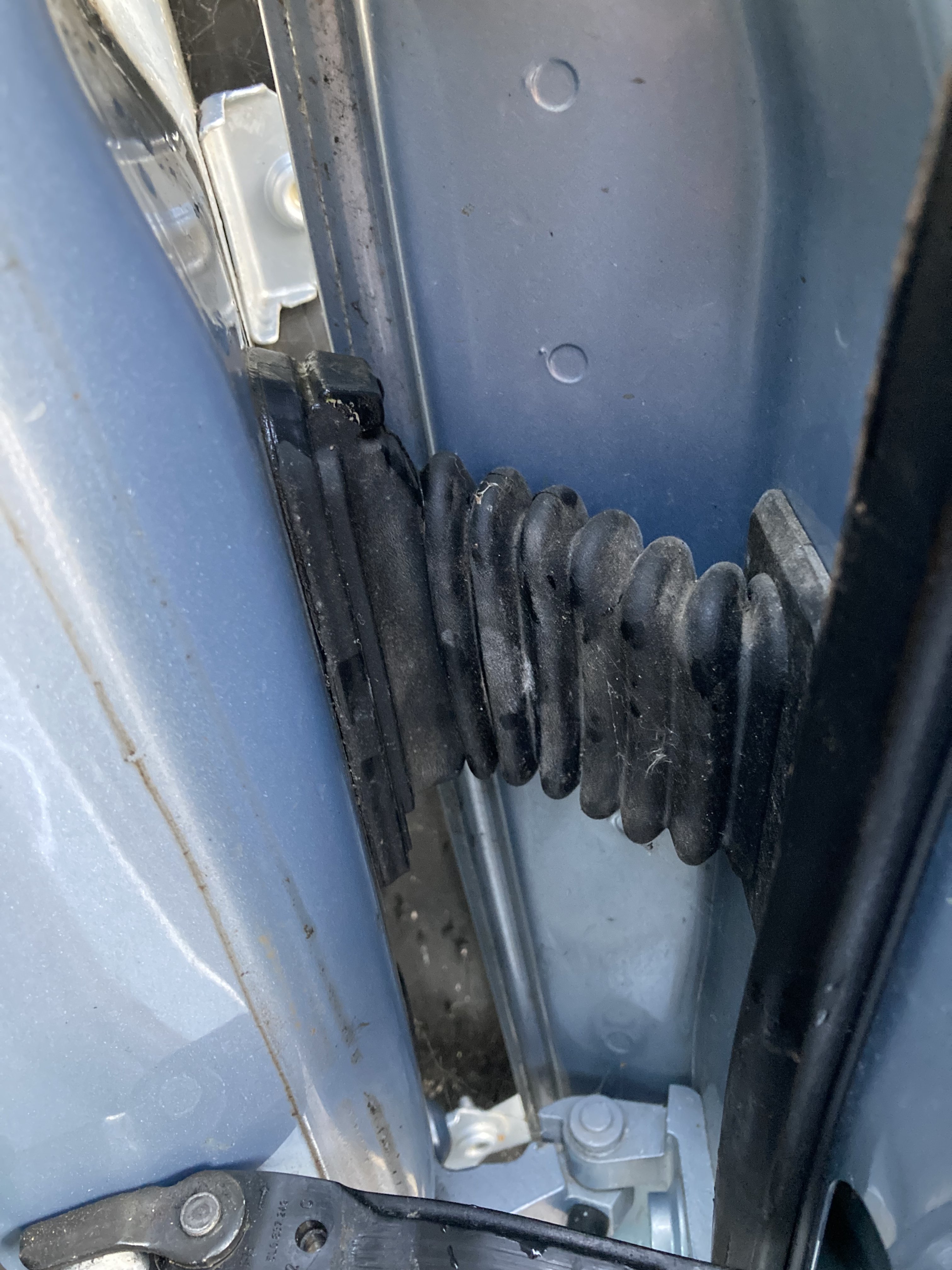

Update. I figured rather than mess around I'd get the loom changed. Got back in touch with the main dealer, got the part number - 5L0971120GA for my 2012 model - £130+VAT. Got a crazy labour quote. Rang my local garage, got a better labour quote, gave them the work. They also collected the car and returned it, and it coincided with my MOT being due which I'd get them to do anyway. (aside: MOT passed with just a note about the front brake pads being low - woo-hoo!). I asked to keep the removed loom. So here it is. - definitely knackered. - glad to see that the new one has the U-shaped boot.
Offside door locks and all windows stopped working
Thanks, yes, I’ve seen a picture of the later, U-shaped ones, from 2013 or so? i rang my local dealer for a quote but they didn’t get back to me. Will try again tomorrow to get the boot off. Thanks
Thank you J.R. Well well. I just spent 20 mins sat in the car on this cold day with the engine running trying, unsuccessfully, to get the Car Scanner app connected via a bluetooth dongle into the OBD port (aside - this combination works on my Fabia). Just as I was giving up and about to climb back out of the passenger seat your post above arrived. I tried again outside and to my surprise the key worked, operating the central locking as expected. Then the remote worked. Several times. Not that it's relevant now but we've had the car 7 years and one owner before that so I can sat with some confidence that keys/locks all original. So is it some dodgy connection in here somewhere, that doesn't like the cold? How do I get the rubber boot off - a screwdriver into the detent at the top on the car body side? Thanks, Jon

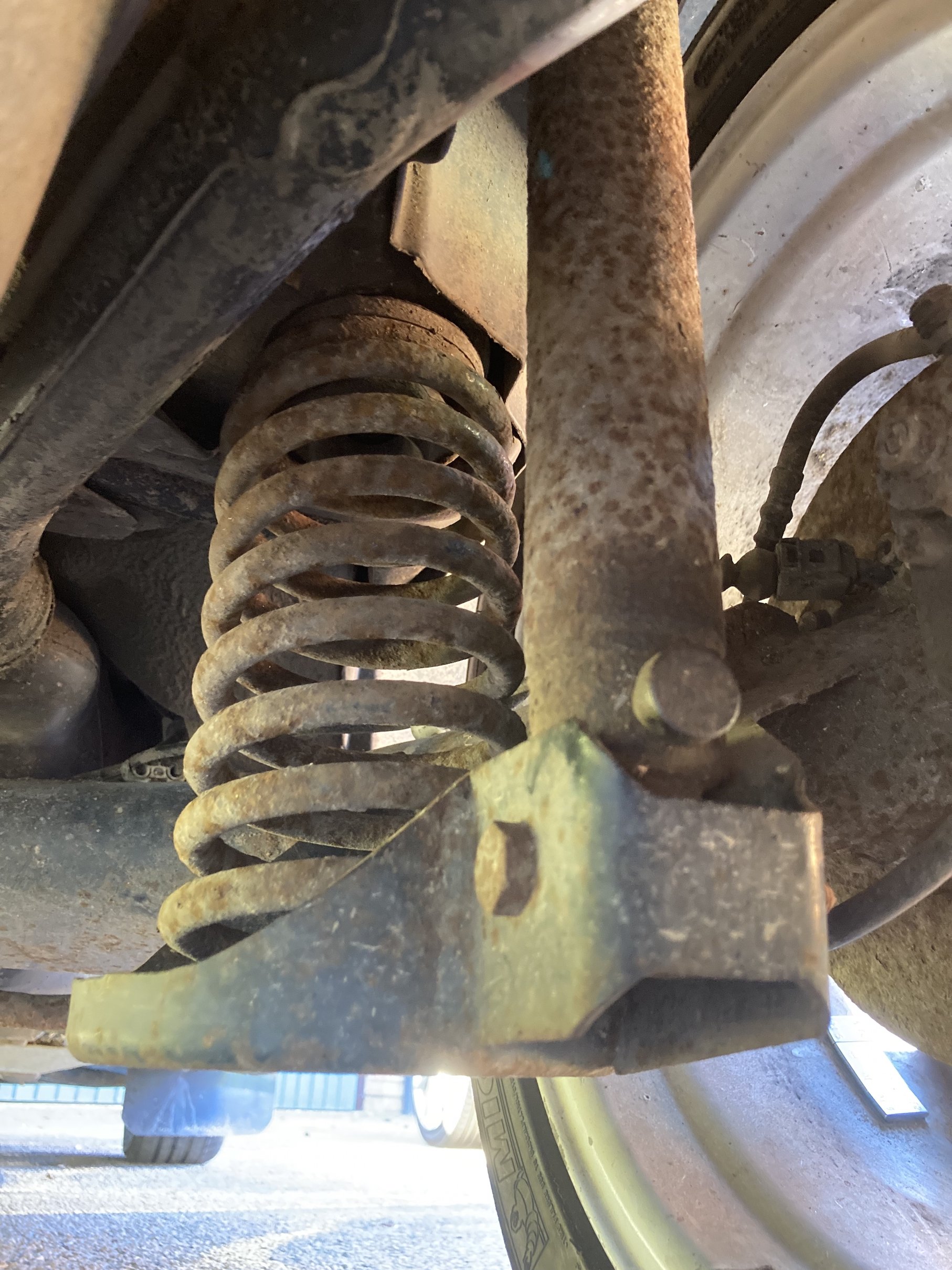

Yep, I wasn't sure whether my springs were std height or not. Looks like they are. So no issues fitting std shocks. 👍

And here we are on std shocks with 12 months' of MOT Looks similar to on the adjustable ones so ride height must be standard (maybe up a little, due to being partially stripped out). And here are the old adjustable ones that I can get refurbed, or replaced for not much more. Thanks all.

Hi, I did a quick search and didn't find anything. Two parts to this. 1) Please could someone tell me the standard ride height of the mk1, and where that is measured to. I have Gaz Gold suspension on my Fabia rally car. I don't know exactly whether the ride height is higher than std, but it looks it. I'd like to know how to measure it and what to compare it to. 2) The reason for asking that. One of my rear shocks, offside rear as shown, failed the MOT on a failed lower bush. (Yeah, as you can see they are pretty rusty). Gaz can refurb the shocks. I am considering std shocks in the meantime to get through the MOT. Gaz have advised, 'We cannot say for certain whether fitting a standard shock will get you through the MOT process. If the car runs higher than standard ride height then the standard shock will probably be too short.' My question is, does that make sense? Others (albeit not suspension manufacturers ) have said std shocks would be fine. Thanks, Jon (currently clueless about suspension but learning)

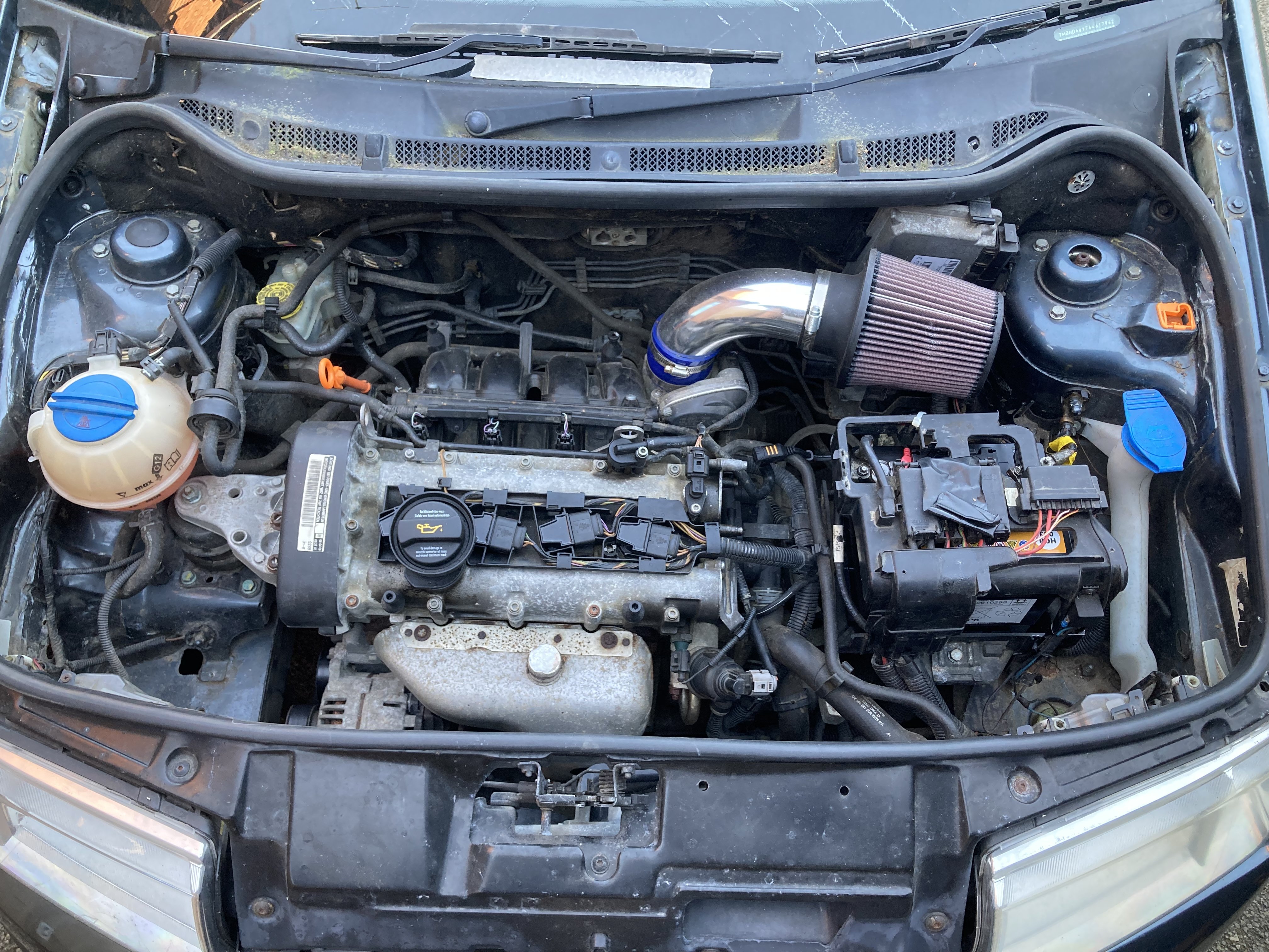

1.4 BBZ engine stopped and won’t restart
Perfect! One of the coils blew the fuse. Replaced it with a spare and all good. Thanks so much for suggesting that fuse. We’d checked a couple of others based on another post somewhere, but didn’t go down the list looking for other likely fuses to check.
Thanks Wino, that’s a great help. I’ll order some fuses then see how I get on.
Ah. We checked 17 and 56. 52 was kaput. I swapped it with 50 (RH dipped beam). It blew when I turned the ignition on (I heard it go click).
