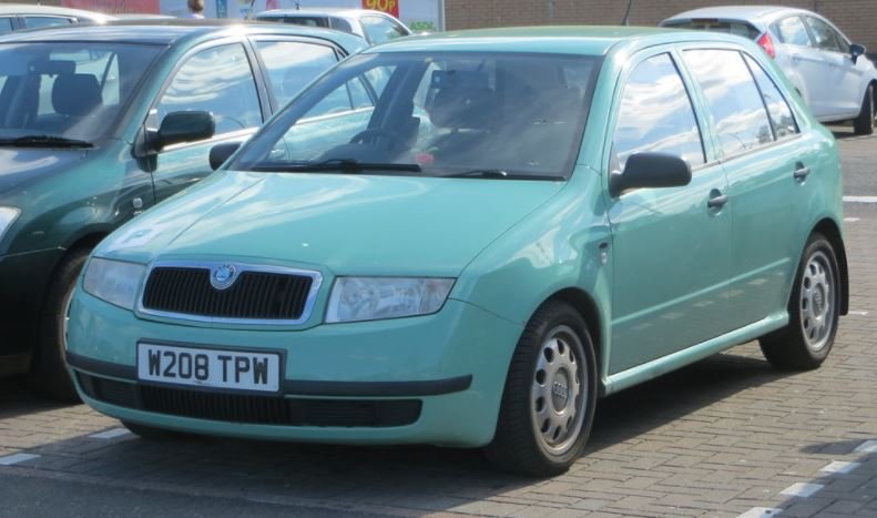

Looks good... Been thinking of replacing the alloys on the Bohemia with Steels. Only 'cos the alloys are looking a bit tatty.
It's looking good with those pepperpots on it! I saw a Fantasy Green one on the 'net with those pepperpots and I liked it. Managed to find the file on my laptop too. :)
A reduction in unsprung weight is always beneficial to handling and acceleration.

Love that green one.  I have the centre caps too but they are a little bit crusty and I don't need them on.
It is a nice car. Sadly not mine. I'm looking at a Fantasy Green one for my next car since I'm quite partial to the Fabia.
