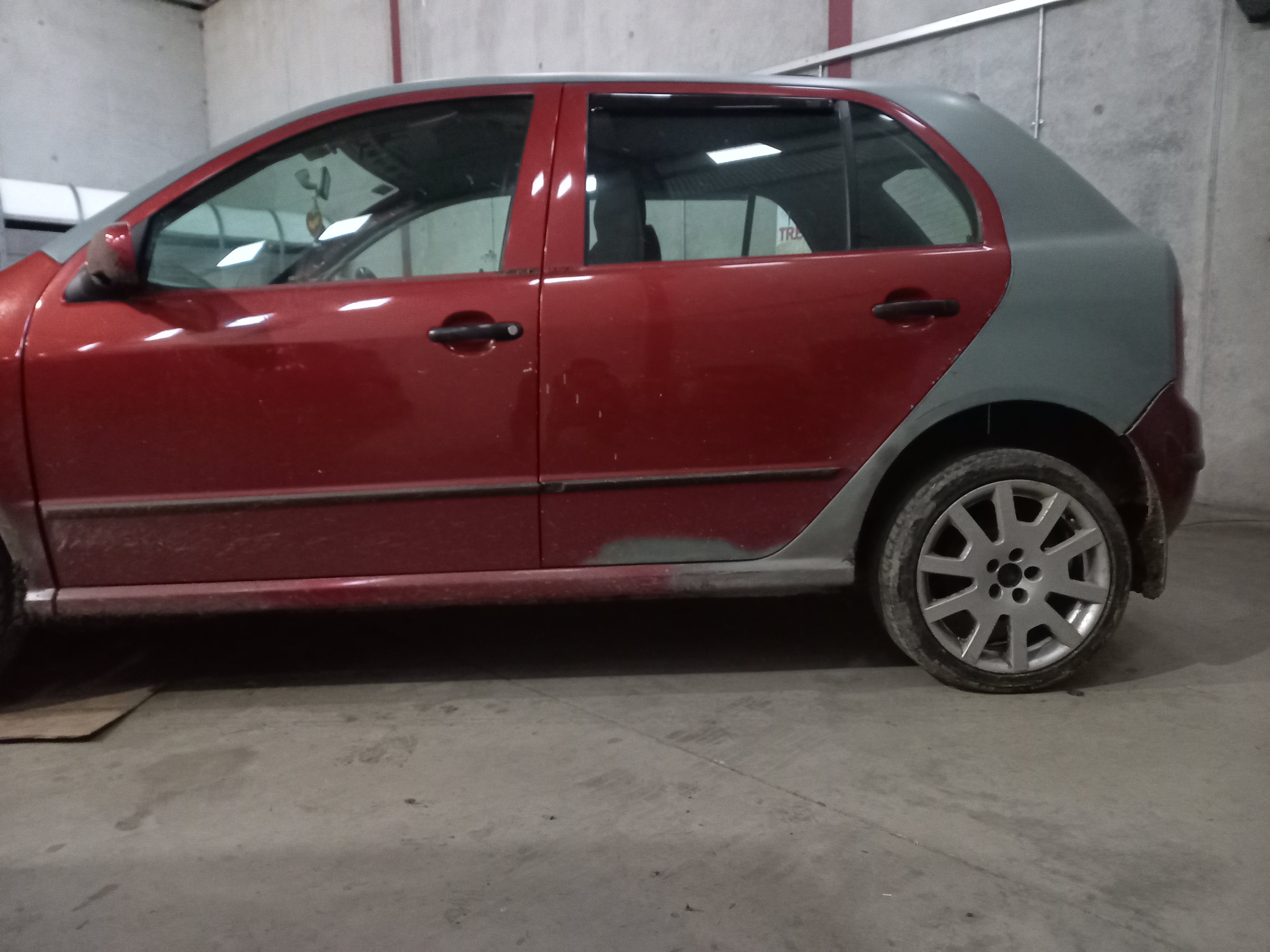

1) Please could someone tell me the standard ride height of the mk1, and where that is measured to.  I have Gaz Gold suspension on my Fabia rally car.  I don't know exactly whether the ride height is higher than std, but it looks it.  I'd like to know how to measure it and what to compare it to.
2) The reason for asking that.  One of my rear shocks, offside rear as shown, failed the MOT on a failed lower bush.  (Yeah, as you can see they are pretty rusty).  Gaz can refurb the shocks.   I am considering std shocks in the meantime to get through the MOT.
Gaz have advised, 'We cannot say for certain whether fitting a standard shock will get you through the MOT process.  If the car runs higher than standard ride height then the standard shock will probably be too short.'  My question is, does that make sense?  Others (albeit not suspension manufacturers :) ) have said std shocks would be fine.

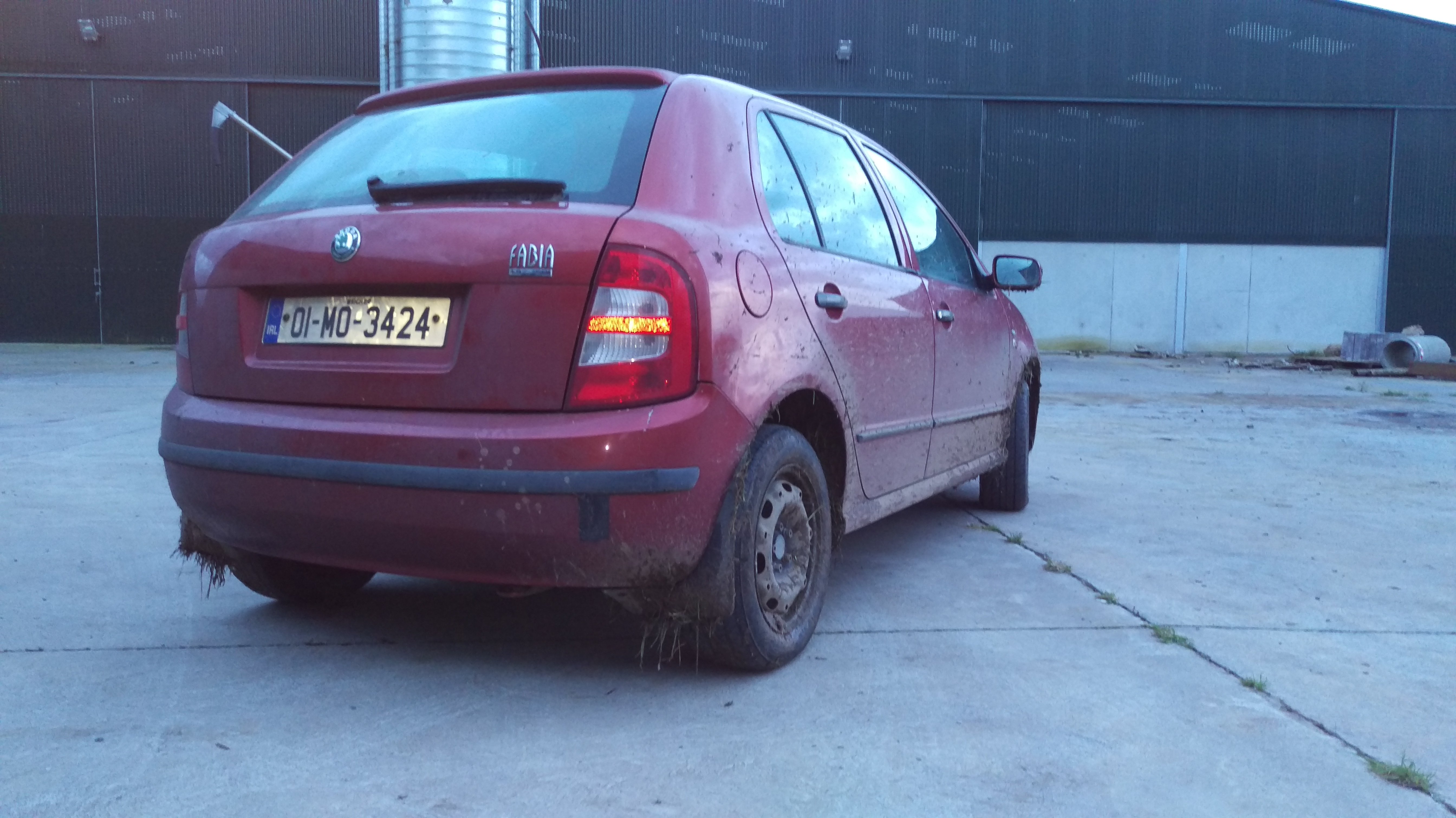

I don't know if this is much help but this is how high my mk1 sat on standard suspension. Bear in mind its partially stripped. Don't have any measurements of how it sat but it was quite high indeed.

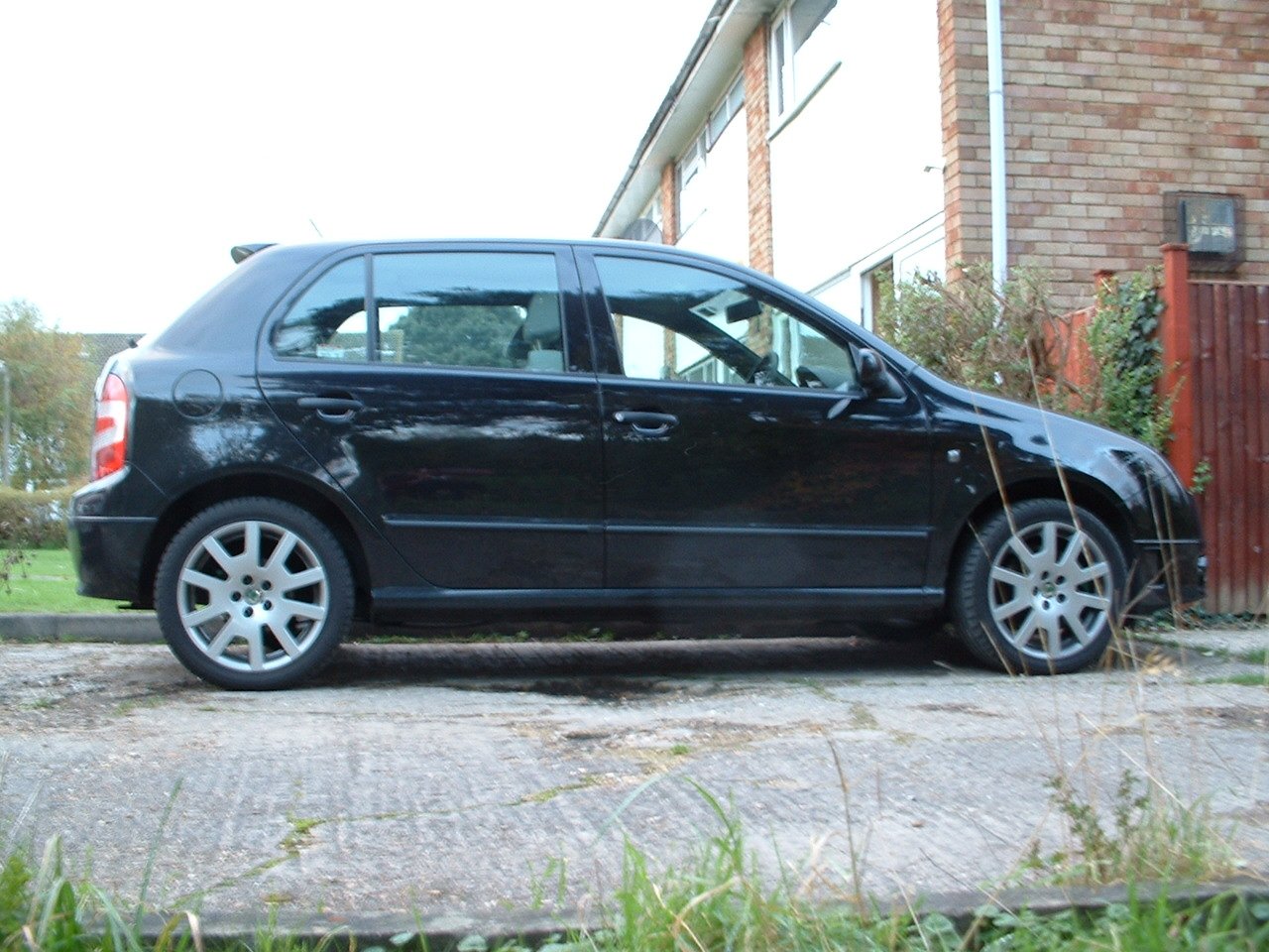

Thanks, that is interesting.  I did a very unscientific side by side comparison, overlaying some intersecting lines in Photoshop.  This is when mine was running on the 14s.  Very roughly, not much in it.

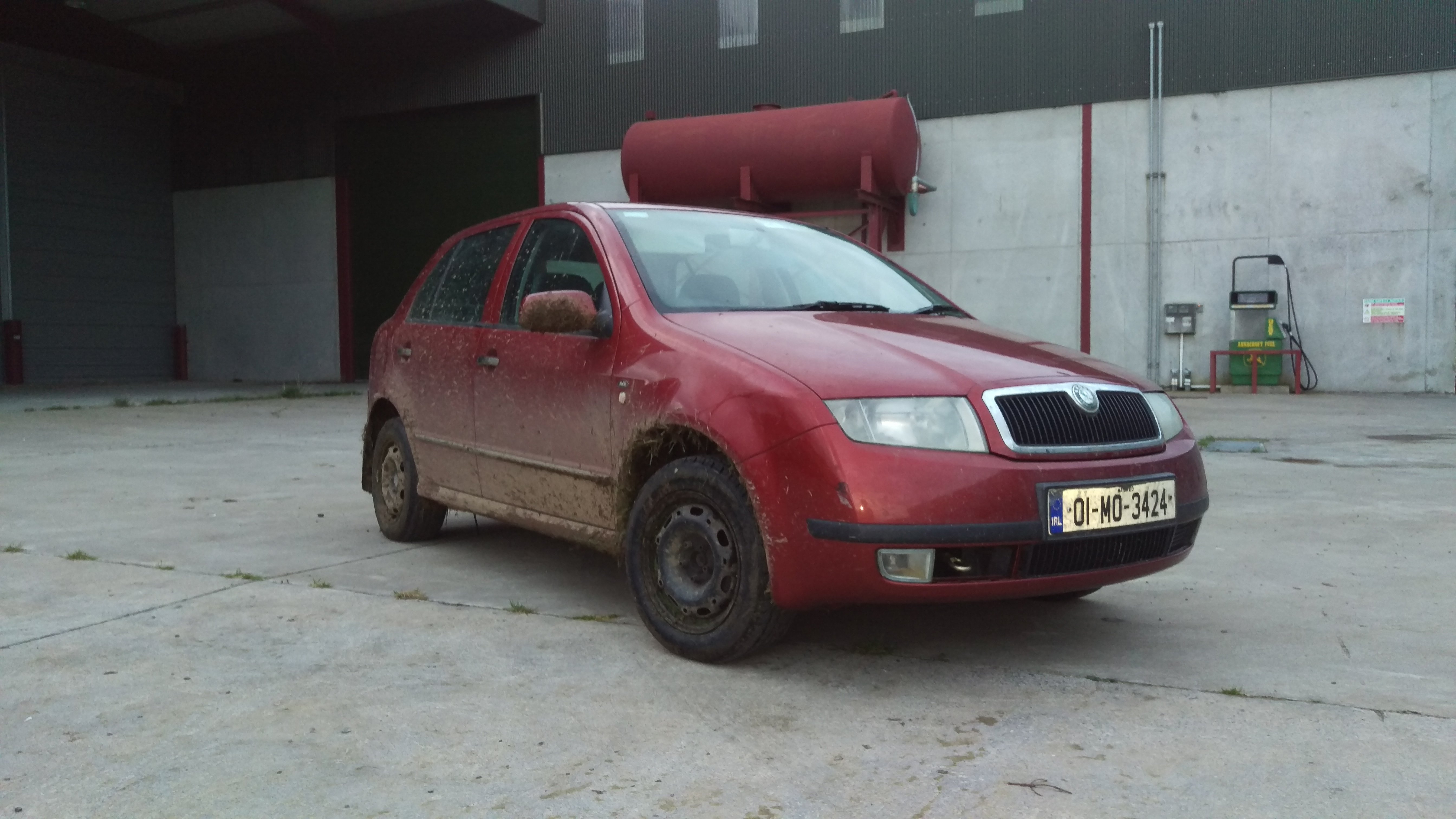

Mines Stripped in the back so it rides high because of that, but since your cars also stripped it would also ride a bit higher. Reckon you could get away with it if you needed to. Surprisingly great offroad these are I must say. Just attached a pic of my car bog standard because that might be of some help to you. IMAG0054.thumb.jpg.63b239c4a130801e4f1a2cfb07b3bde7.jpgIMAG0056.thumb.jpg.516b488427087f7f932d53e5a584790f.jpg

Agree they are great off road 😁

It look close enough for government work. It may be a tad higher but your photo angle would exaggerate the gap slightly anyway.
