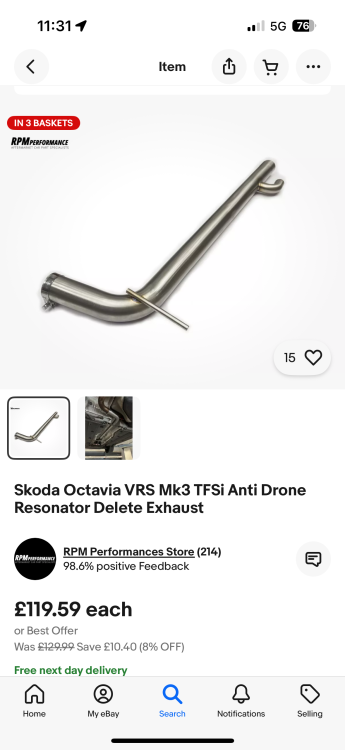

  5. Yes can be found on eBay it’s the little bit at back that’s stops the drone

  7. Go for a res delete anti drone set up

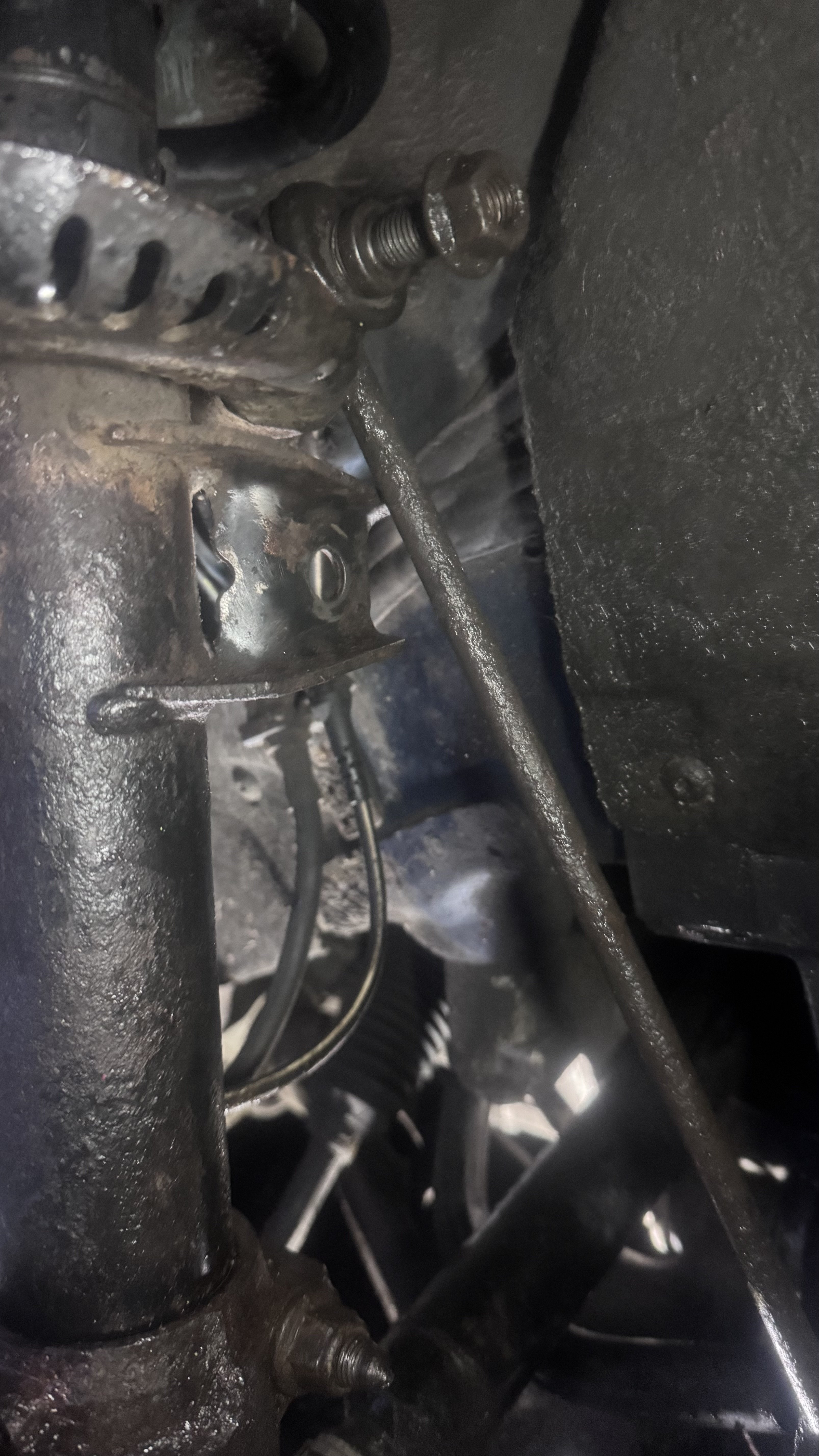

  8. I’ve recently due to a snapped front spring changed the rears, and set about changing the fronts (driver side first) took my time and soaked all relevant nuts etc and all went well with the removal……. Upon refitting strut was fastened with the x3 13mm top mounts screws tight but not torqued, thanks to the splitting tool bottom of strut fixed into hub….. But for the life of me the splined cv won’t go into the hub, the top drop link looks about 1.5-2 inch short of the mounting and the driveshaft seems to touch bottom of strut. Any ideas ? Got soaked trying to sort 😭

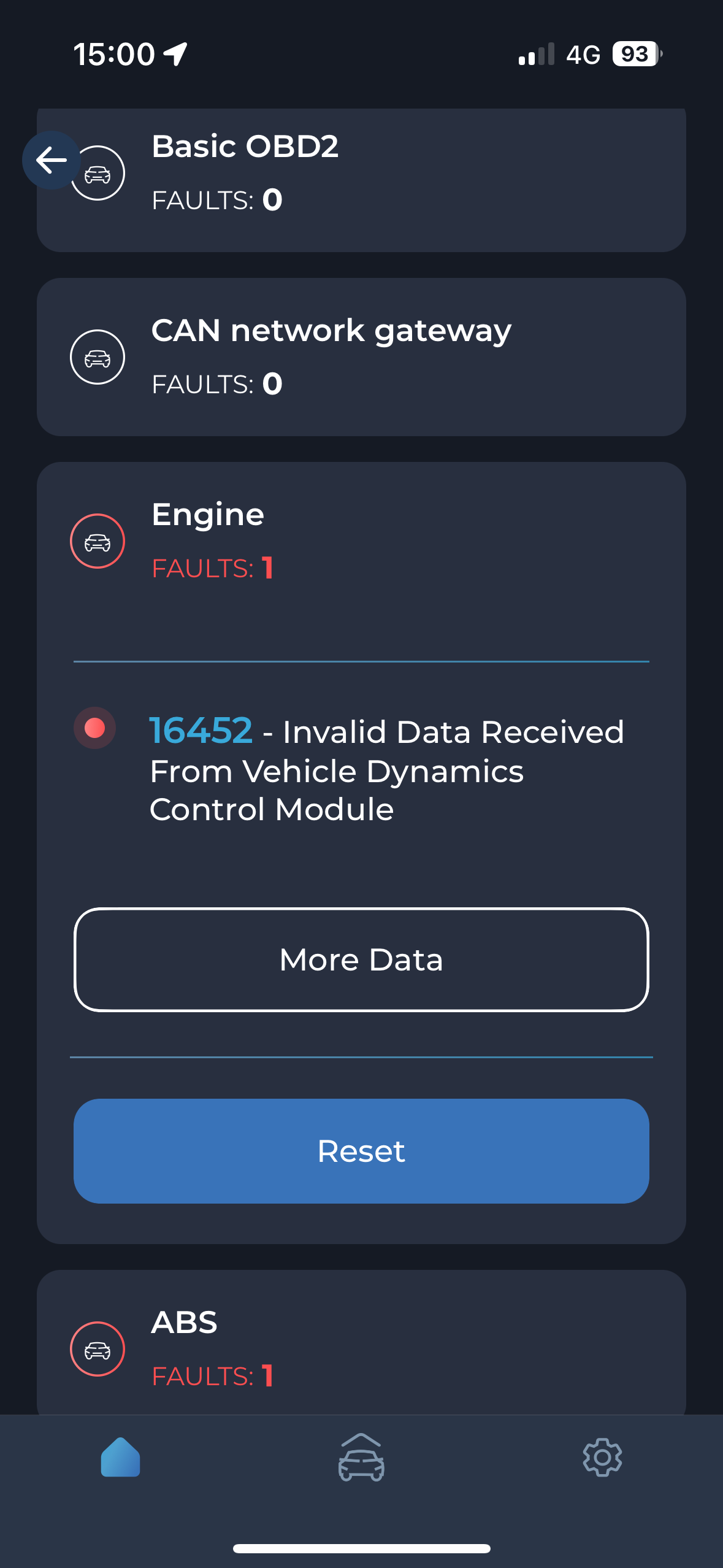

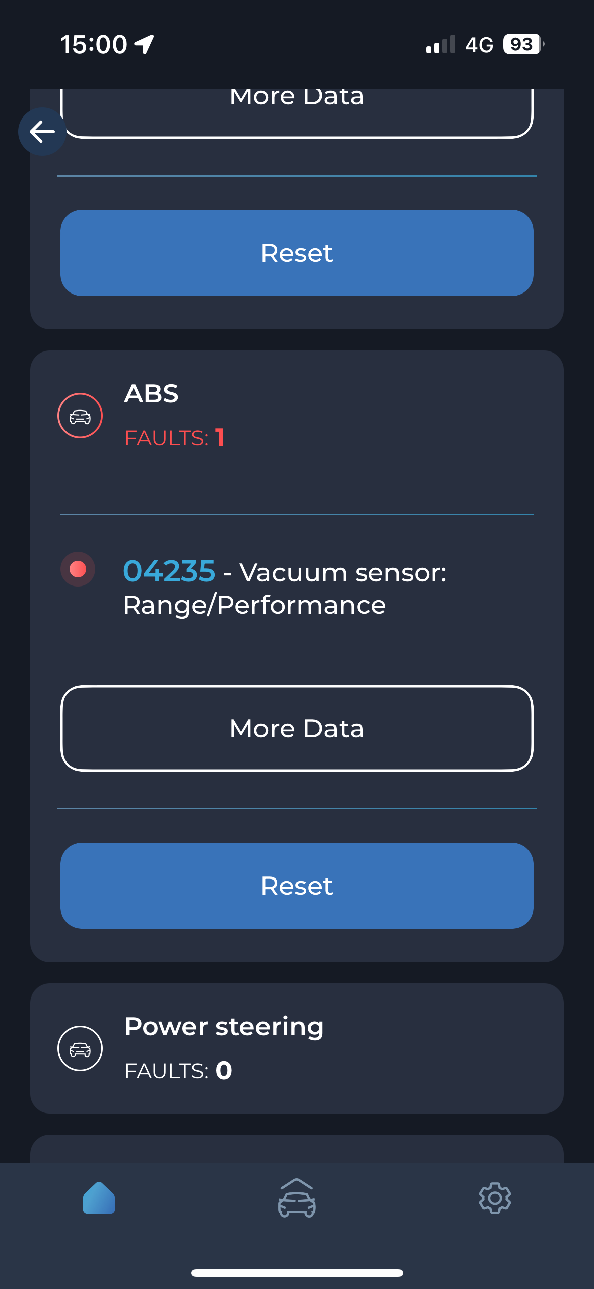

  9. Hi been to have a look at a Skoda Octavia VRs (2016) 2.0tsi petrol I use my Carista to scan the car and it came up with the following are they an easy fix ? The garage is taking care of this, but wanted advice on the route cause of both codes pic attached (hopefully) I’m moving on from a Skoda Fabia VRs mk2 dsg
