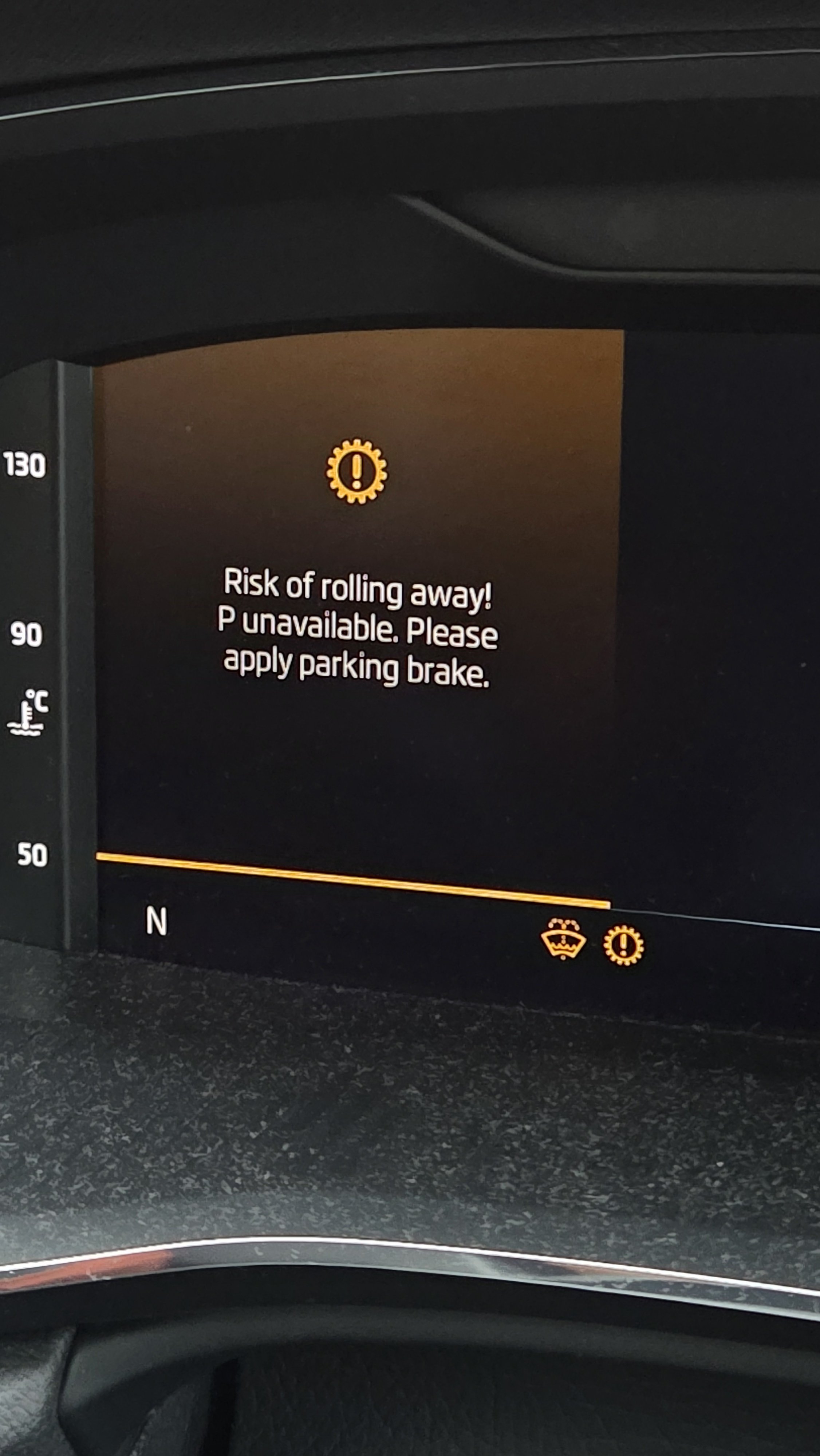

  1. How did you link the cause to the faulty battery? I was thinkering with it for about 20 mins while waiting for the tow truck with multiple restarts, lock ups, restarts etc, with no effect (it was also refusing to lock since it wasn't in P, had to lock it through the open window using the dash button).
  2. Hi, I drive a 2023 Octavia 1.5 TSI MHEV, DSG, 22000km. Yesterday, after opening the door I was welcomed by a beeping noise and an orange "Risk of rolling away. P unavailable. Please apply parking brake" message on the dash. Car started up normaly. Put it in D. Automaticly switched back to N and the message switched to red one "Gearbox faulty. Pull asside safely." After that refused to go in to D or P. The messages on the dash switching between the orange and the red one. Towed the car to the service center. Ofcourse it turns on normally with no issues and no error history. According to them, there is nothing they can do. Experiences and suggestions? Cheers. Attached is the orange error, didn't photo the red one.
