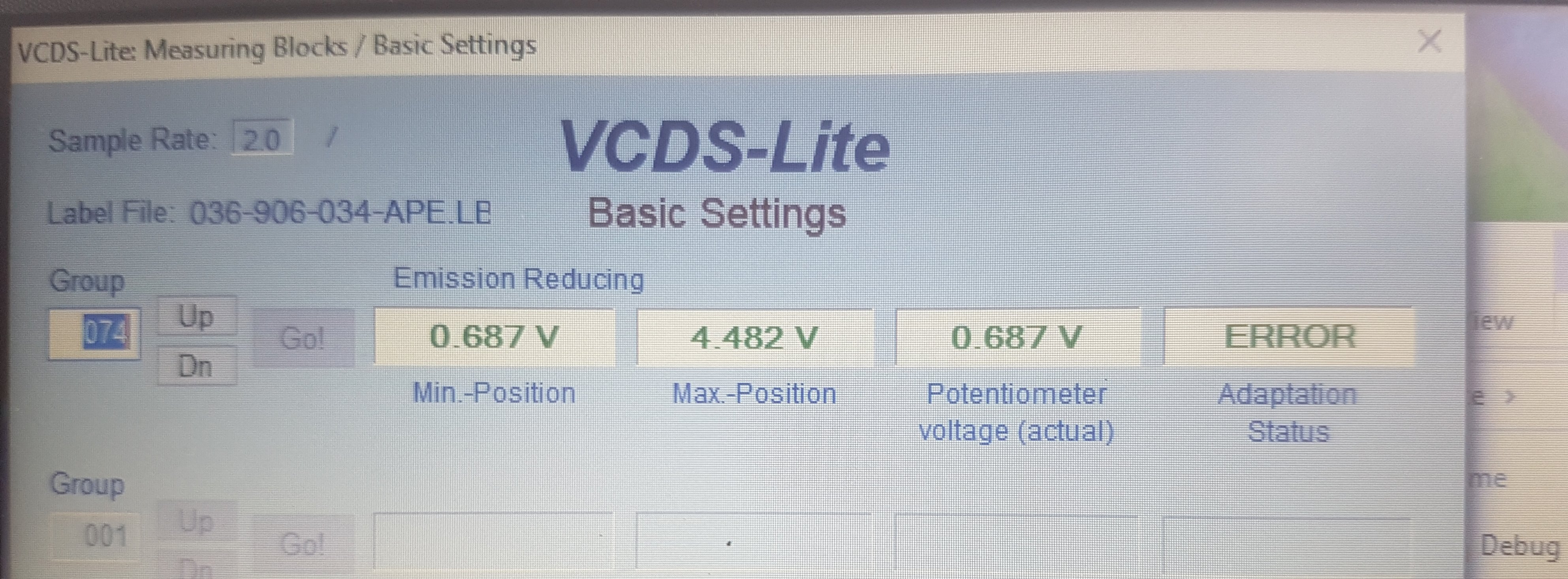

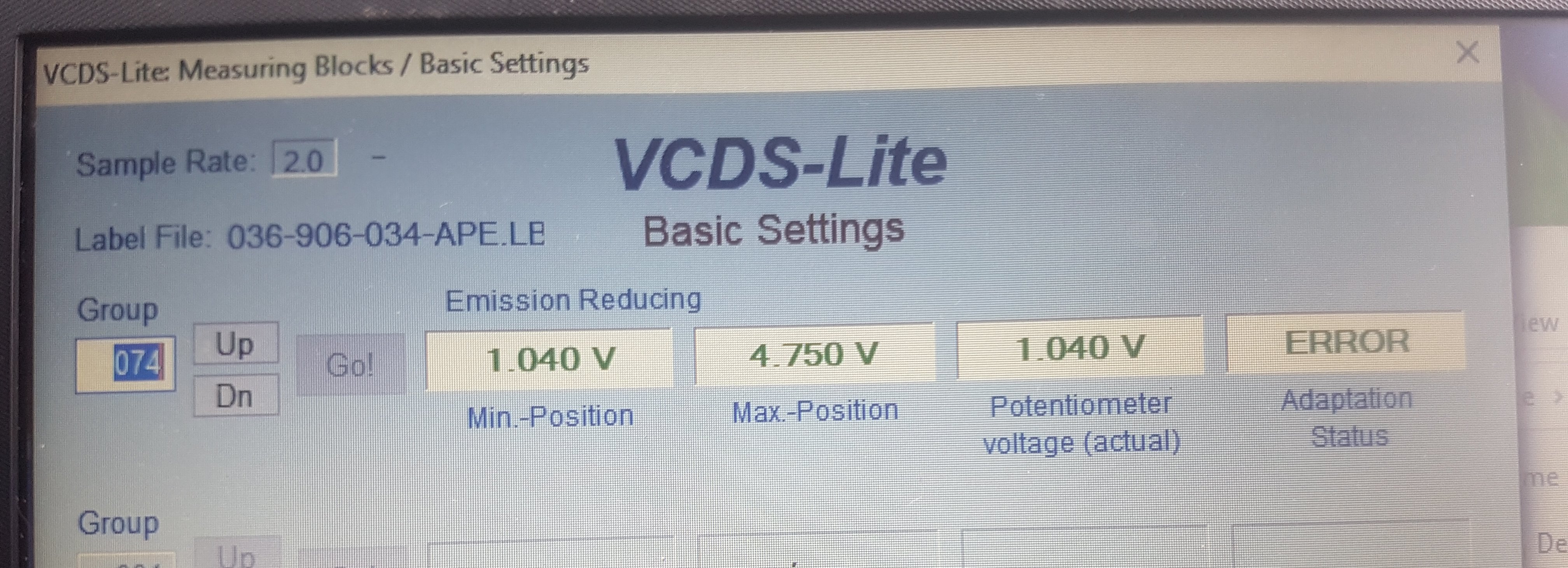

I found someone with vcds and it won't adapt I got 2 egr valves and both the same I put some photos of the numbers

I have put new plugs,oil change new filters but I do think it's the leak now and is the p1404 egr system basic settings not performed will I have to sort this problem out for the mot as I do not have any lights on just shows up on vcds on error code thanks

skoda fabia 1.4 2005 failed MOT on emissions exhaust lambda reading after 2nd fast idle outside specified limits (8.2.1.2 (c)) i come home and read fault codes with vcds and got error code P1404 EGR System Basic Setting not Performed does anyone think this could be the cause for the emissions fail? i been told by the garage to change both the lambda sensors but as they cost alot i need advice 1st thanks in advance

No I'm waiting for the cable to arrive so I can adapt the new egr valve and it's 2005 last time I drove for half an hour and the egr valve code came up forgot which one now and it ran perfect but soon as I erase the codes it gets worse so I'm still driving it so the code comes up as I hate it stalling on ever corner but with the 1st egr valve all I done was cleaned TB and egr and all pipes connecting to and it ran perfect for 2 months never done a egr adaptation so got a replacement sent out which I installed and got the problem again but I will wait for the cable to adapt egr valve and will update
Skoda fabia 1.4 16v stalling
Well put new egr valve and same problem again what can be the problem??? I can drive it with the engine light on but when it comes to the mot it be a fail this car really doing my nut in

Update it's was the egr valve in the Stuck open position now the error codes come it doesn't stall anymore as the ecu put it in default settings but If I clear the code it goes rough again till the code pops up again so got a replacement on it's way Thanks for everyone's help
