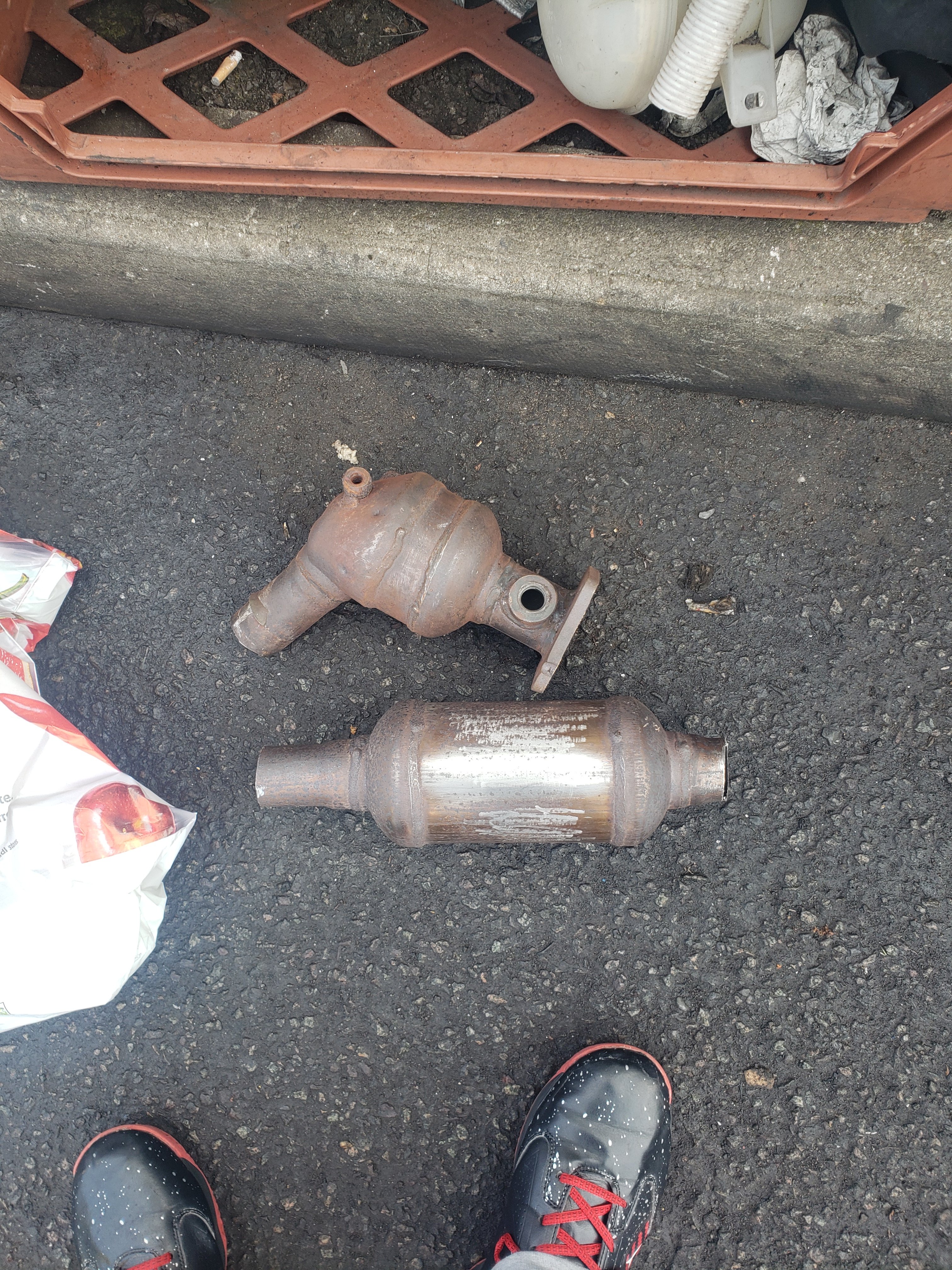

  3. Not good news then I did speak to the previous owner who bought the car brand new and never changed the exhaust he only replaced the flexi part with a universal one

  5. It looks like the second one you sent me but unfortunately can't find any numbers on it apart from the ones I said earlier but I did email a company which I later realized was in America anyway sent the pics and told them it got no number on it they still valued it at $20 for the small one and $263 for the big one. I think i need to sand them till they shiny incase there is numbers hiding underneath somewhere and yea of course you can have 10% 👍👍
  6. Hi everyone I got 2 catalytic converters from a skoda fabia 1.4 16v 2005 bky engine I wanted to sell it but there is no oem number on it apart from 542-013x which people say it doesn't exist on the catalytic converter database. I have sanded the rust off to see if I can see any oem numbers but only found the ones I mentioned above anyone with any idea
