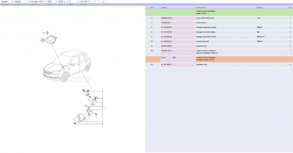

  1. Not aware of the specifics of this retrofit but found this after having a quick look on https://ifinterface.com/page/page3.php?langid=2. Seems the part number is 7P6 907 357 E Z00. Hope that helps
