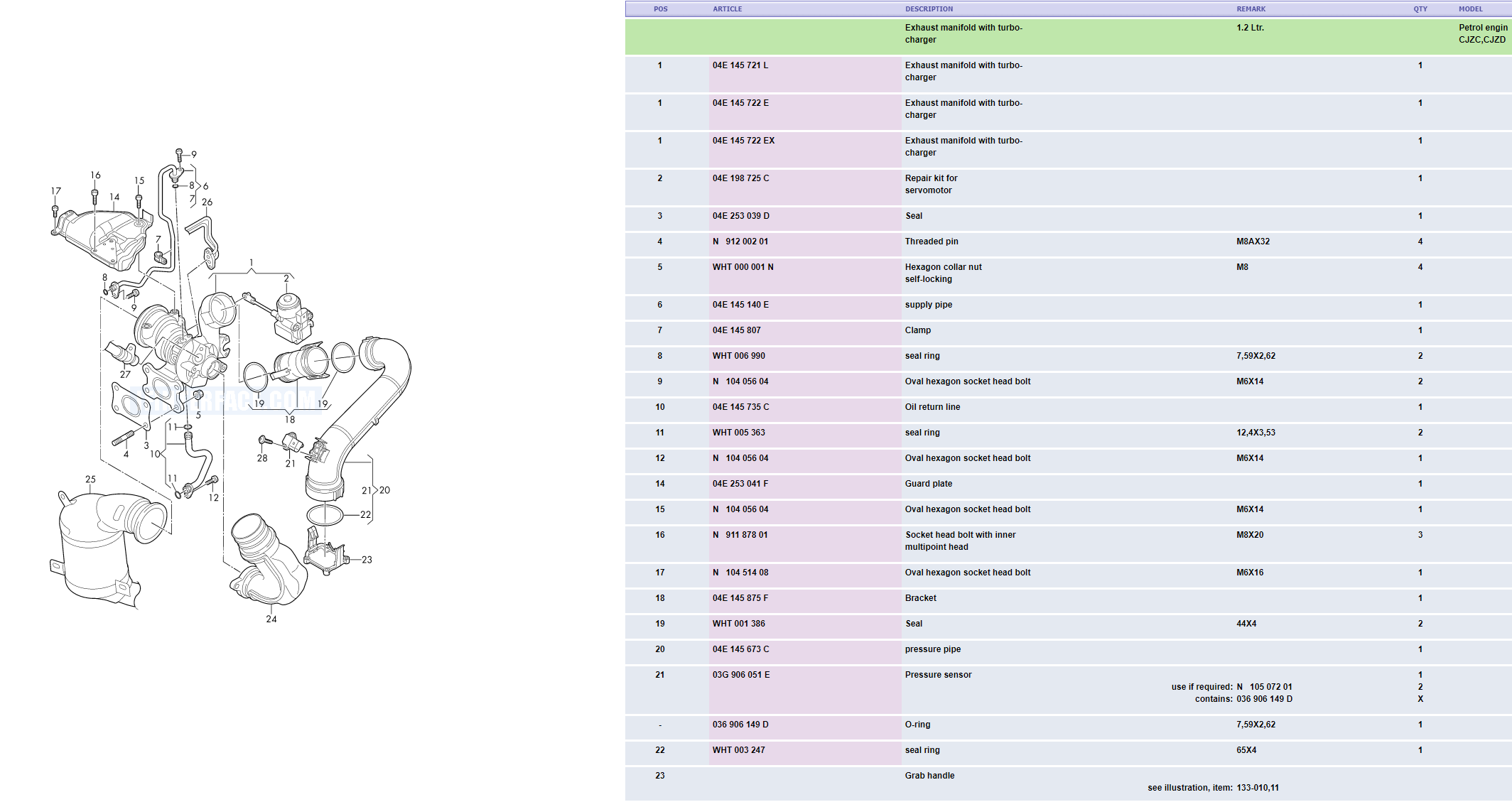

  4. I'm assuming just by looking at the engine it's a 1.2L TSi CJZC/D as it looks like the top of a coil pack between the inlet and blue charge pipe. If that is the case that charge pipe is part number 04E145673C. There should also be a MAP sensor in that pipe part number 03G906051M held in with clips on the pipe or two screws(N10507201). Might still be there somewhere under the pipe have a look. If it is supposed to have that MAP sensor and it isn't present at all (harness unplugged) and theres no engine light it might be tuned. I'm not sure which sensor is relied upon as there is also one on the top of the intake manifold/charge cooler. You'll also probably need 2 o rings, WHT001386 at the turbo side, WHT003247 at the intake manifold/charge cooler. There also looks to be a vacuum line coming from the throttle body/charge cooler to the blow off valve but where it goes from factory I'm not 100% sure. I've included a part diagram for your refernce. Also might be worth giving it a wipe down before opening up the intake system 😄 I'll try and get some pictures of the engine bay totaly stock for your reference as well when it stops raining. Hopefully all that is of use to you.
