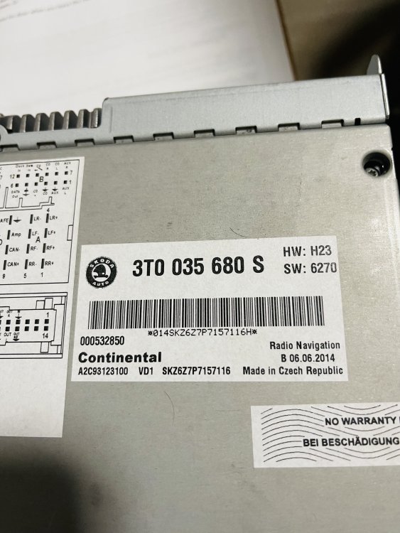

  6. It's C14+ and the original firmware as shipped according to the label was 6270 Hardware H23
  7. I am also looking for 6276 or 6270 but preferably the former. I think my hard disk died and I want to try to re-load it or swap it out for a drive I have lying around. My reboot loop is a black screen with a flash of a white line every now and then. I did the 3 finger salute and only then did I get couldn't load image red line SWL on the display so I know I can get it there.
