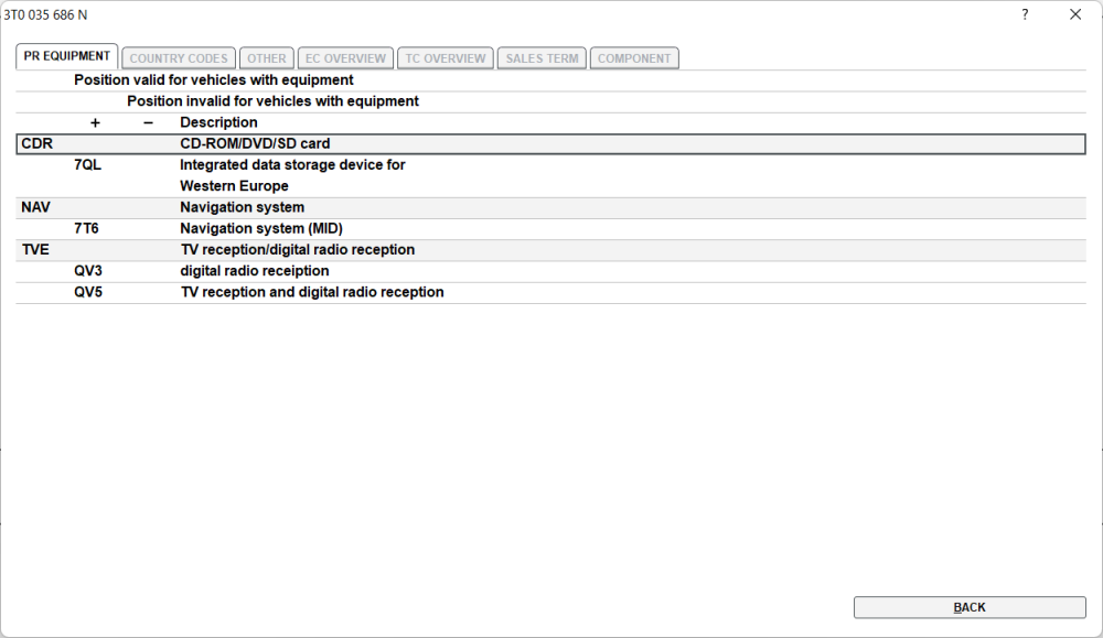

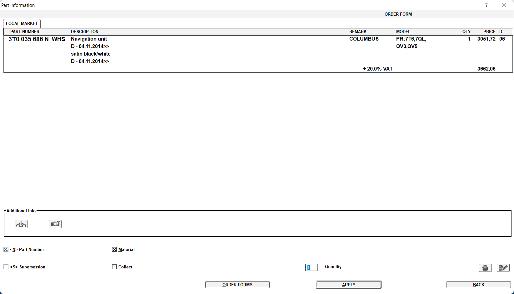

Here is the details on the radio fitted, pay attention to the PR Codes as they determine what is available.
I called this picture "kidney" for very obvious reasons.
Unless someone know of a company that repairs these units, then you might be stuck for a bit.
We can lookup the PR Codes for the other part numbers like "C" and so on, so you can choose if you are happy to possibly loose a function for the eBay ones you did see.

If you pull up some details on what you have seen online, me or someone else might be able to assist with decoding the PR codes.
You will also need to have the new radio swapped over with dealer tools to your VIN so that it can function.
