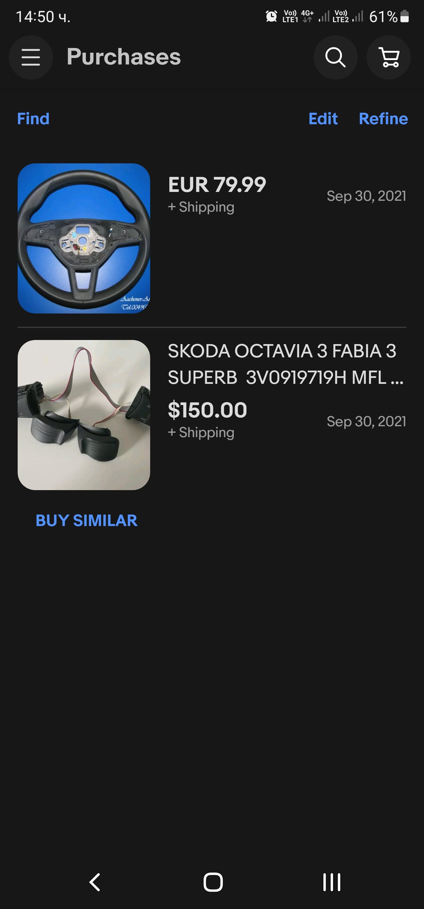

No, it is needed the buttons to be also for DSG, like on the link. See screenshot from my eBay app. I also bough new buttons competable with DSG paddles. I used only plastic trim and airbag from my car's factory steering wheel.

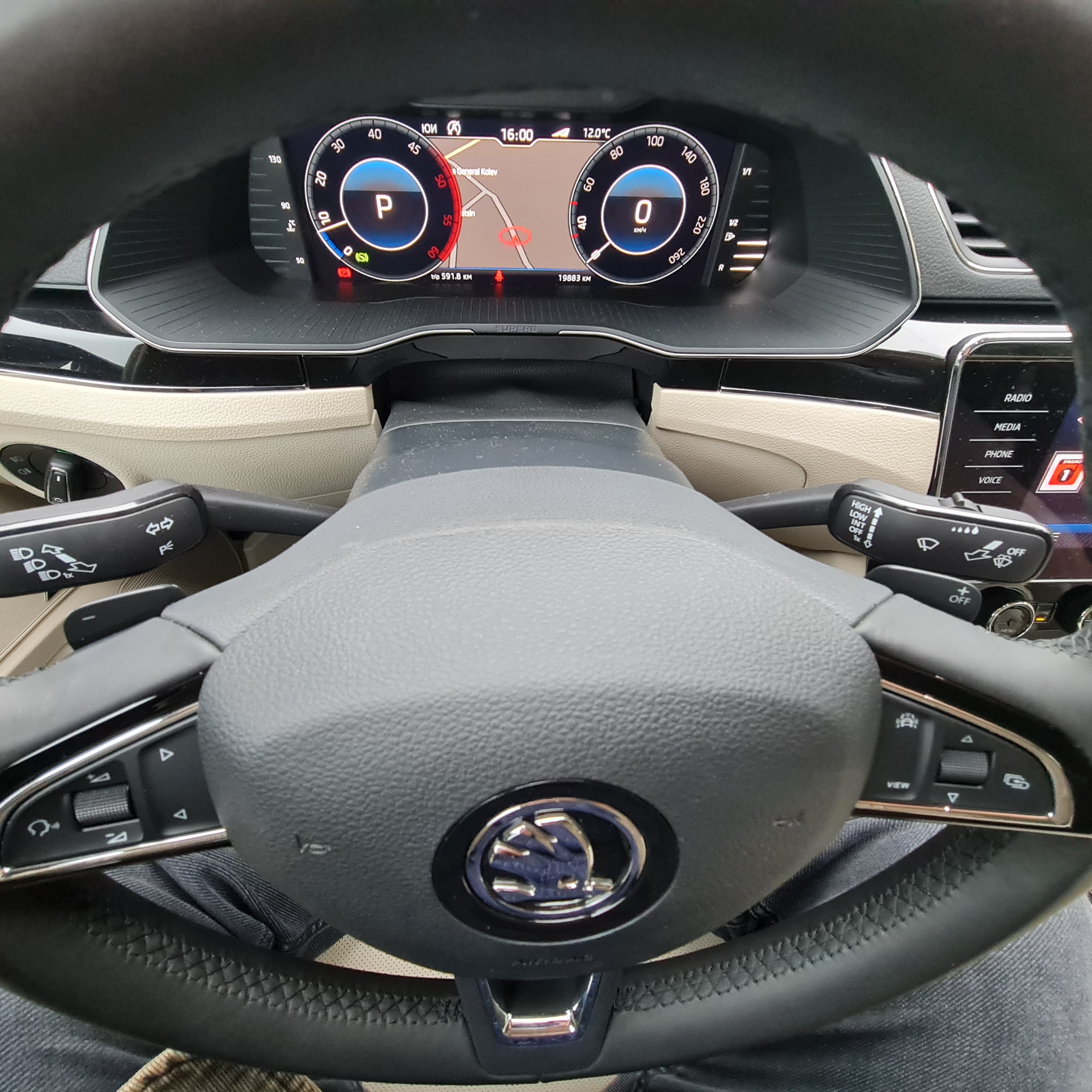

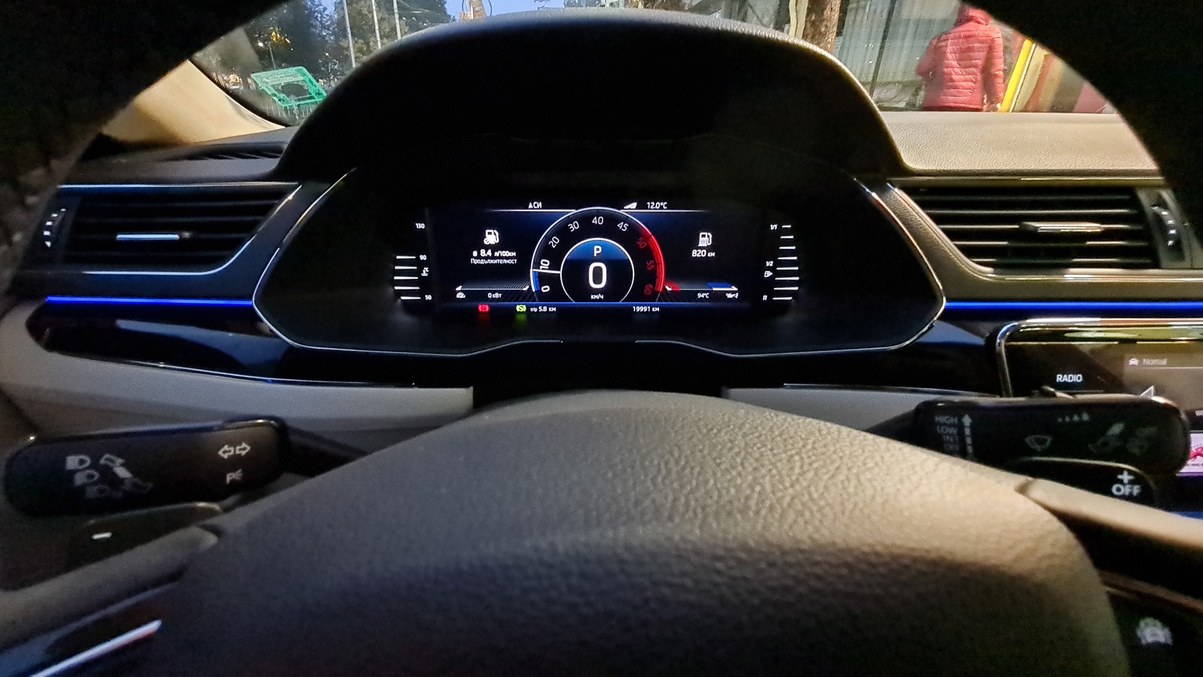

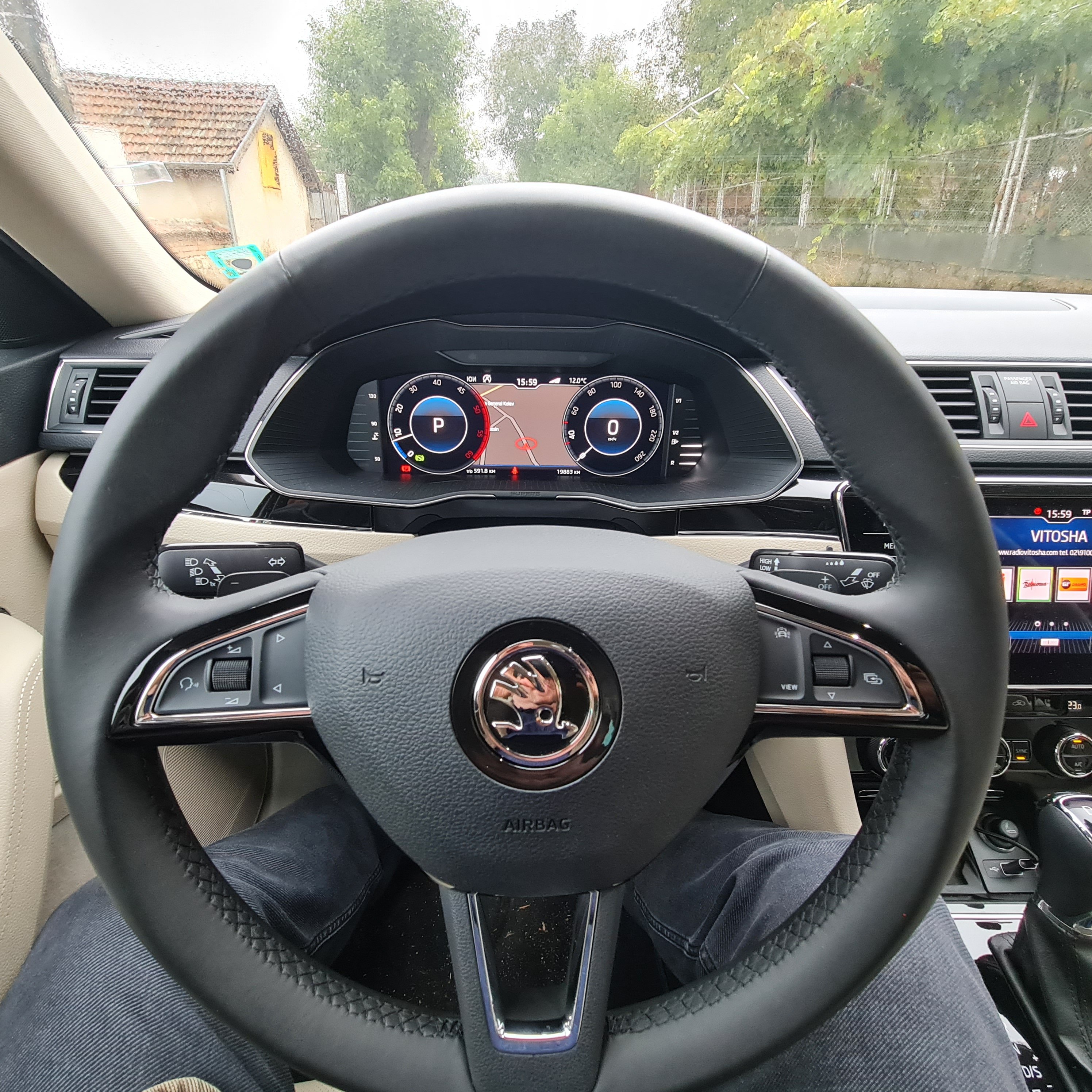

Hi guys, I finally have my paddles steering wheel. I found oh eBay paddles heated st wheel (only the wheel) for 100 Euro delivery includ. And additionally paddless+View MF buttons. For another 130 Euro. Totally for 230 Euro, instead 630 Euro for brand new from dealarship. The airbag and pkastic trim I used from original st wheel. Now I'm selling original st wheel and MF buttons. So, now I have my dreamed paddles. After install it everything start working!!! Thank You very much to all of You in this topic!!! Your information and advices were very usefull. See the pictures. Best regards, Nedko- Paddle wheel retrofit to L&K
