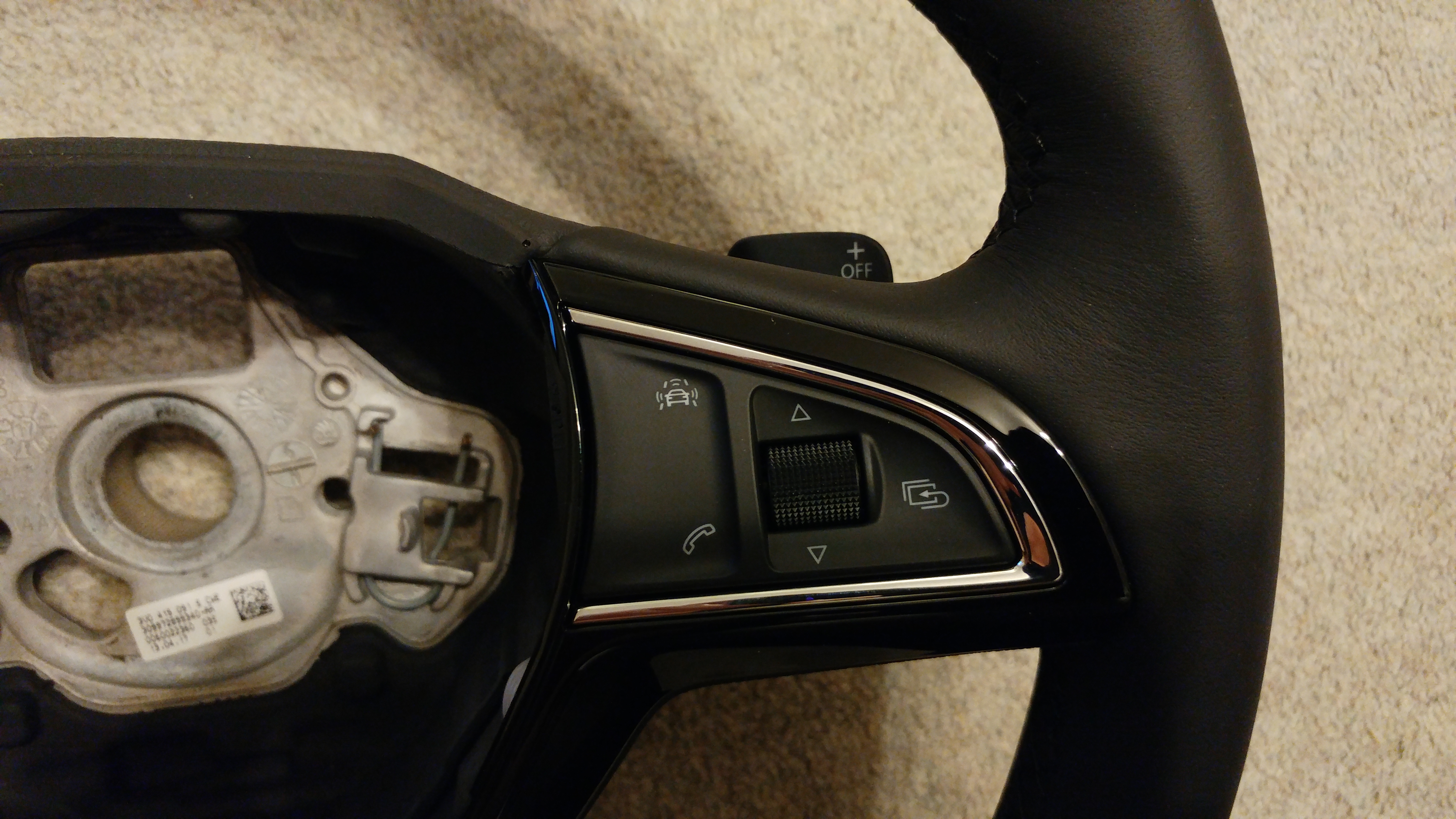

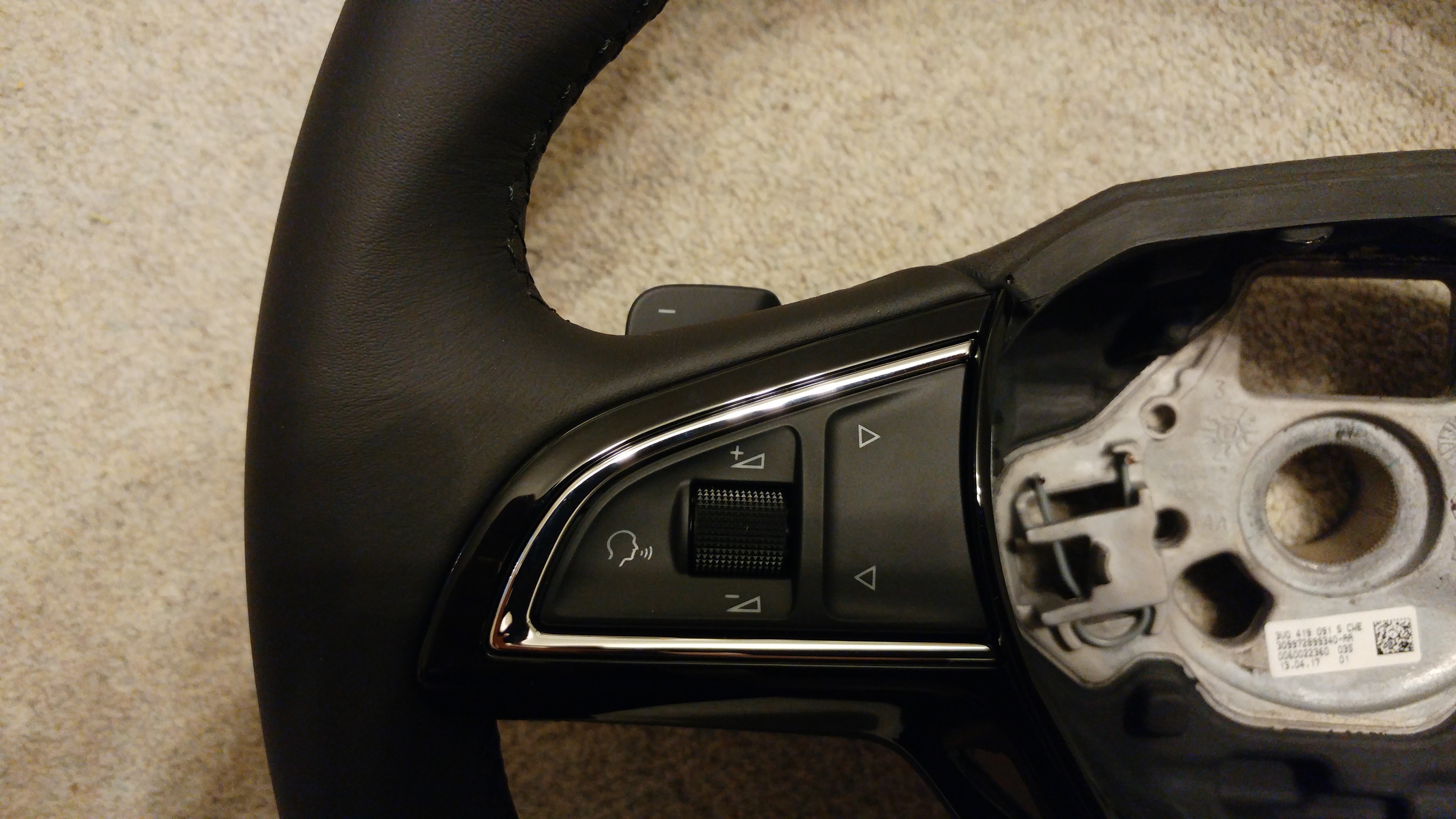

  • Hi guys, I finally have my paddles steering wheel. I found oh eBay paddles heated st wheel (only the wheel) for 100 Euro delivery includ. And additionally paddless+View MF buttons. For another 13

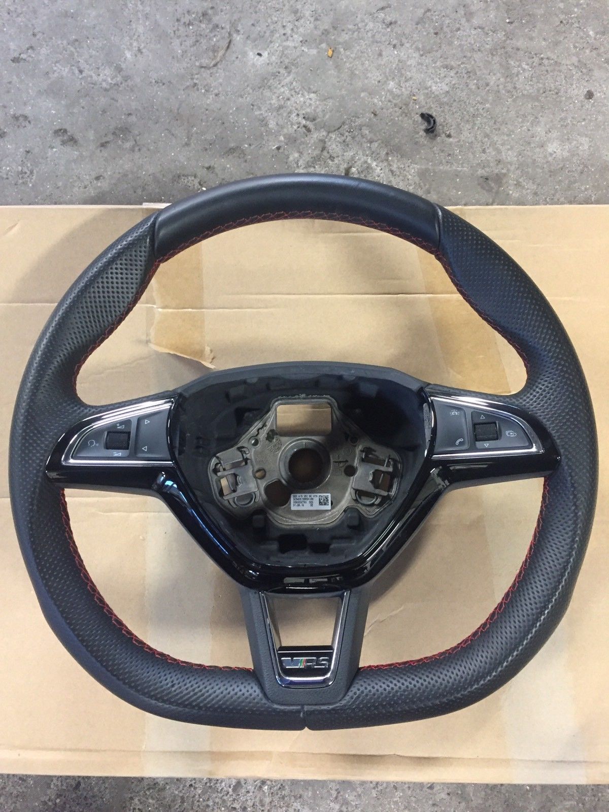

  • But the buttons will not work in the Superb, the buttons are very easily swapped over though (I have a vRS / Sportline wheel in my L&K) personally I prefer the perforated leather used on the FBSW:
  • Not correct! If you have MF st.wheel without paddles, your MF buttons on the st.wheel are not compatible with the paddles, as the car was not configurated with paddles and as the paddles are connected

Yes, straight swap and everything works
It's different apparently if you buy a vRS paddle wheel as the buttons are different, hence why I stuck with the round Superb wheel, I also didn't want to lower the tone of the L&K :)
IMG_1335
Then with the vRS badge removed (far better IMO):
IMG_2608
IMG_2609

But the standard non Heated MFSW fits without coding though I guess, just swap the octavia vrs switches with the superb ones and plus the paddles in?
