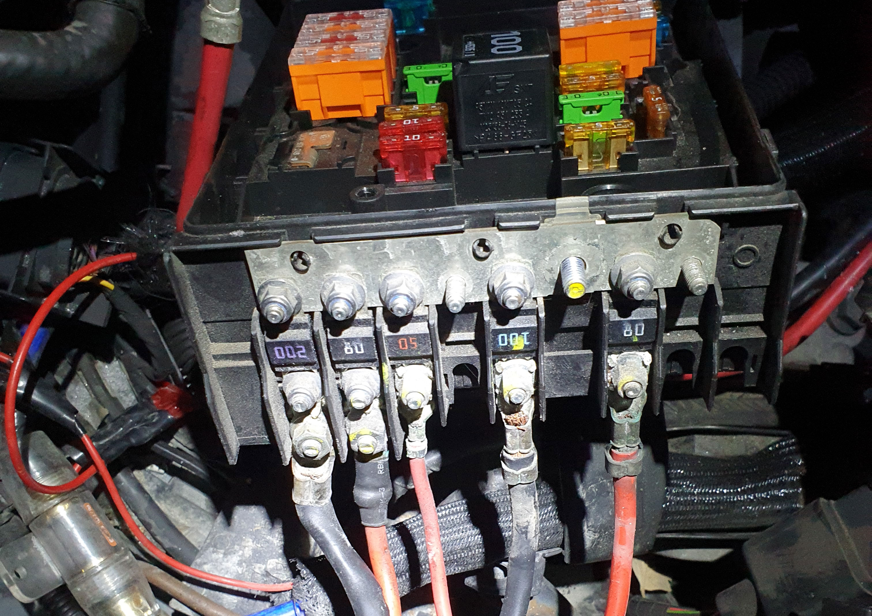

  5. By this i am assuming you mean all the pins sticking out from "under" the fuses on the fuse box in figure 1. These pins looked almost as good as new with no corrosion. Thank you both for Great tips, I will try a repair and give feedback on whether it worked or not. Saw a youtube video of someone testing the motor on the air flaps. Seems to be No problem as long as the position is noted down before messing with it. The motor itself is just plus and minus, opposite poles for reversing. The potentiometer outputs ohms in two places and noting those down and aligning after should lead to "No changes". How easy probably a question though. However using less volt makes it go slower. Not sure if the car itself has a "resetting" system that can "fix" misalignment. But i will only open these air flaps to check for wear and tear on the components. If only the gears are broken i can 3D print a new one. Also a lot cheaper to buy components rather than the entire air flap.

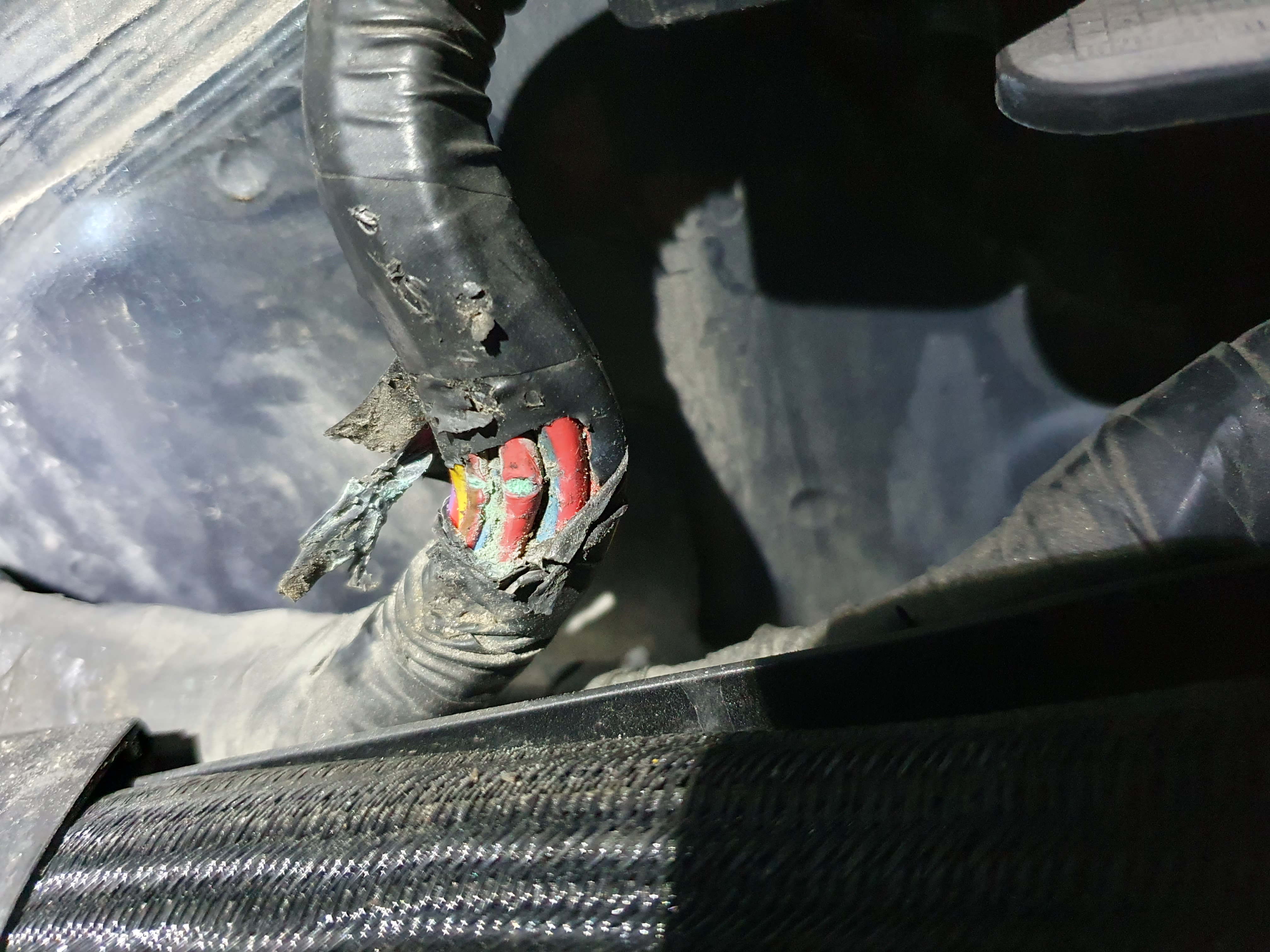

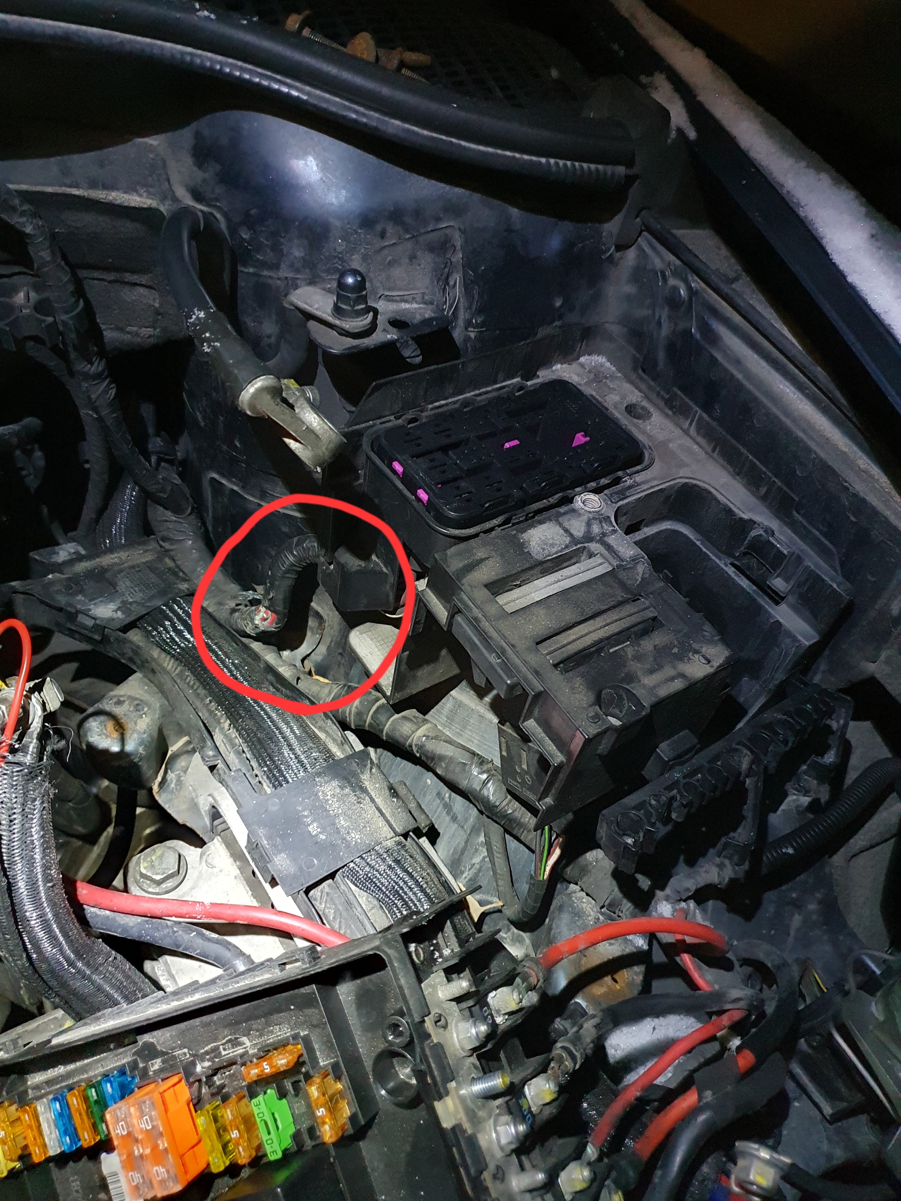

  7. Okay so I dug into the fusebox under the hood and saw a some I would like to ask if is "enough corrosion" and I also saw a cable going from the fusebox to the car which might be the answer to my problem. Would you say the corrosion on the connections in figure 1 are enough to be a problem and should be changed/polished? Figure 1 - Fusebox connections Figure 2 shows the location of the potential "master" issue and Figure 3 is zoom in of the issue. Do you agree this might be the problem and should be cut and resoldered with shrinks? Figure 2 - Overview of cables going from fusebox Figure 3 - Zoom in

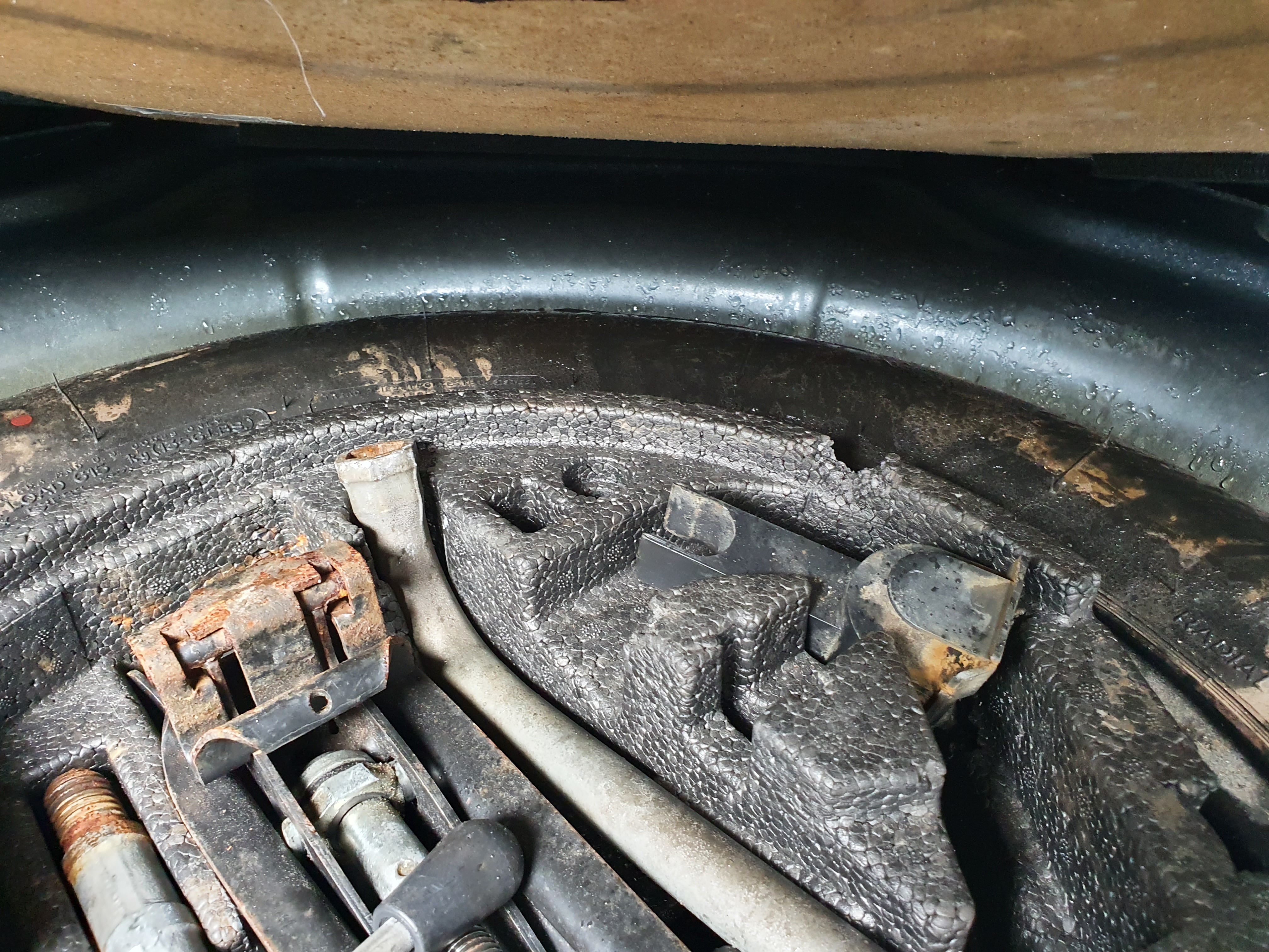

  13. Observed the water visually and tasted it (cause I'm a badass), but looked and tatsed completely fine, no soapy or different taste than normal rain water. I am beginning to think Maybe i should install something to gather the water so i can save some money on the water bill 😃
  14. Checked all the places you mentioned chimaera and everything is perfectly dry in my octavia 2 2005. Adding a photo for reference to where it exactly gathers the condens/ few water droplets. The other half of the tire is pretty dry, the half closest to the back seats has water droplets but the half closest to the back window is pretty dry.
