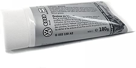

Hello everyone I have a Superb MK3 2017 4X4 with the dreaded squeaking noises from the the front suspensions. During the annual service I asked the dealership to check this issue. They claimed they put lots of grease, but the noises haven't changed at all. After reading about the problem. I read it's recommended to lube the wishbone bushings, and was advised to use this specific lithium grease and not any type of grease with code G052150 A2 which I just boought. Since it's out of warranty, I'd like to try this myself. I added an official document from Skoda (possibly) explaining how to use the above lithium grease to fix the noises. Is there a place where I can find pictures of these transverse links so I can apply this grease? Thanks in advance.

Thank for the summary. I have a Superb MK3 2017 4X4 with these squeaking noises front the front side. During the annual service I asked the dealership to check this issue. They claimed they put lots of grease, but the noises haven't changed at all. I'd liked to lube the wishbone bushings as it's out of warranty, and was advised to use this specific lithium grease and not any type of grease with code G052150 A2 Since it's out of warranty, I'd like to try this myself. Does anyone have a photo of which specific bushings are the cause of the noise? Do I have to release the bolts to apply the grease? Thanks in advance.
