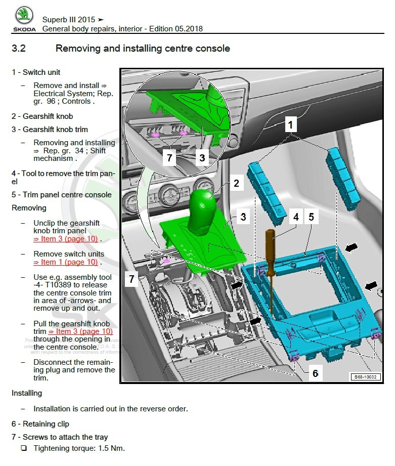

Removing the center console trim is easy. You should start from the rear where the cupholders are. Carefully use thin plastic prying tool to get the first edge out.
I also attached image from workshop manual for illustration.

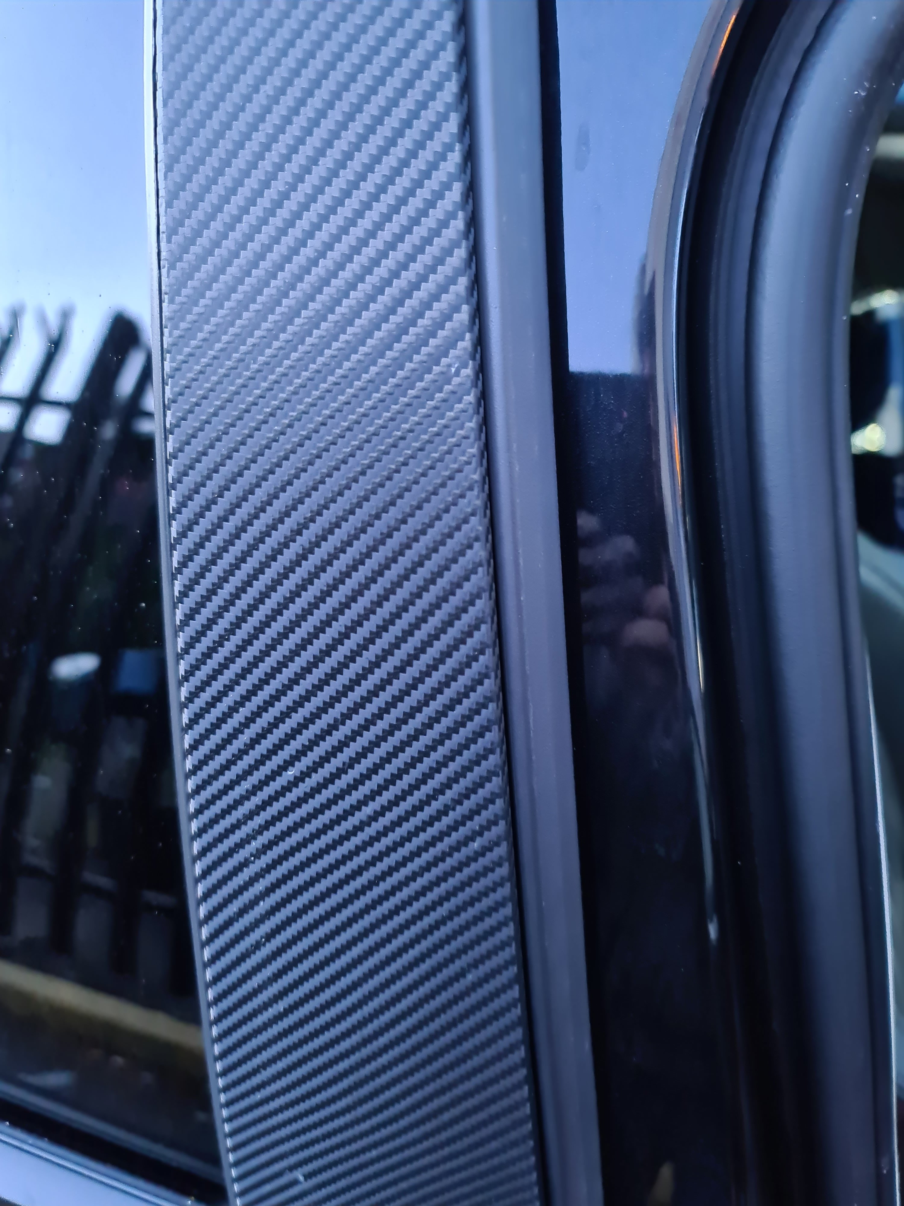

When I bought my superb  a friend suggested I have the pillars wrapped in carbon, as it was in to have limo film on back windows, it seemed a good idea, it looks great
