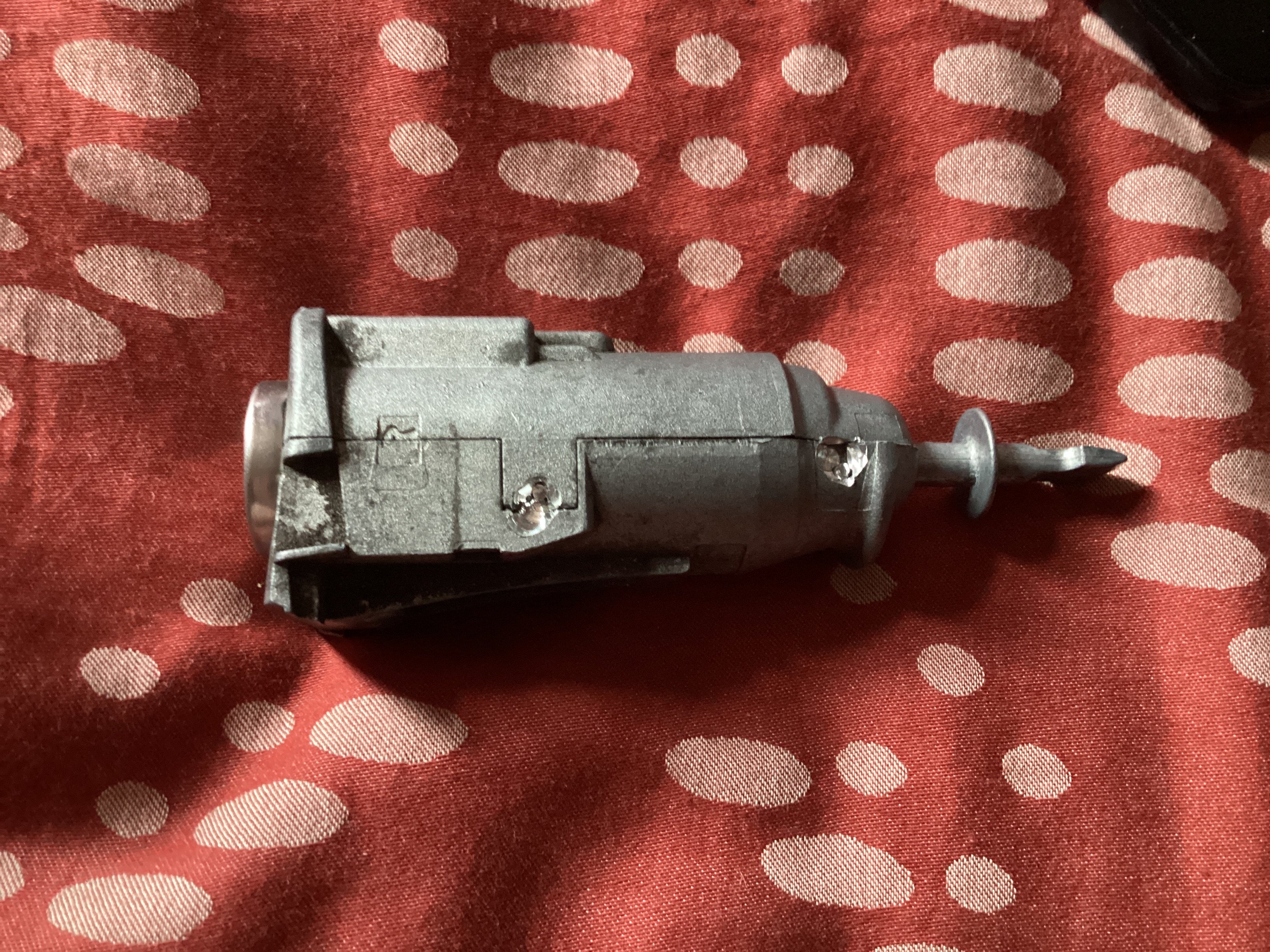

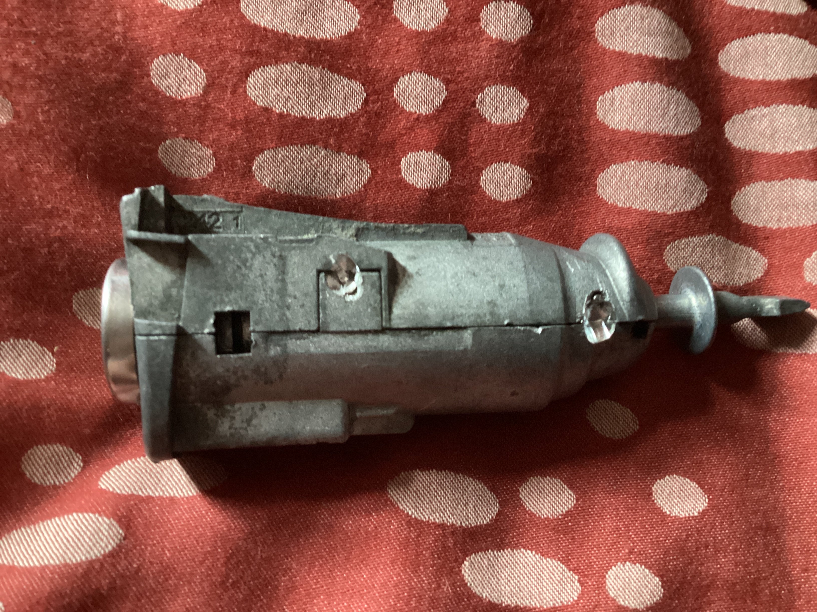

No, parts are really hard to come by, I found just the 1 cylinder barrel on eBay which I bought without a key. I’ve googled and searched everywhere, even aliexpress. I tried superglue and solder to try and attach to the pin, which didn’t work, drilling next to them was my only option.

The lugs will not flex to release the pin. there are 4 very small pins holding the barrel together, they are steel and the casing is softer material, I tried pry the lug over the pin, and it eventually snapped off. I eventually drilled into the softer casing next to the pin, then prised the case open, once opened the pins can be removed with pliers. I have only opened the part I bought which has no key, I’ve not done my barrel yet, but seems if there isn’t a way of removing the pins I will have to drill, again I will have to wait till my daughter returns from uni

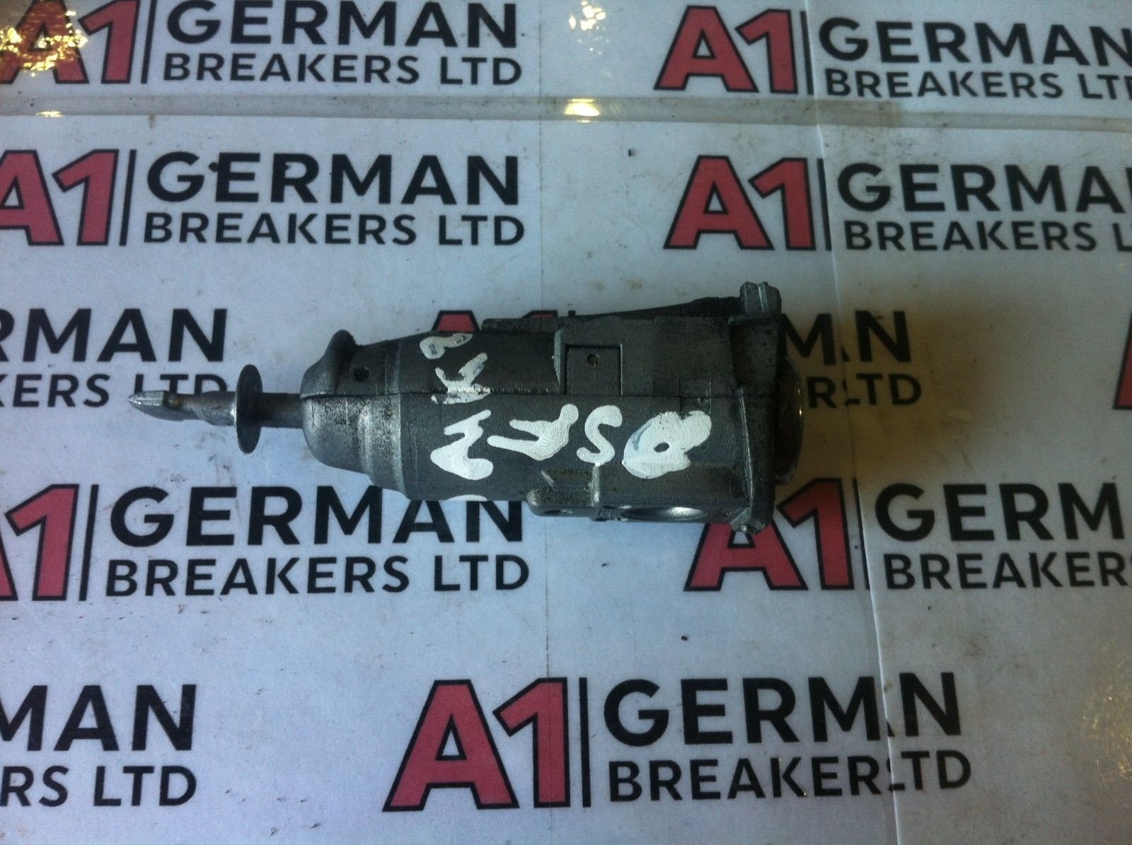

I’ve bought the one I’ve put pictures of , it’s got no key so will need to dismantle it to get the post out. or if possible the key barrel swap over if it can be removed without cracking the case.

The barrel looks a sealed unit, unlike the the earlier model. I’ve bought this off eBay as it matches the broken one I have, downside is no key, so I will need to break it down to get the pin? or does the cylinder inside come out some how? Is there a release anywhere?

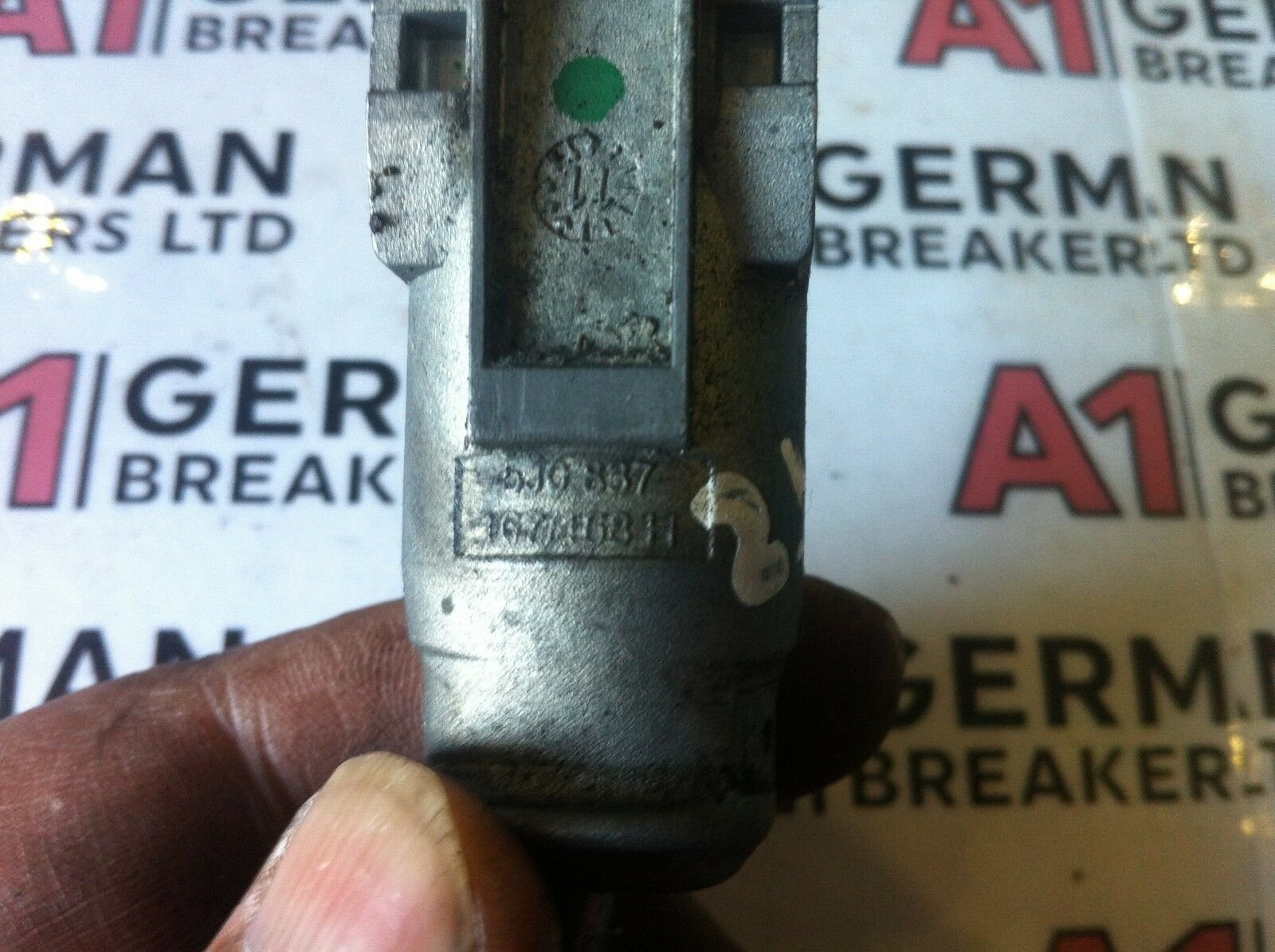

Anyone know where I can get a replacement barrel? Or how to replace the pin that unlocks the door as it’s snapped off Part is labelled 167/168H

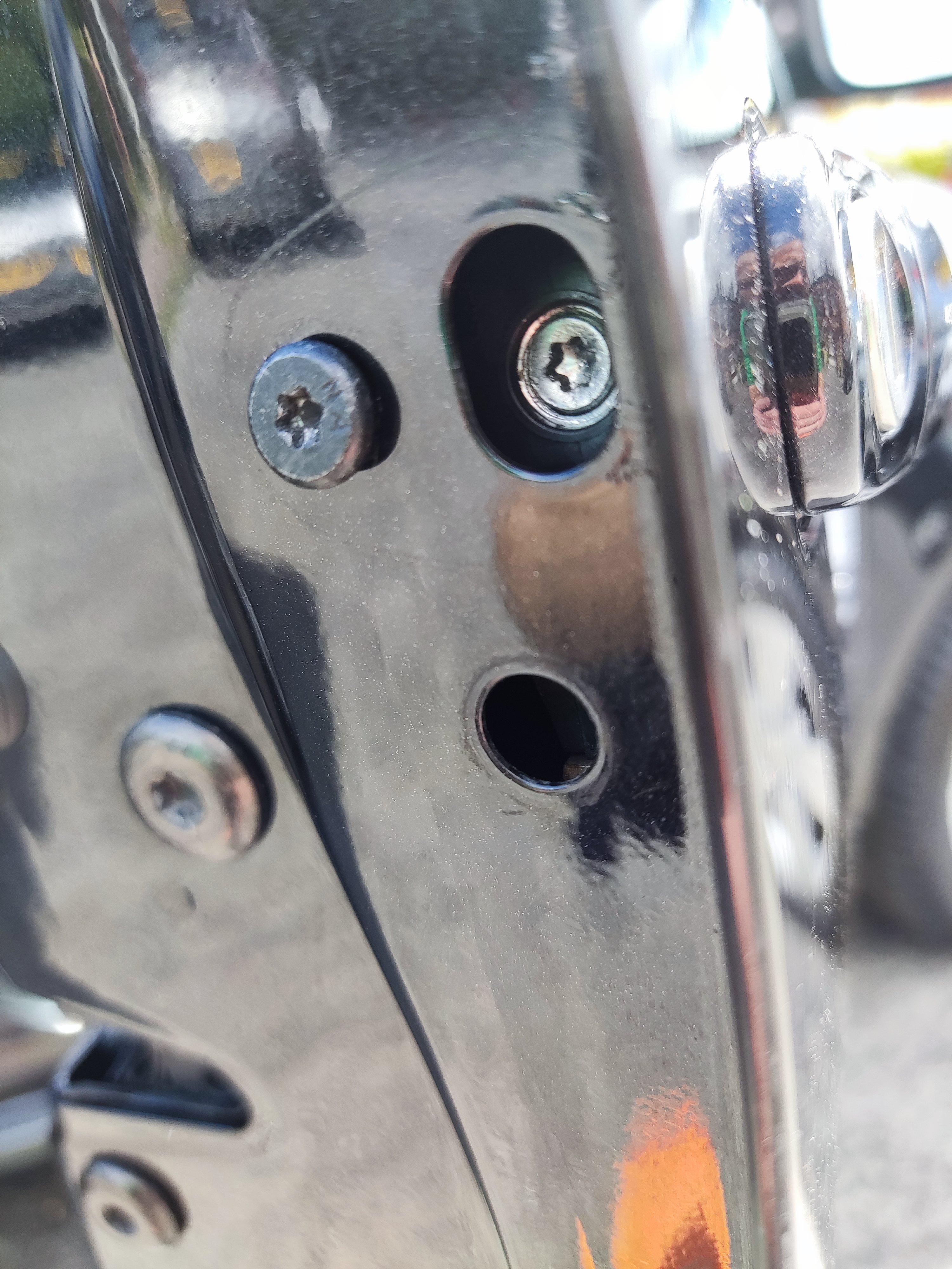

I finally found an answer, this is the facelift model, the top left screw needs to be removed, the top right screw needs to be loosened by a few turns (not removed) , with the key in the lock and turned 90 degrees and the door handle partially open, the barrel should then come out. I will have to wait until my daughter returns from uni with the car to try it. hopefully the pin coming out of the barrel needs replace, otherwise the full door lock needs to be removed.

I am trying to remove the door barrel for 2014 Fabia mk2 , All the videos I’ve found are for a mk1 my problem is the door lock rotates left and right with the key but doesn’t unlock the door. i am a bit wary as the guides state to only rotate the 2 screws by 3 revolutions. I rotated the one top right by 3 full turns. the one top left by about 4 or 5 full turns. the barrel will not budge, even with door handle pulled out the bottom hole does not have access to a screw. any help appreciated.
