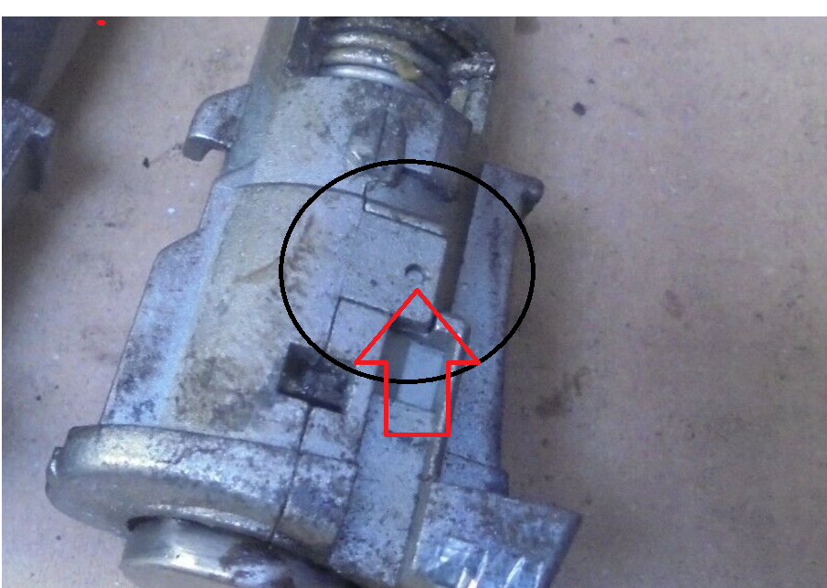

does anybody know if the key housing cylinder can be removed, there is a small hole on the side but can’t see a clip or spring to indicate it can be removed.
I’ve seen plenty of strip downs for the MK1 but nothing for the MK2.

Looks to me like this flap of metal must bend upwards off the 'pip' of the other half that's in that hole, and probably a symmetrically opposite one on the other side, then the whole thing falls apart??

20 minutes ago, nige8021 said:
I recon that once that fancy outer case is off it's the same basic lock unit that has been used on most VAG models since 1994 and can be repaired using the same kits on eBay ??
I’ve bought the one I’ve put pictures of , it’s got no key so will need to dismantle it to get the post out.
or if possible the key barrel swap over if it can be removed without cracking the case.
The lugs will not flex to release the pin.
there are 4 very small pins holding the barrel together, they are steel and the casing is softer material, I tried pry the lug over the pin, and it eventually snapped off.
I eventually drilled into the softer casing next to the pin, then prised the case open, once opened the pins can be removed with pliers.
