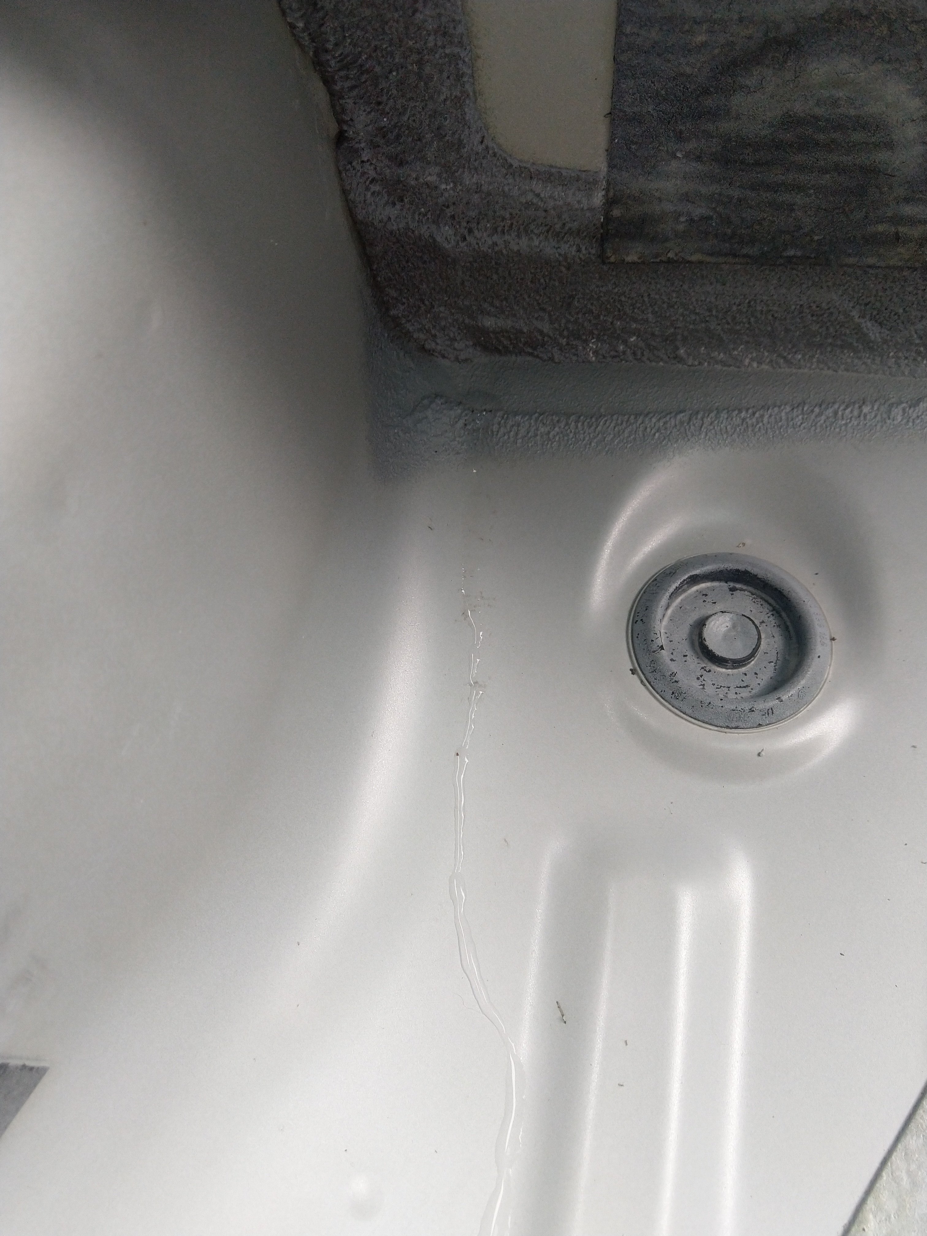

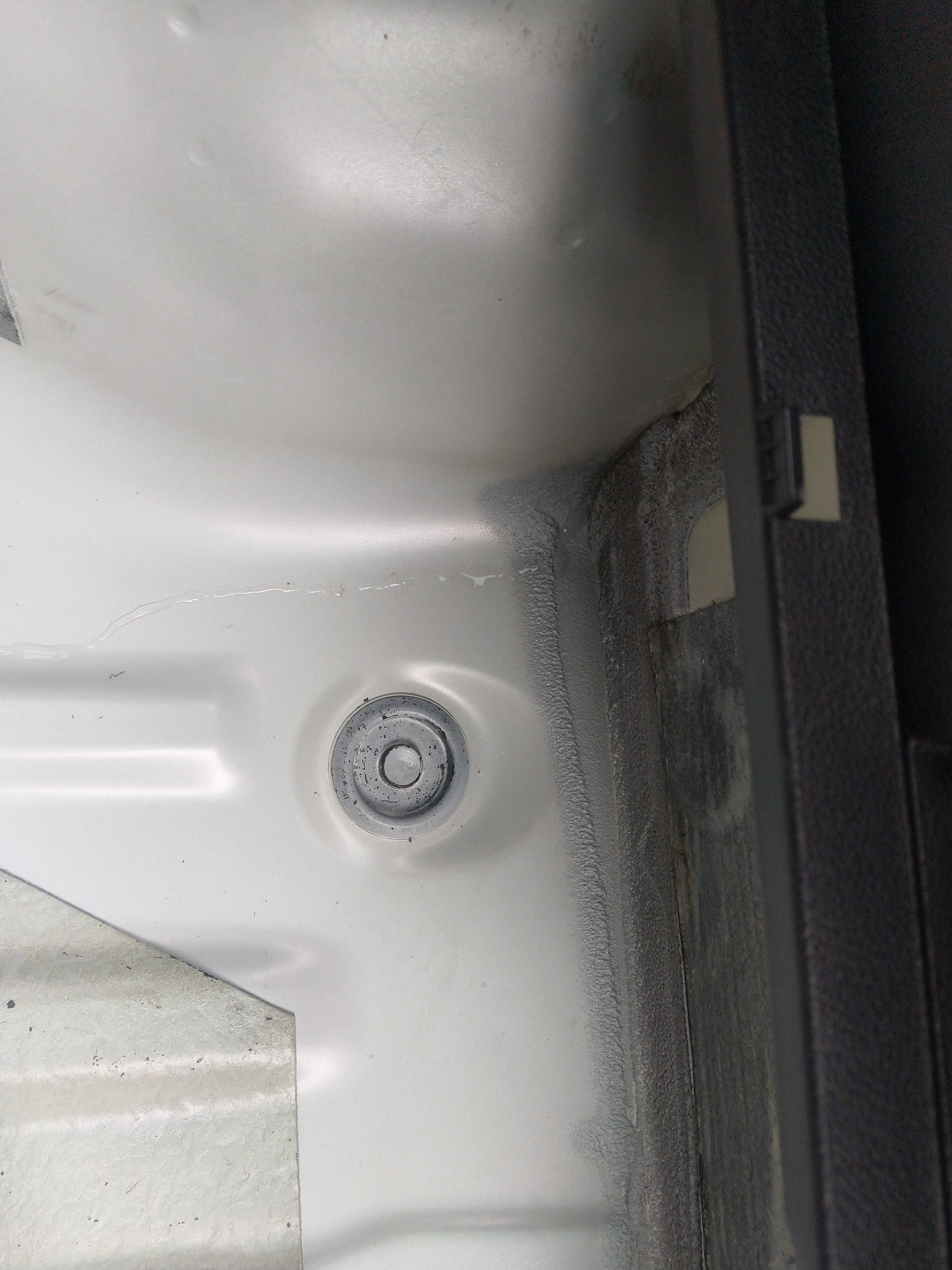

  1. Above advice is logical. I have looked at schematic of rear bumper assembly to identify the various components. Water rounds down side of tailgate and then drops behind bumper. Below bumper is the cross member located behind the crash bar. I cannot see any water flow when I am under car but it again seeped through sealant on inside as per my photos. I cannot reach outside area to check for poor sealant so have applied a silicone bead inside and will monitor. If sealant has failed on outside I wonder why but I cannot see a big risk in only resealing the inside. Thanks for input.

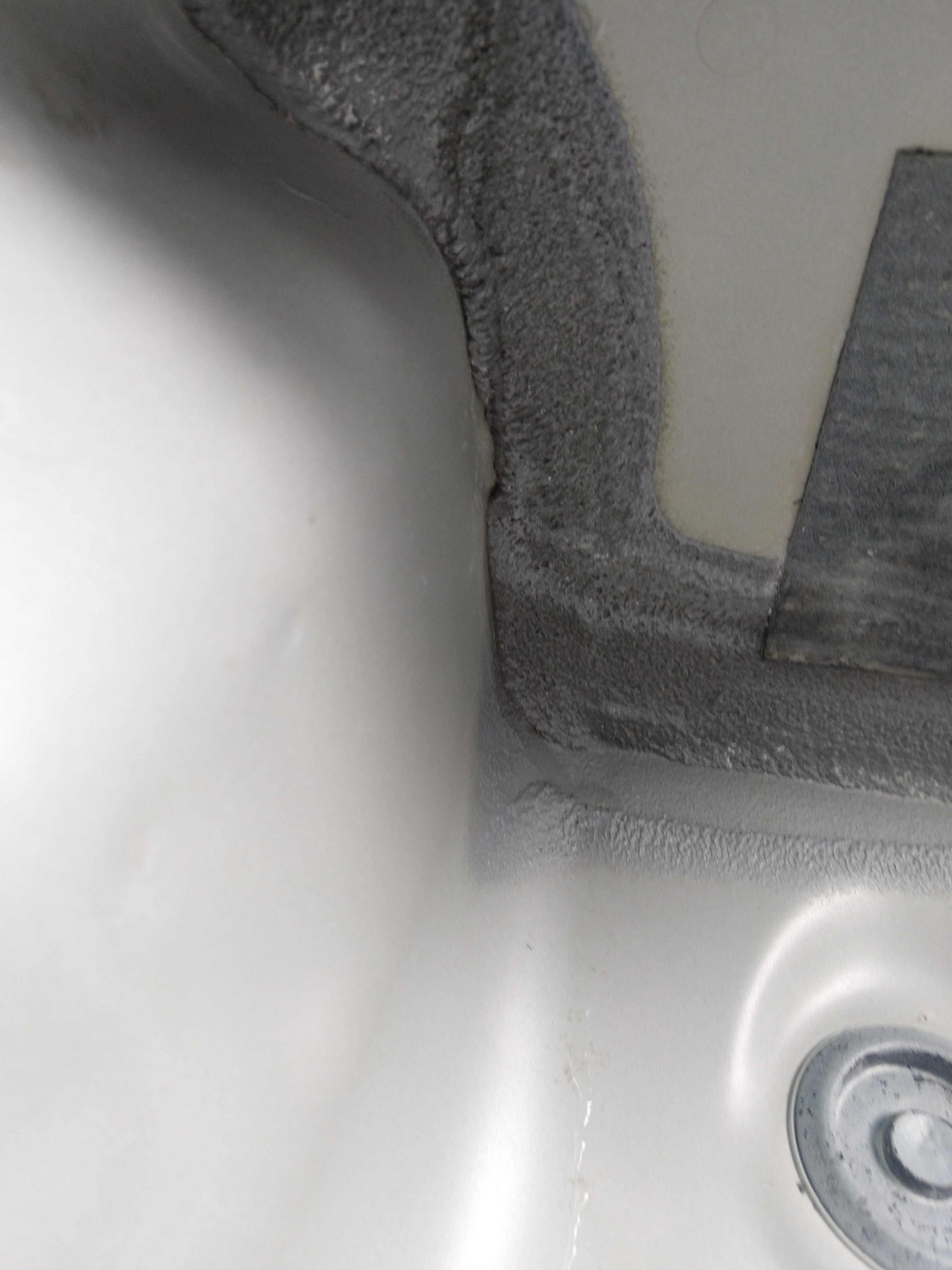

  2. I have posted on this topic before but have now identified where water is leaking in. Three images are of the right hand corner of underfloor cavity. Water is coming from behind sealant bead on vertical edge. Tonight after about 1 hr of light rain water has accumulated and can be seen in photo. I visited my dealer yesterday but they had no answer as to the source suggesting I keep investigating. I want to know what is behind this panel? Looking underneath bumper I cannot see any thing that might be a cavity nor workout where water can come from to penetrate the sealant. I could add more sealant but clearly that doesn't address the core issue. Is there anyone who can give me an insight into the body structure on the offside rear please.
  3. I have made little progress. Dealer reviewed towbar fitting and confirmed everything in place and done correctly. They had no suggestions for source of leak. I have monitored and water continues to accumulate. Today I looked again and after I had cleared pooled water I noticed a seepage from the right-hand corner of the boot area (estate). There is sealant there across the rear edge. It is as if there is a stored source of water behind the sealant. As far as I can tell behind the rear bumper is the main body of the car, does anyone know what the structure is and if there is a potential route for water. When I bought the car nearly 12 months ago some damage to the left side of the bumper was repaired. Either the car was reversed into something or the car was hit from behind, damage was more cosmetic but I am wondering if there was more to it. Any further thoughts welcome.
