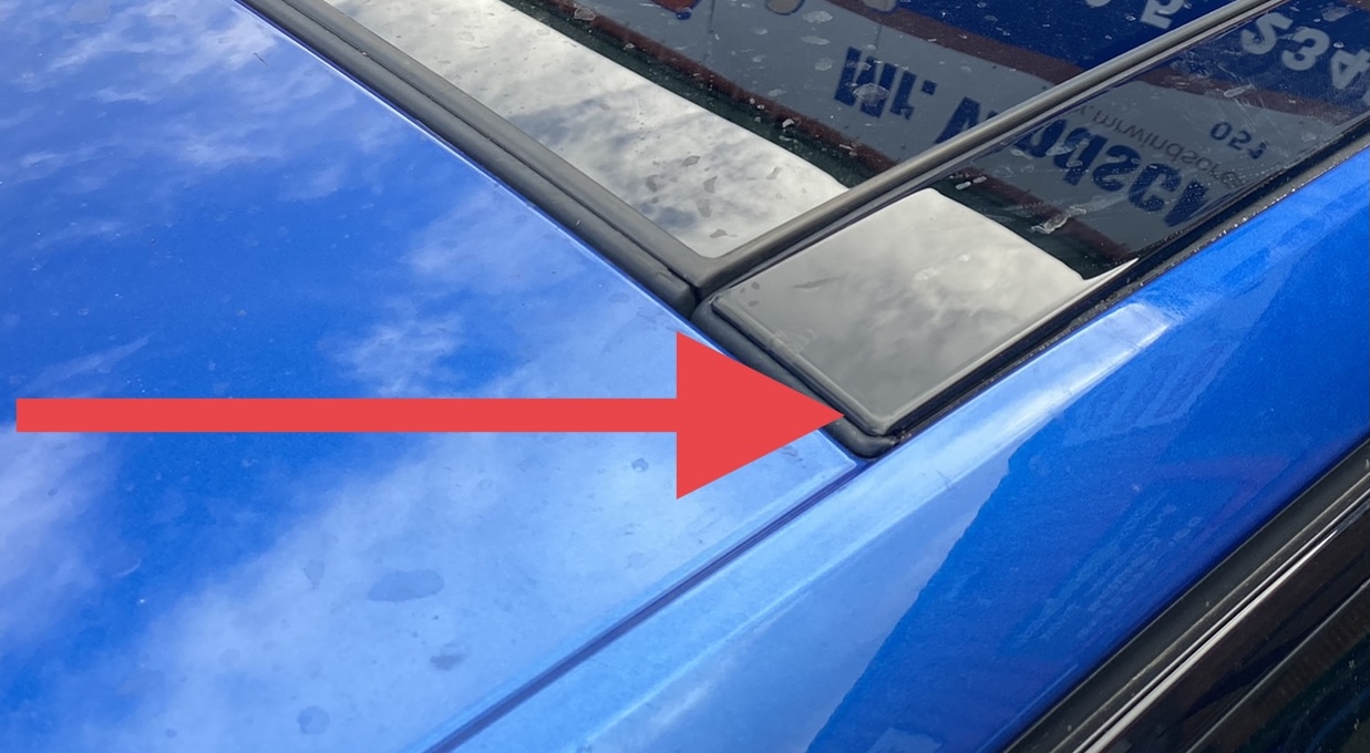

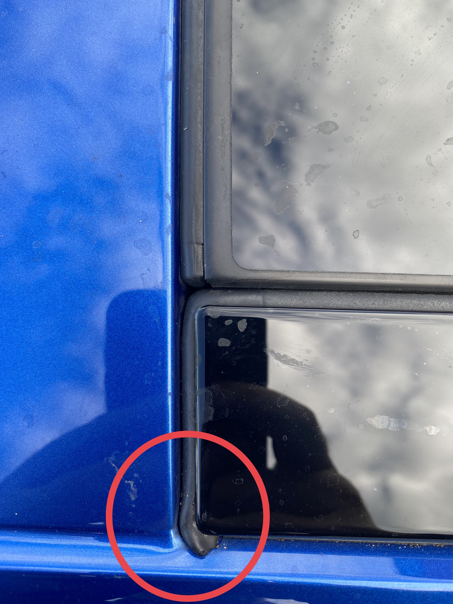

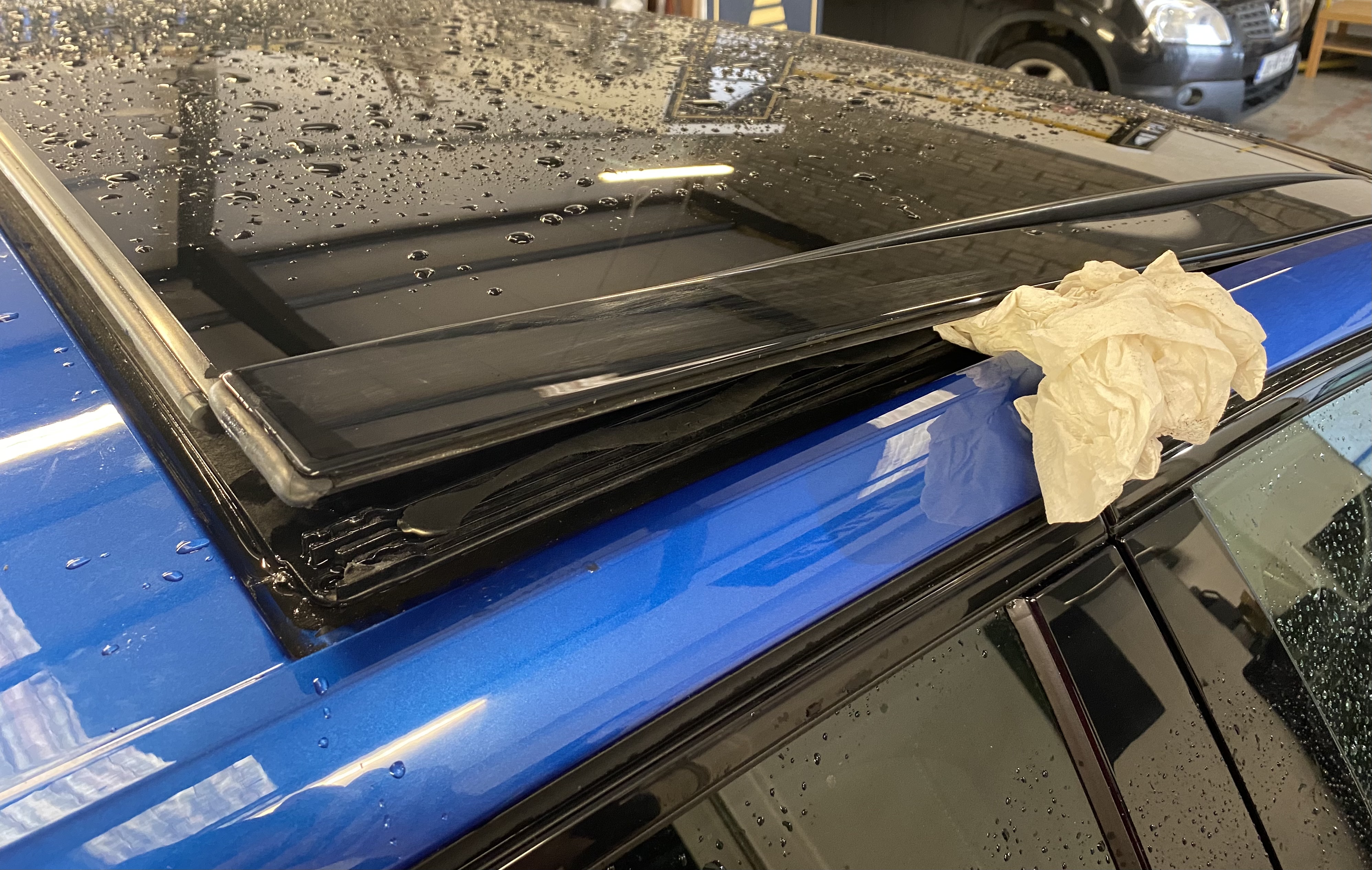

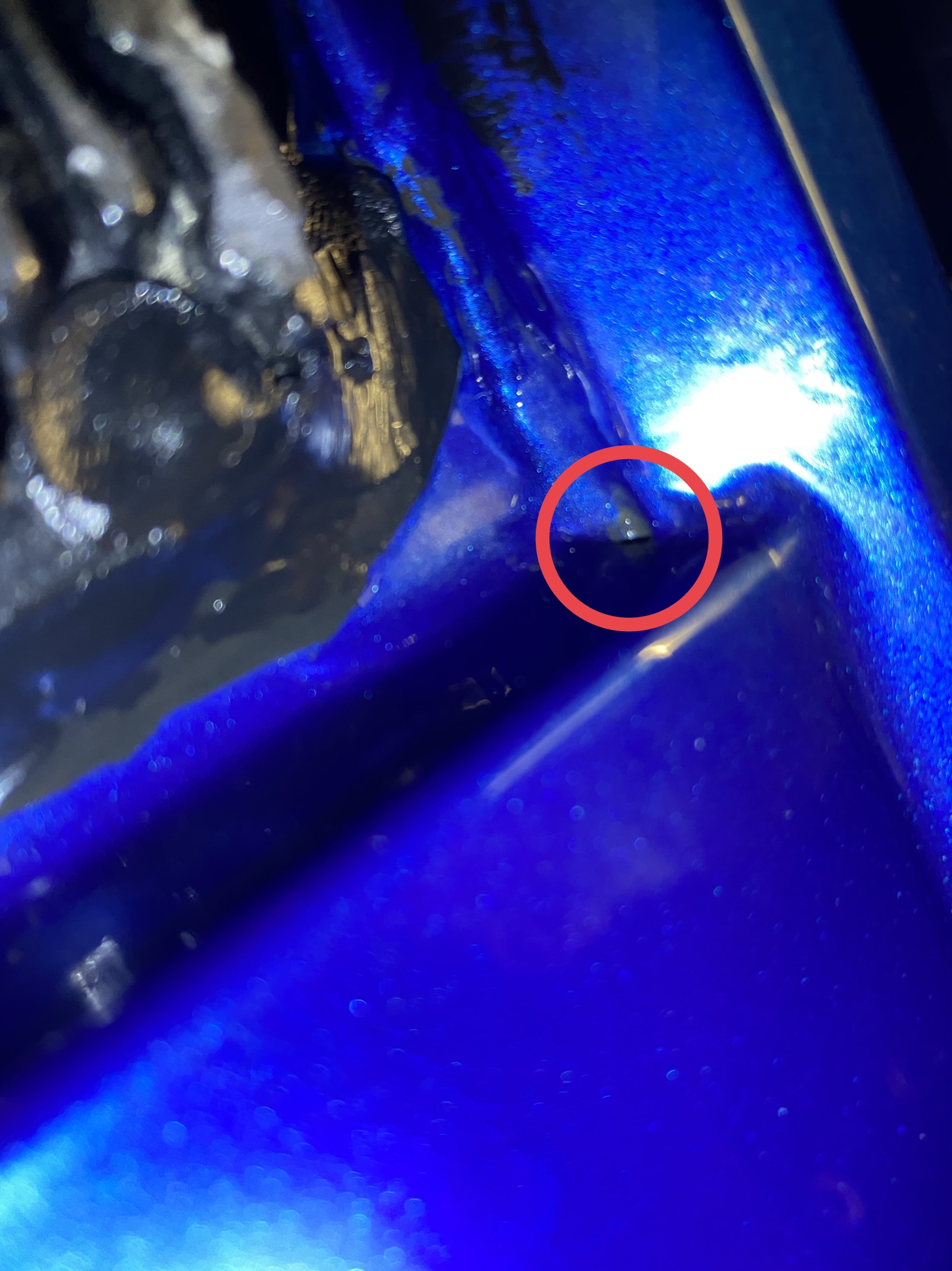

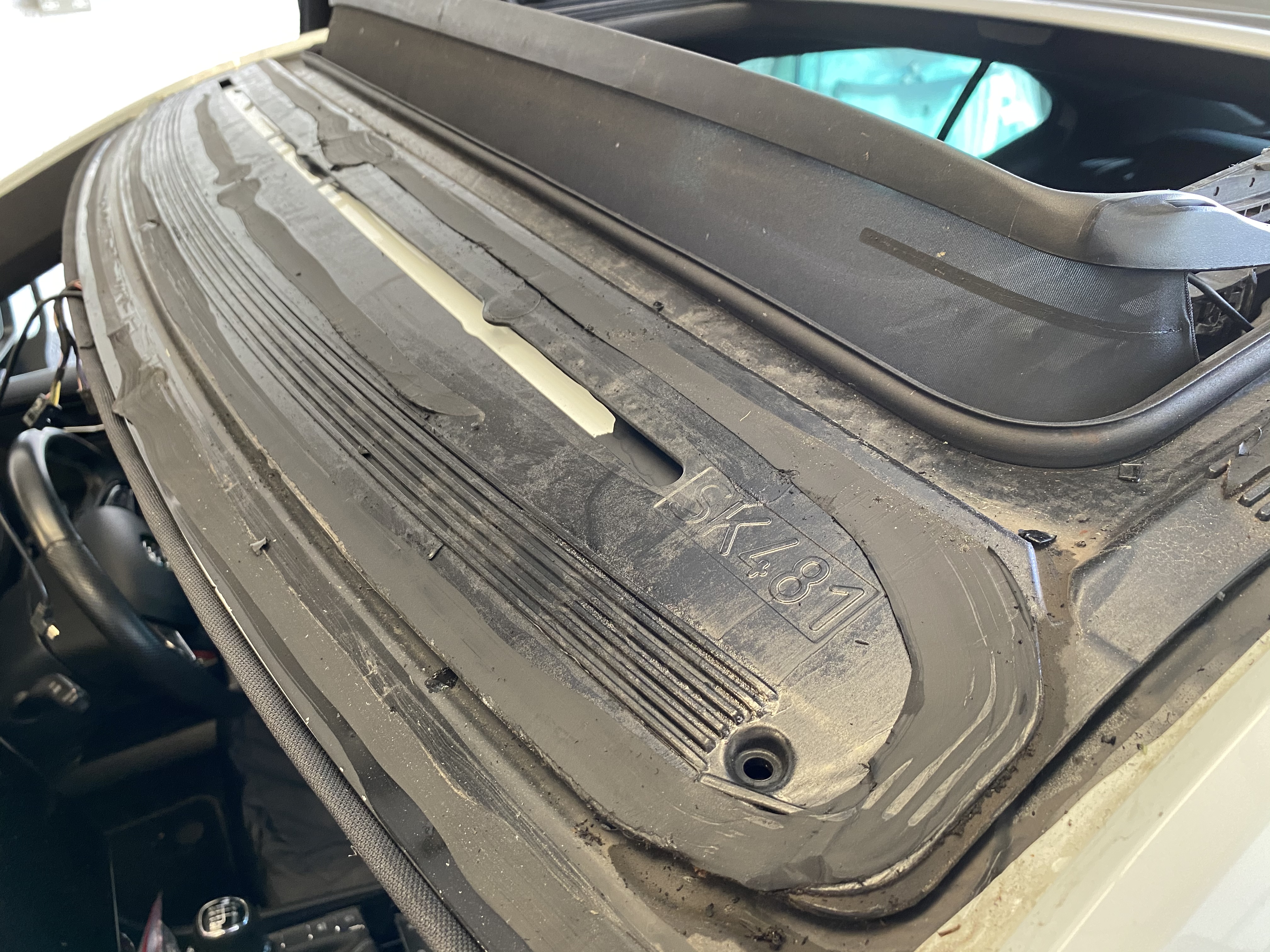

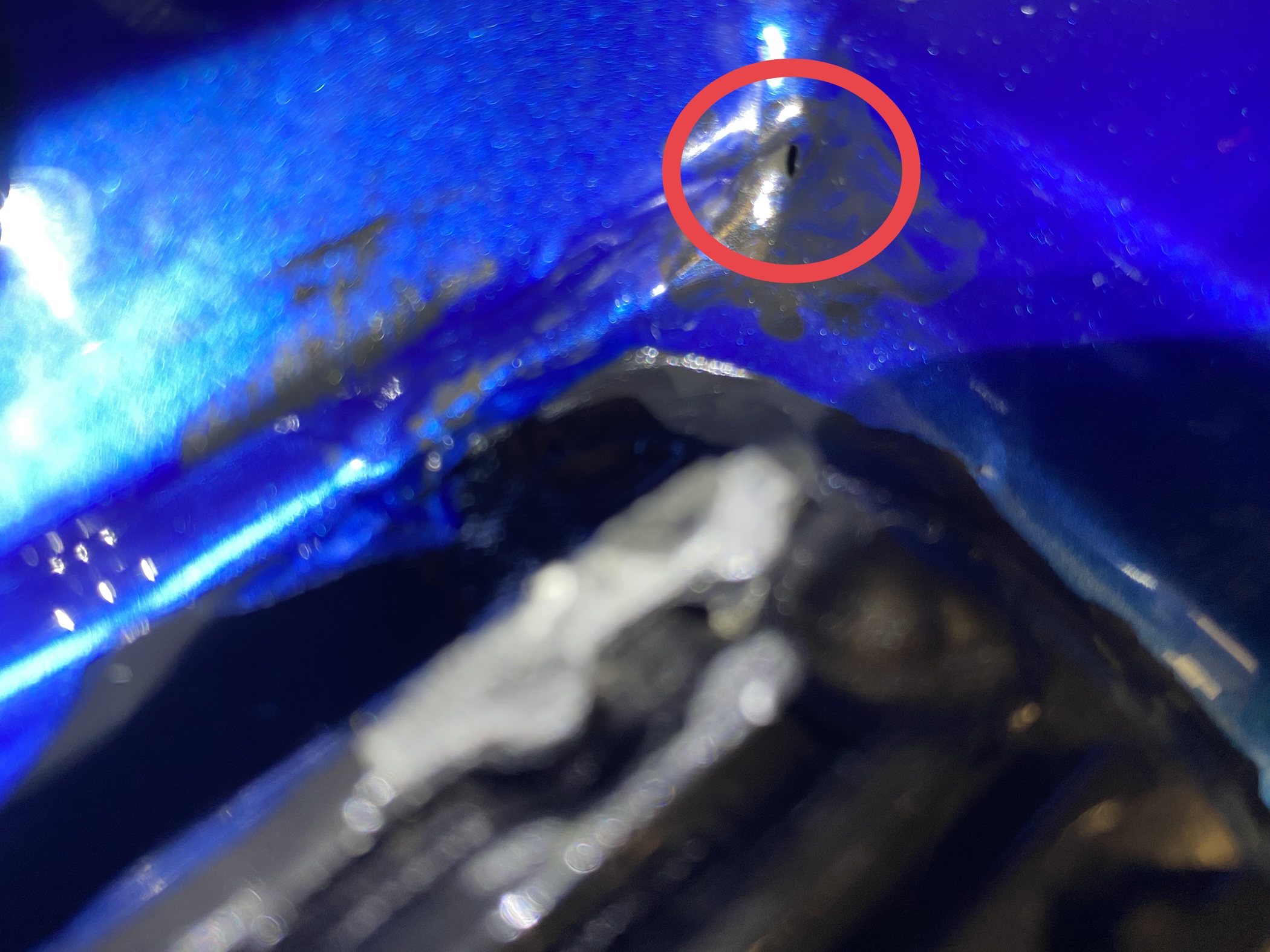

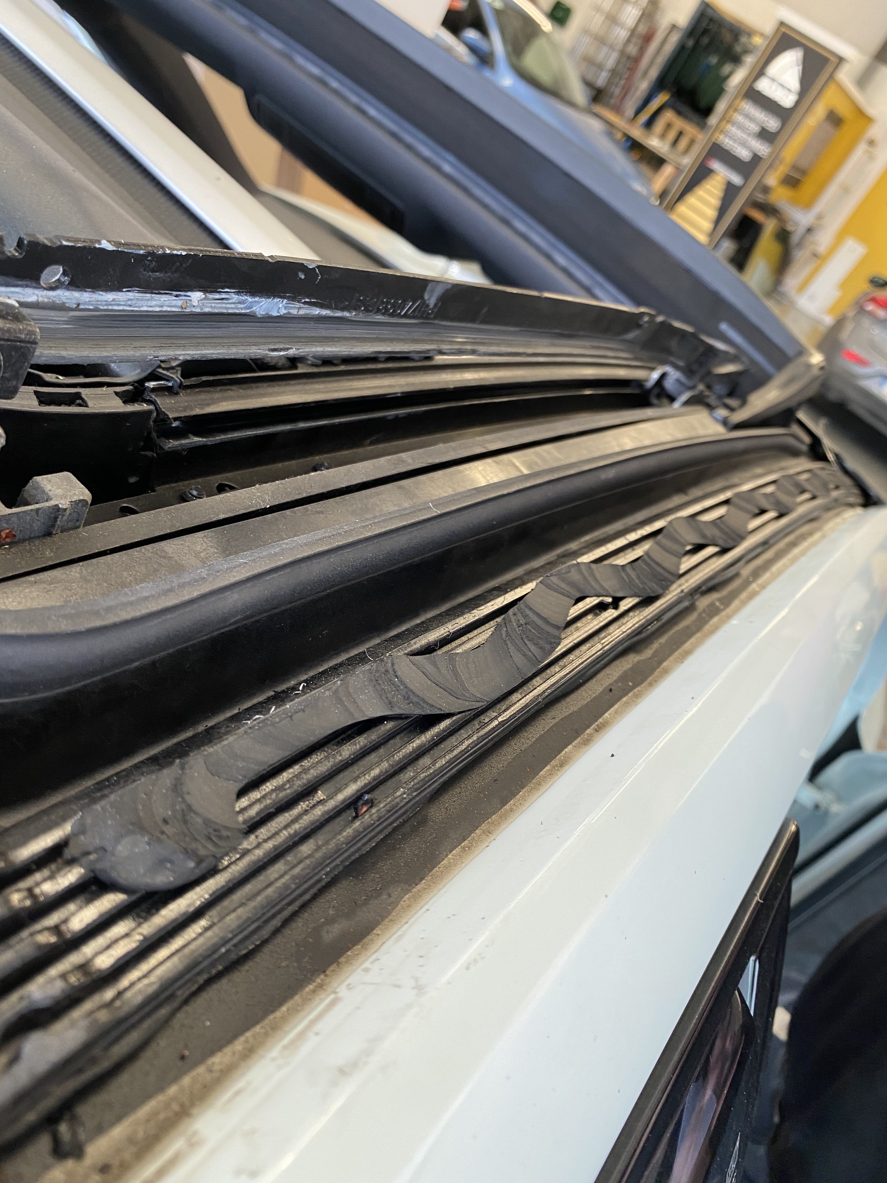

  3. Update on this guys. Might help someone else. it wasn’t the infamous sunroof hose after all. Which I always doubted anyway as the roof cloth was always bone dry. Anyway noticed the rear was soaking again and so decided to do a more thorough investigation. Traced it back to the sunroof area for sure by doing localised water tests and watching for the water coming in ( which was coming in at the right hand rear, in the quarter just behind the door) Checked all runoff pipes and poured endless amounts of water into the sunroof channels and it came pouring out over the wheel wells as it should. No water coming into through the rear quarter. Closed sunroof again and poured water over it and water coming into the car. So it must be the sunroof subframe where it’s bonded to the roof. Could be a hole in the seal. That needed removing the plastic surround to get a better look. Did that and couldn’t see any obvious gap in the seal but when I poured water there it vanished quickly and poured in at the rear quarter- so that was the problem ( we thought). Anyway, primed and sealed the subframe. Left to dry and water tested. Water still coming in 🤦‍♂️🤯 Eventually I found a tiny hole in the body of the car, right in the corner where all water would almost funnel to and then enter the roof skin, travel along the skin until it found an out point which was where some plastic wire holders where clicked into the body frame in that rear quarter panel. Hence why no wet roof cloth. Sealed the pin hole. Poured water for 20 min - not a drop in anymore. 😎
  4. It’s plastic and it’s easy enough to remove by competent windscreen fitters and the new one just bonds down using the same sealant used to bond in a windscreen. It is a pretty easy job really, it’s just a plastic surround. I have pics of one removed. Guys car was parked near someone that was welding and he got spot welds all over his car. Entire repaint and every glass and sunroof replaced.

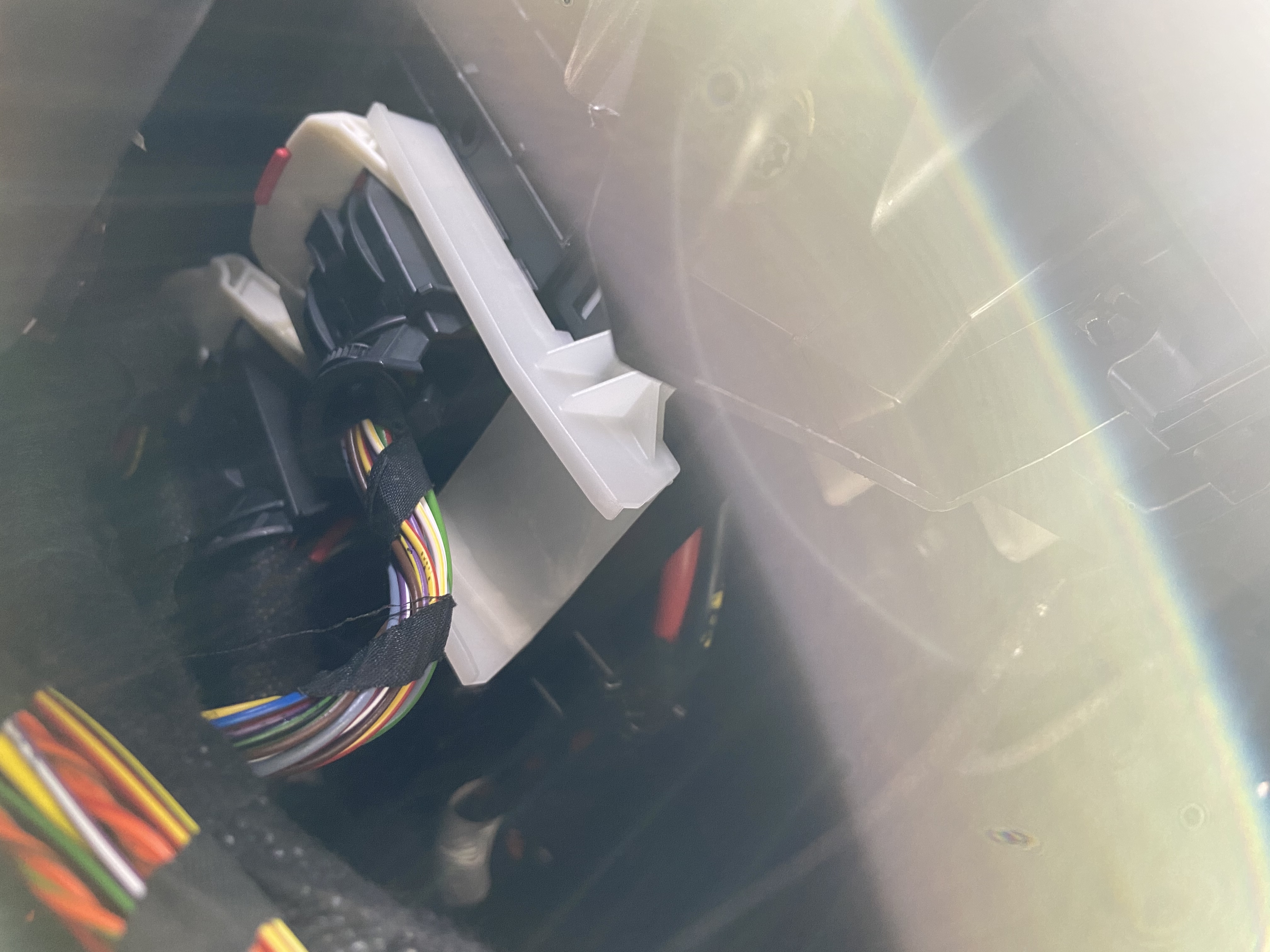

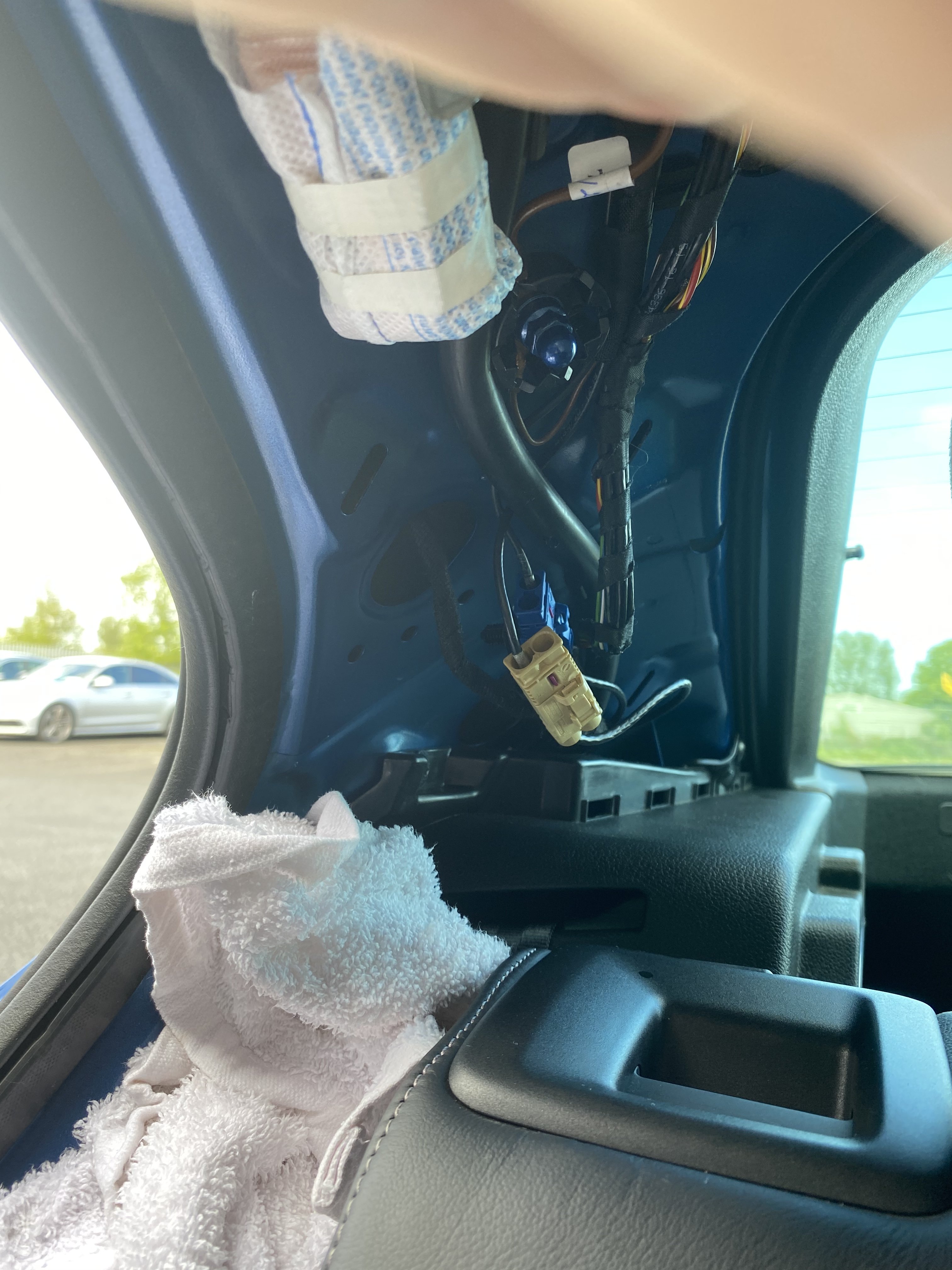

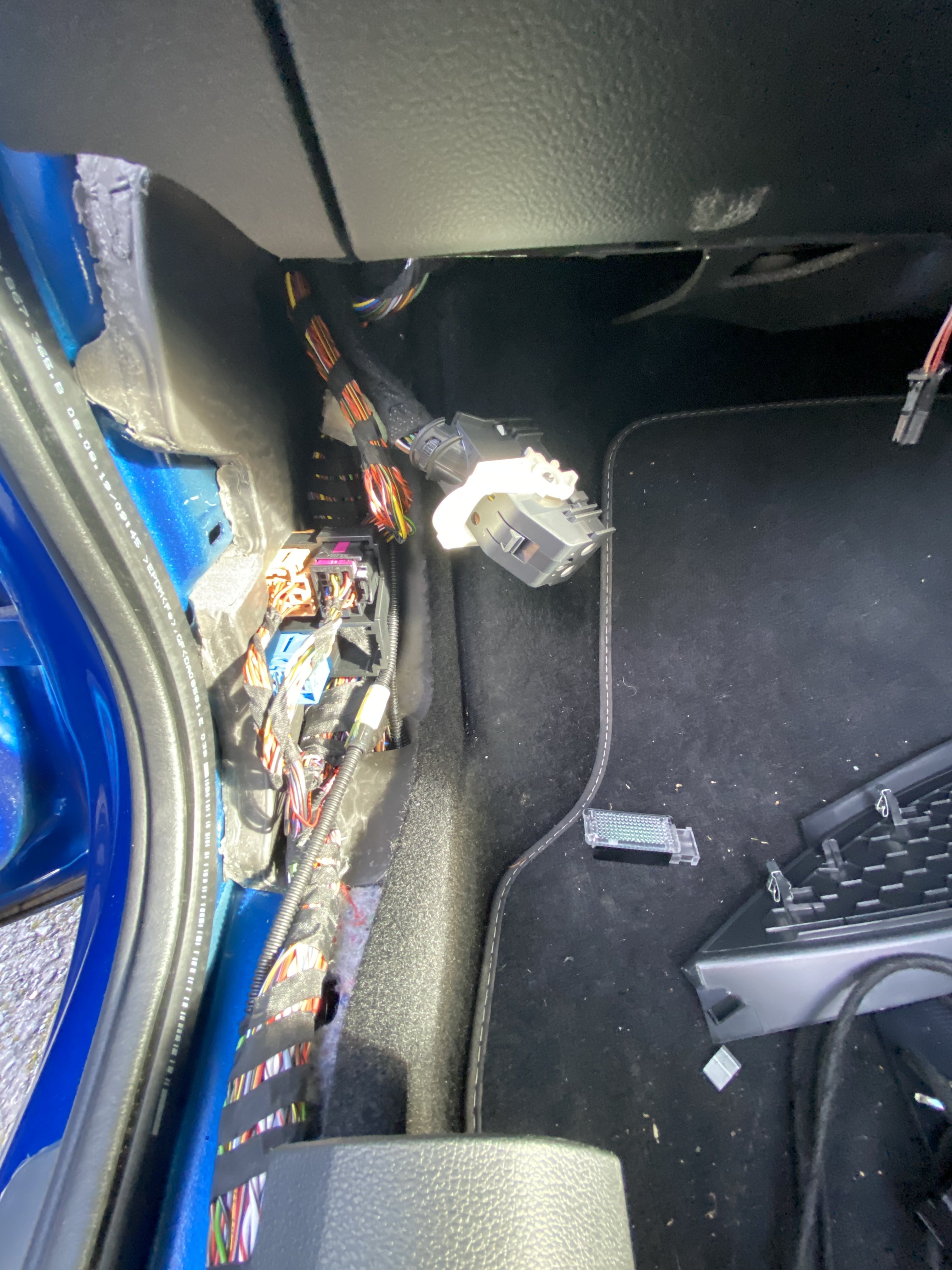

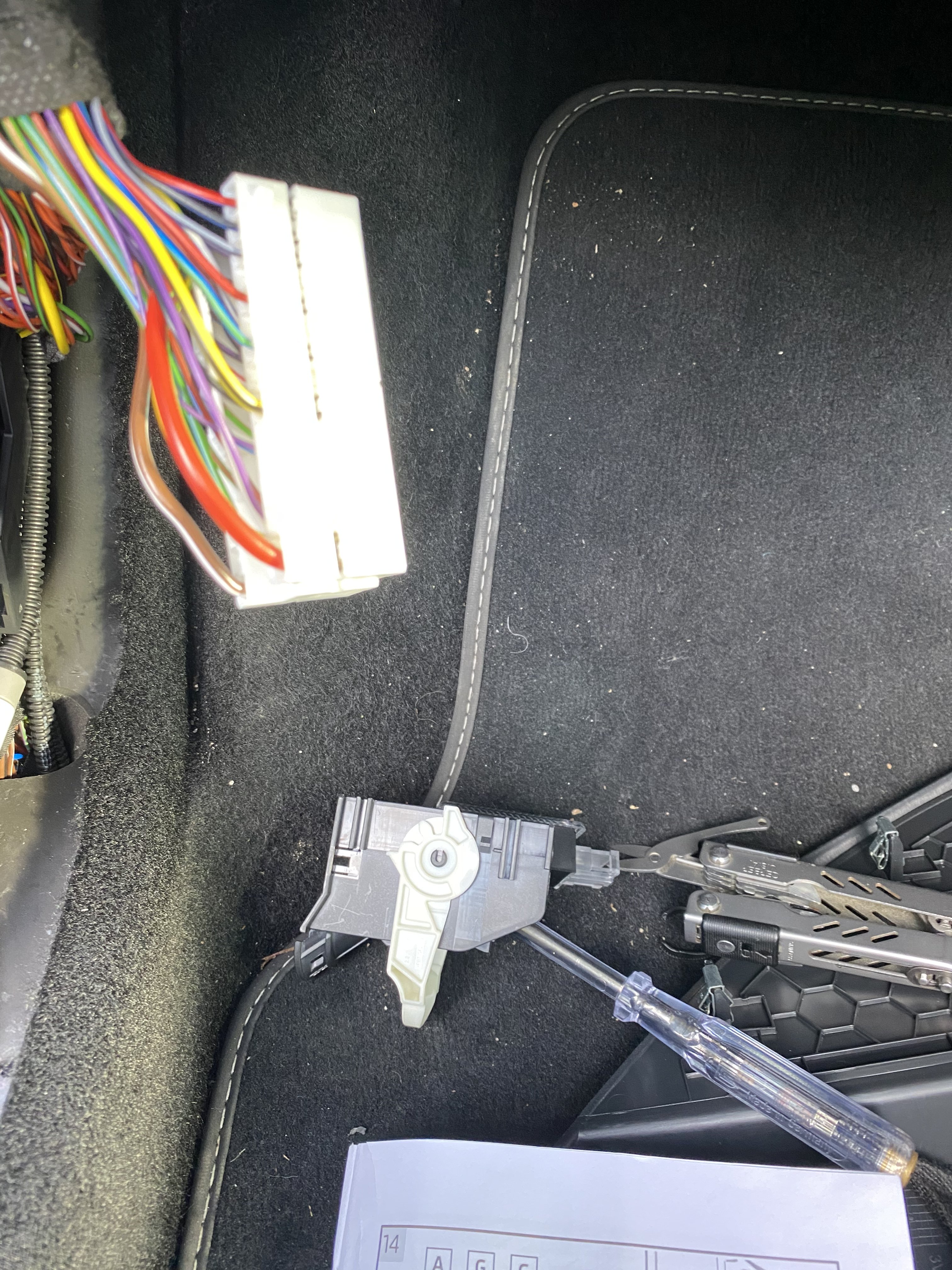

  8. Fitted mine today - more of an ordeal than I thought, but in for a penny.... Rear Seat out - Not to bad really. Trim removed or lifted enough to get the new cable in. First thing I tackled was the wiring to the BCM as I though no point running in cable etc and then not be able to wire it in for some reason, so I tackled the wiring first. It is tricky. You'd want some experience of working with electrical connections in a car, harness's etc. as it isn't explained in great detail in the instructions so a certain amount of know how is presumed I guess. BCM located on passenger side. Remove the trim in the left foot panel (1st Pic) but dont attempt to unplug the Connection C from the BCM from here. Instead remove the cover on the door side of the dash - (Pic 2) Now you need to disconnect the connection nearest too you, that will be Connection C - (Pic 3) Dangle it down into the footwell - (you can see it in Pic 1) Now you need to slide the connectors out of their harness (Pic 4) Here you can see the Harness on the floor and the connections in white. Next remove the two wires as described in the directions using a Terminal Wire Remover (Pic 5) The first wire was OK, the second wire was smaller and a bit more difficult to work free. I removed one wire first and then inserted it into the new connector provided before removing the second wire, that way I was minimising the chances of them touching when out. That was pretty much it when it came to wiring - So you'd need a little bit of know how about unplugging connections. I know this sounds simple, you just unplug them right? Well yes and no. They will be held in by a locking tab, so you need to release that first. In this case just pull back on the white tab in Pic 3 and it will also slide the plug out at the same time. Make sure to click this up fully when plugging back in. If this is unfamiliar to you this job might be a bit much. Also I wouldn't attempt unless you have Terminal Wire Removal tool - they are cheap as anything but you may need to order online somewhere. Everything else is a matter of removing trim and running cable. No big deal. And then placing and sticking the actual sills. Again not really any drama.
