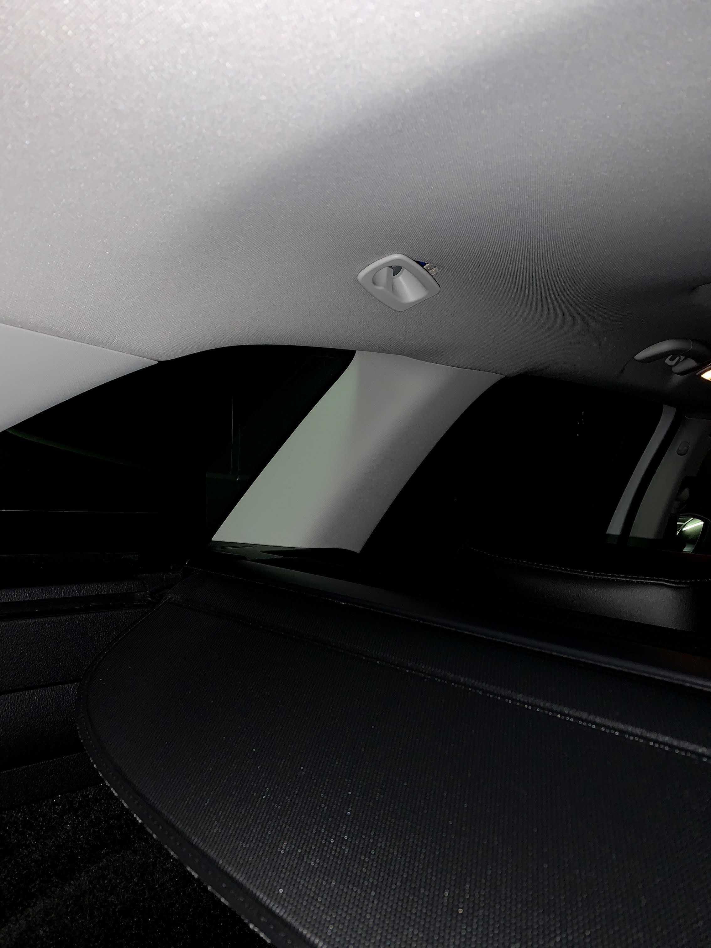

  6. Does anyone have, or ever had this thing where the boot opens and closes super quick, over and over ... for 5-10 seconds? Its random and is doing it on its own. I was thinking maybe a fuse? When I say quick, I mean .5 sec. intervals. Open / Close / Open / Close etc ... for sometimes 5 up to 30 times. Two things to note: The first time I parked my car outside and also I used the remote warmer. (last night it was about 5 C) Hadn't happened to me before today. Thank you for the feedback - stay well. Best, DB
