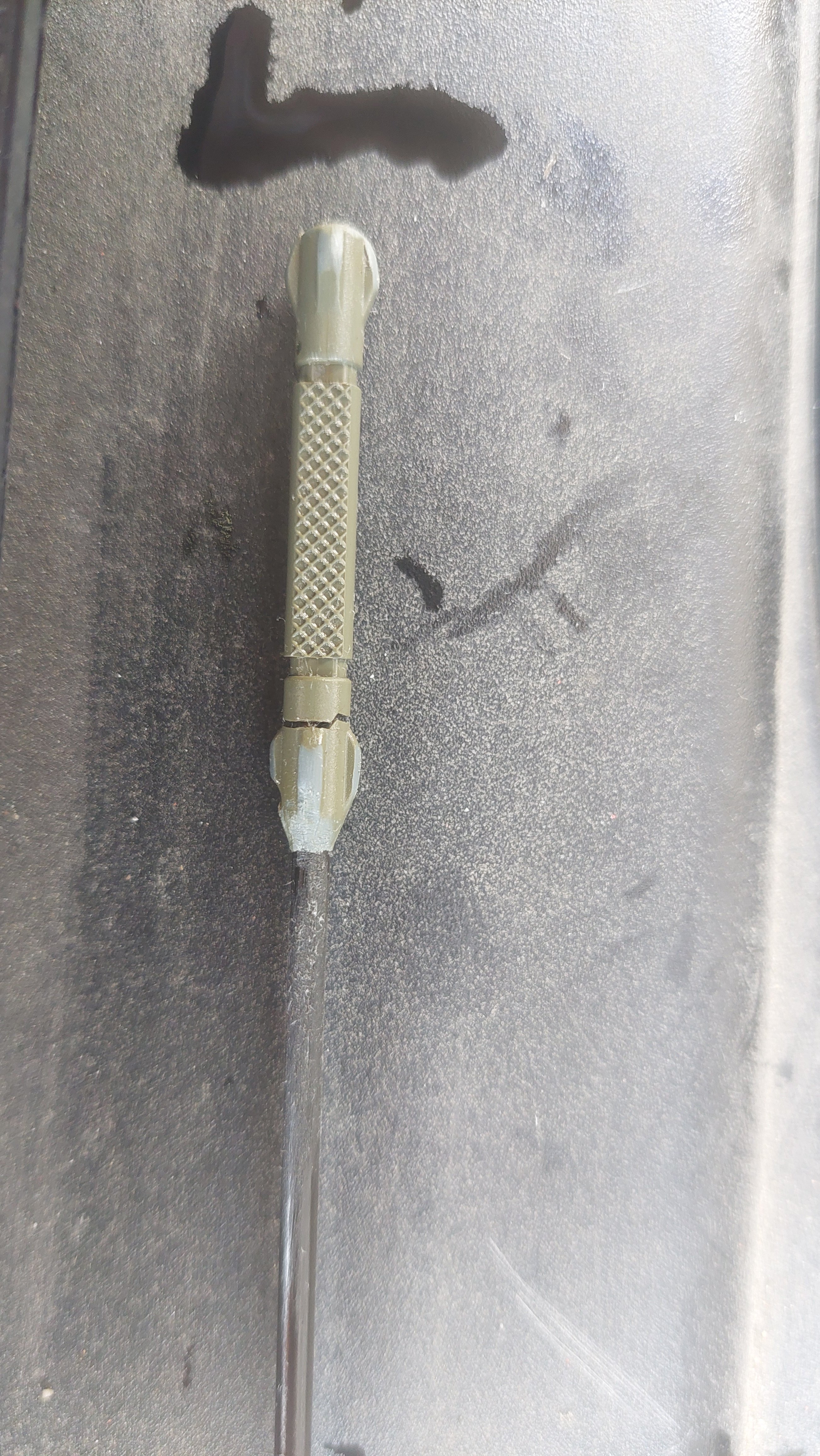

  1. I dont really care about the left overs since i never need it. (The engine is burning very very little oil betwin services). But i do not like them following official recommendations.
  2. Literally sucked out 2.5 dcl of oil. Should be less critical now. The problem is i leave for holiday in the middle of the night so no time to drive back to shop. But will let him know next time. I always supply my own oil, even to official skoda service, because it is much cheaper and and i know what exactly im putting in.
  3. Nobody noticed it. I was there. He sad he used all the oil.
  4. Here is clean Here is dipped
  5. As said hard to see. I would say it is up to the top of plastic part.
  6. That dip stick is not easy to read.
  7. Hello. So i had a oil change and the mechanic put whole 5l of oil in 1.6 tdi engine although it suppose to take only 4.3l. Can this extra oil cause problems or is it going to be ok? Br
