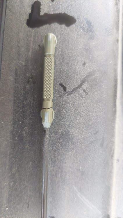

Here is clean

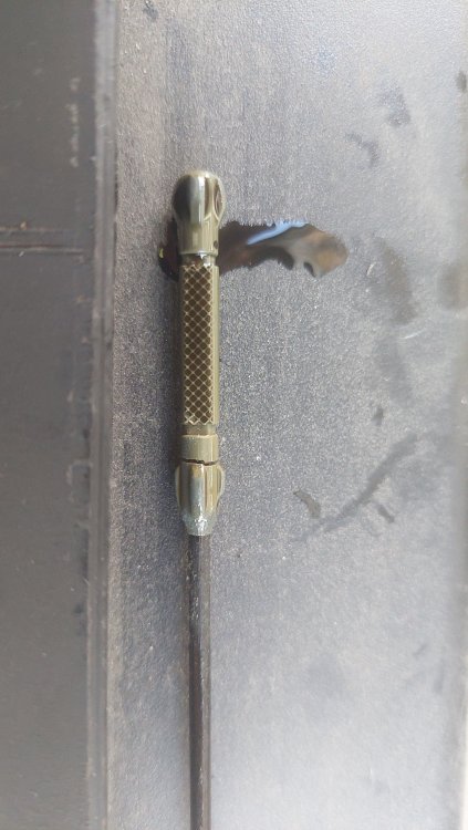

Here is dipped
19 minutes ago, Motion said:
Here is clean
Here is dipped
At a guess, around 1/2 litre too high, might not be critical - but excess oil does need to be extracted ASAP - and the question needs to be asked, why did your mechanic not check oil level was correct on completion of the service.
Easiest way would be to get a thin tube and suck it out of the dipstick, a lot less hassle than the other options. I usually use extraction pump or brake bleeder works nicely if you get oil warm.

Did you notice the dipstick is also cracked?

I was not looking at the pictures but I have now.  When they break up it is more than a PITA.   So the OP can say if the mechanic noted it.
Nobody noticed it. I was there. He sad he used all the oil.

Literally sucked out 2.5 dcl of oil. Should be less critical now. The problem is i leave for holiday in the middle of the night so no time to drive back to shop. But will let him know next time.
