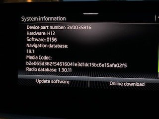

  1. I have had a number of update on the Infotainment system which do appear to have solved the problems. However i still experience the following on a regular basis . Radio changes station from Talk Sport to Radio Liverpool. Looking for some answers I read that if you have a dash cam with aa rear camera ,this can cause the problem due to interference..... On the MySkoda app the Doors & Lights indicates the windows are closed when they are open. Also the app sjhows locked even when the boot did not close correctly and could still be opened.
  2. Hi Kris, i had exactly the same problem on my Kamiq purchased back in September. I was. Following the instructions and contacted customer service. to cut a long story short, the fix was an upgrade on the infotainment system. A previous upgrade and a rest failed to cure. book it into you local dealer its a 20 min job
  3. Problem now resolved Ot took 2 software updates (I suspect it was actually firmware updates) to resolve the problem. Took far to long to resolve, 3 weeks
