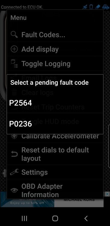

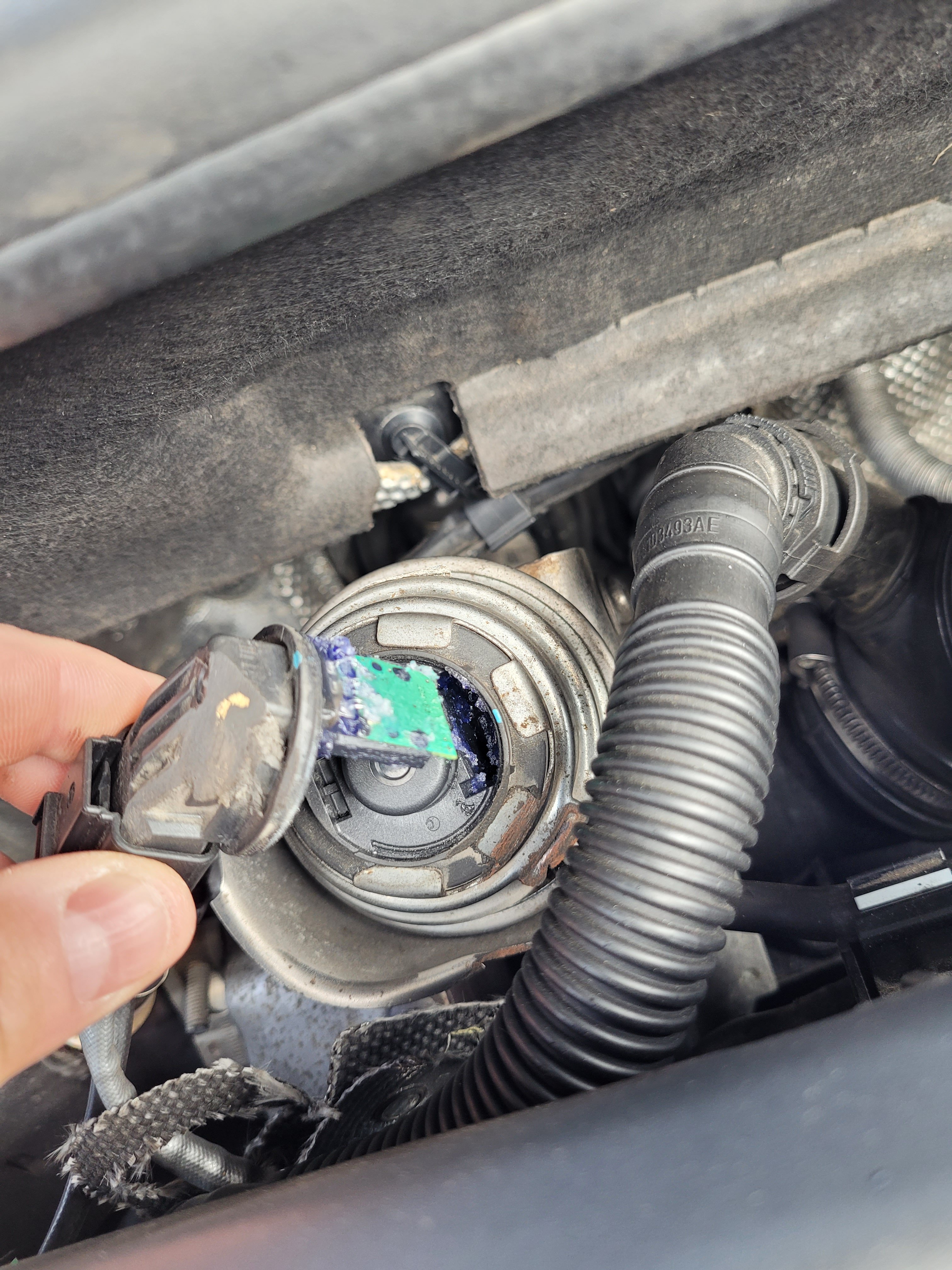

  4. Hi guys. Any info on what could of happen to the actuator. Skoda superb 2011 2.9 170
  5. Hi guys. Any info on what could of happen to the actuator. Skoda superb 2011 2.9 170
  6. Tried everything and my mechanic said could be a wiring issue somewhere. Best about it now can't get anyone to look at it😔😔
  7. Hi All!! Looking for advice.....same issue with my skoda superb 2.0 170 2011....mechanic changed all senors but still keeps going into limp mode, was able to reset and drive for couple days and then would come back on and now comes on straight away. mechanic think could be electrical issue but by god am finding it hard for anyone to look at it.

  10. Hi guys any advice on this. I read the posts on this thread and am having exact same problem with my skoda superb 2011 2.0 170. Glowplug light and light mode. Mechanic thought was sensors and that didn't work. He was baffled and everything was pointing him to the actuator and that didn't work. I was able to reset faults and drive for couple of days but light would cone back on. Now it comes on straight away when I hit reset code but I hear like and clicking noise in engine and glowplug light come on straight away.
  11. Been clearing codes all the time. No joy . Normally goes into limp mode as soon as I press accelerator. What does cycle the ignition mean??
  12. guys you wouldnt believe that dam car today......was lying at my work for 4 days there until mechanic today.. battery was dead and when i jump started it the glowpulg light didnt come on.....dpf light had been on from last day..(thinking coz was driving in limp mode)......was able to drive it a regen dpf and so i left at mechanics then with no lights on at all....anyone have any new ideas for what this could be?
