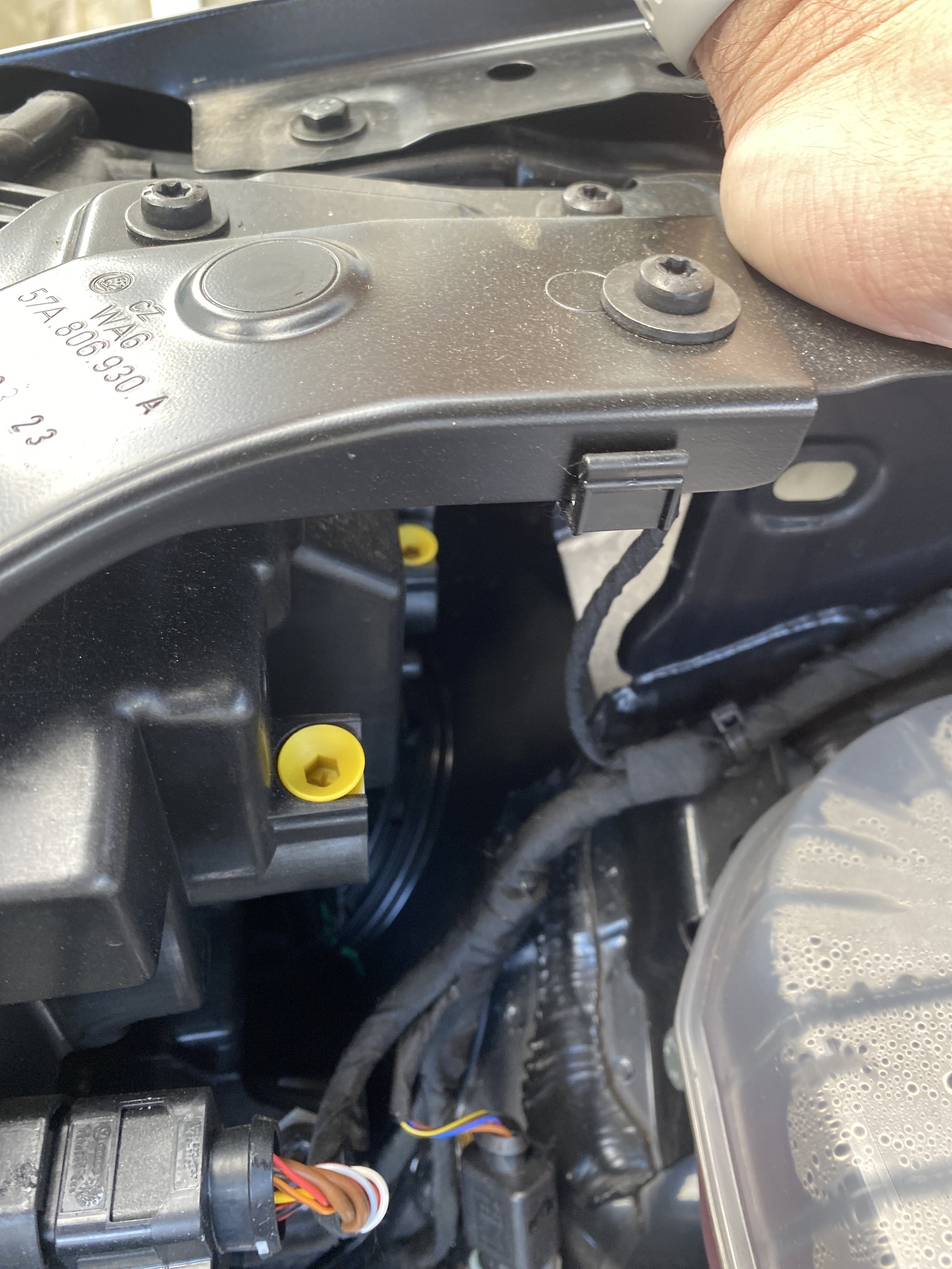

  8. Which screws do I need to turn to lift the dipped beam up a little? Skoda have been conservative with the height setting as usual, at motorway speeds my fancy headlights were shining a mere 2 car lengths ahead. Im assuming with the adaptive function it is similar to the old xenon types where I need to turn off the adaptive part before doing so. Disclaimer, I will check with my friends garage that they are still within spec (when I get chance) and will be hyper aware of oncoming people flashing me if they are still too high and will back them off accordingly.

  10. If they are the adaptive type like in the octavia. I agree with the **** poor performance at UK speeds. There is a section detailing switching off the poor weather option/rain option whilst still retaining adaptive light functions. Perfectly legal and safer as you dont have to drive above 68 to get the car to light up the road in front of you.
