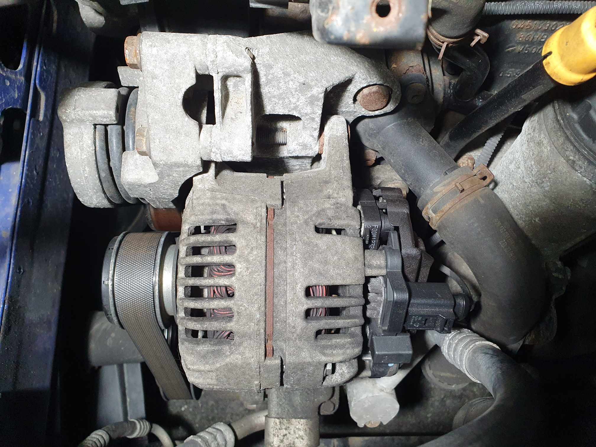

I had to change the hole alternator in the end. The bearings in the pully where noisy when spinning by hand. Then the regulator or brush pack had gone as well. I got a good deal in the end new alternator free postage and £85 with 3 year warranty. I think there a surcharge I might get £35 back just waiting on this.

I know you can change the regulator and resinater. But there also the pully with bearing. I looked in to all this with winter here I thought changing one part anther might go anther time soon due to mileage 166000miles. So for the sake of £85 with 3 year warranty it was a lot easier due to my work business. very busy at the moment. The battery light staying on longer now so it was time to get this changed asp.

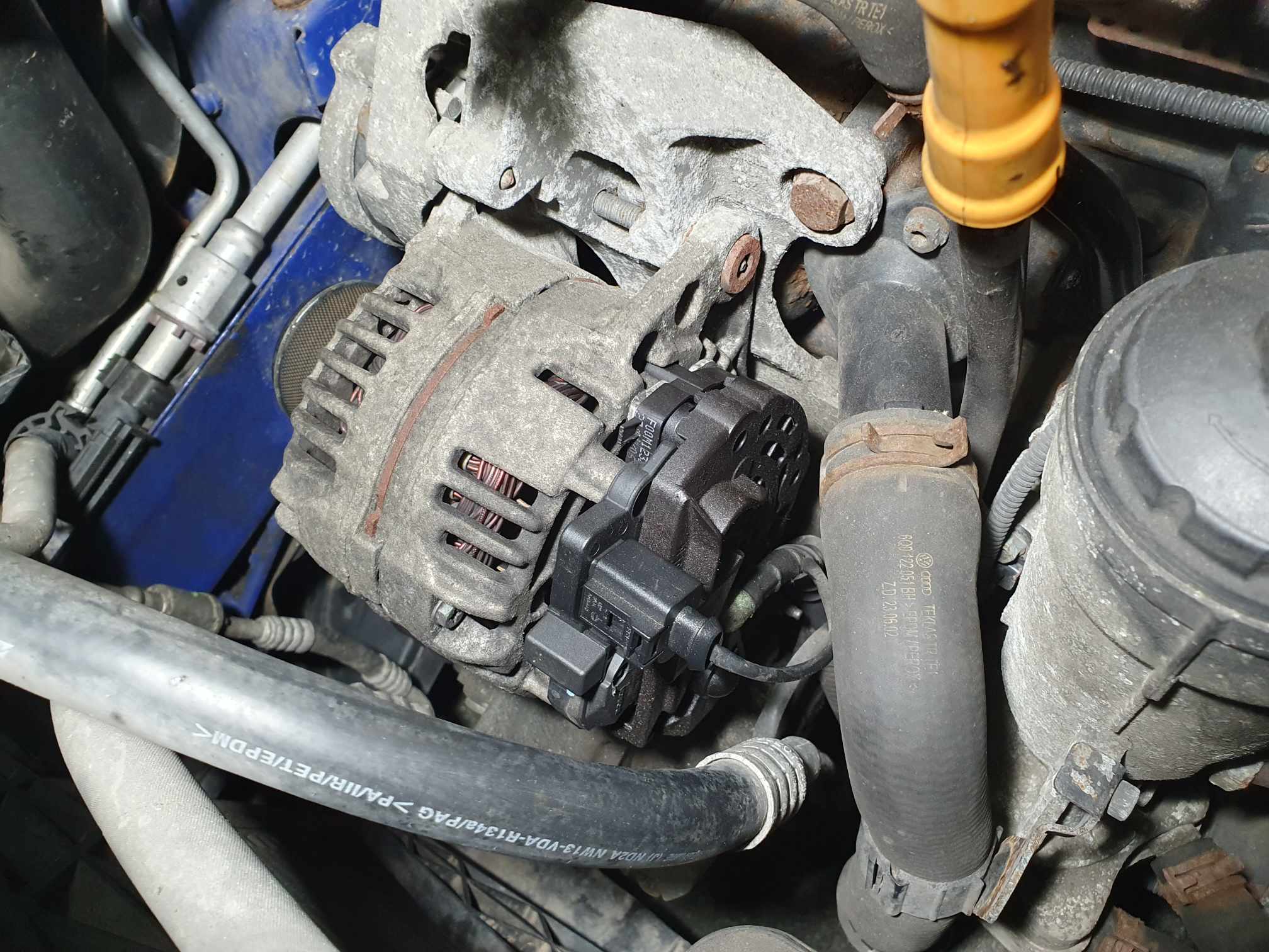

Hello I've got a brand new alternator which I decided to get due to buying a brand new one in the post £85 with 3 year warranty. I know you can change the regulator and resinater. But there also the pully with bearing. I looked in to all this with winter here I thought changing one part anther might go anther time soon due to mileage 166000miles. So for the sake of £85 with 3 year warranty it was a lot easier due to my work business. The battery light staying on longer now so it was time to get this changed asp. I'm looking at changing the alternator on a skoda fabia 1.4 tdi there any good details, pictures, videos etc how to do this? Thanks

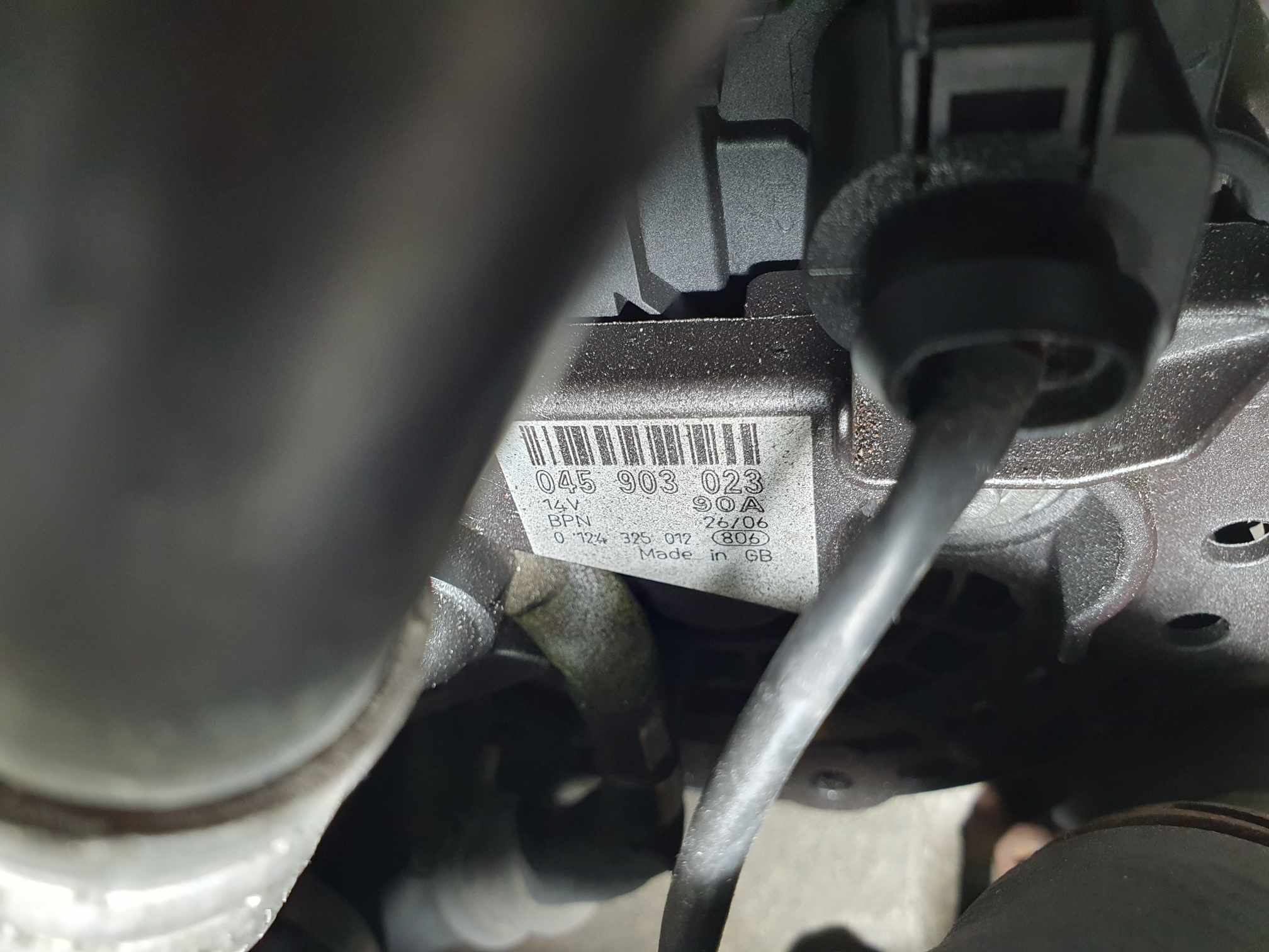

90amp £85 and the 120amp £185. I can get free postage or collect down the road and £33 cash back which is a good deal if it's the 90amp one. The regulator £22 and the brush pack about £25. Mileage nearly 166,000miles.- Battery light coming on and off
I've fixed the reverse lights now the wires broken on the switch. It was near where I fixed the window connector in front of the gear box. I've checked the wires and connector on the alternator they all look in good condition. I did anther test today using a cig lighter charger showing the amps while driving. When the battery light off it charges 14.5v. But soon as the light comes on it will drop to 12.5v to 13v. Then when the light off back to 14.5v So this sounds like it's the alternator now? I'm looking on gsf car parts there seems to be 2 alternators 90amp and 120amp? Thanks- Battery light coming on and off
