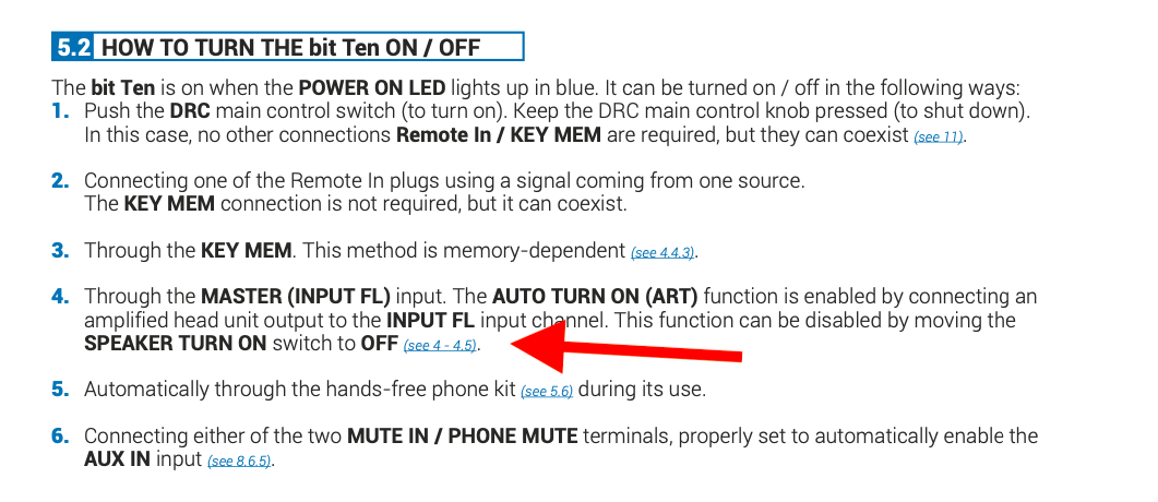

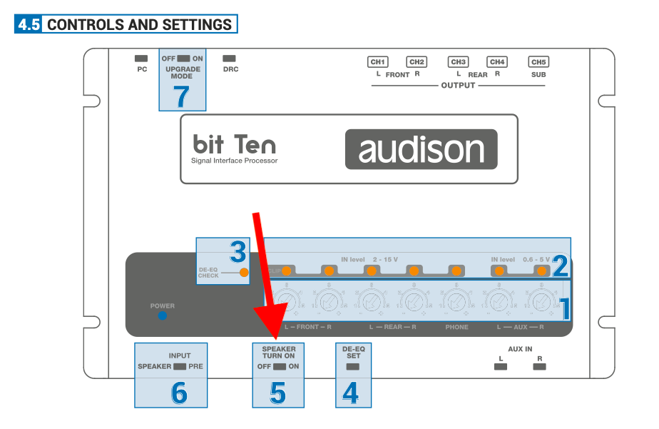

Thank you very much @langers2k Looks like the Bit Ten has a few options for powering up, including auto turn on based on speaker input. The Hertz amp already has auto turn on based on Front speaker inputs. So looks like it is a question of hooking it all up and see how it goes.

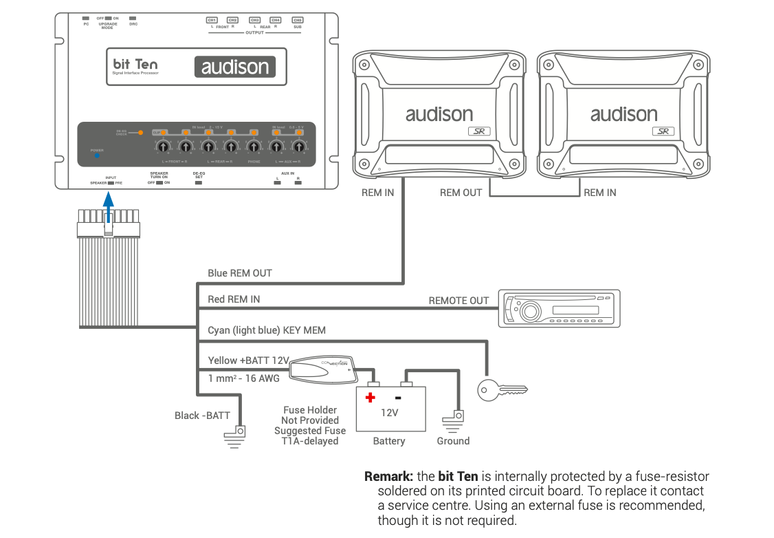

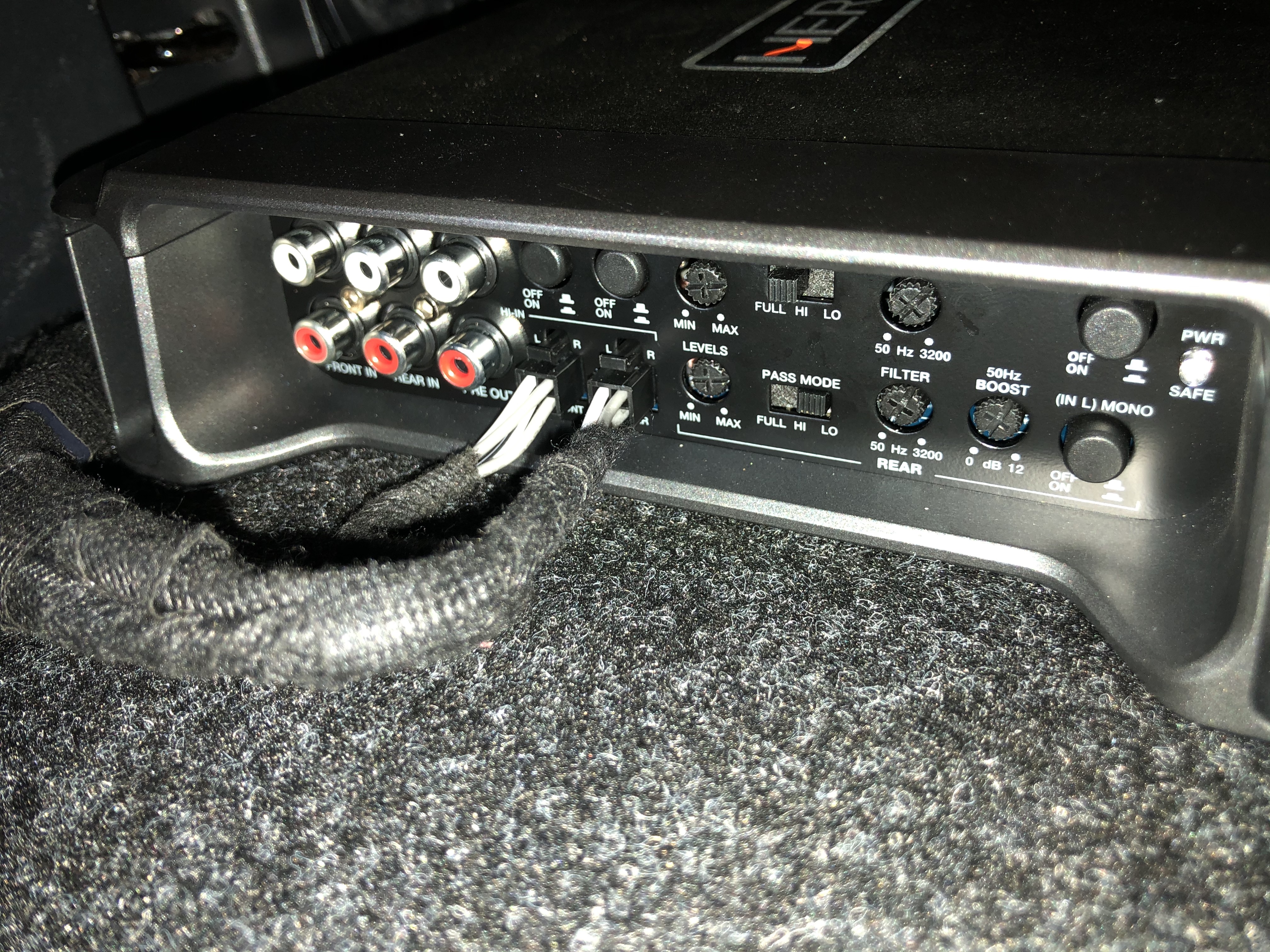

It is the Audison Bit Ten. These are the screenshots of the relevant pages from the manual. Also attached is image of the amp and the inputs going into it. Keen observers would notice I am using the rear speakers as sub as the low end is so boomy. So, after a bit of tweaking around I figured the best option without a DSP is to use the front speakers as mid+high range and the rear speakers as sub. That is giving me a decent flat sound at the expense of loss of overall sound level. I am just after a flat sound profile.

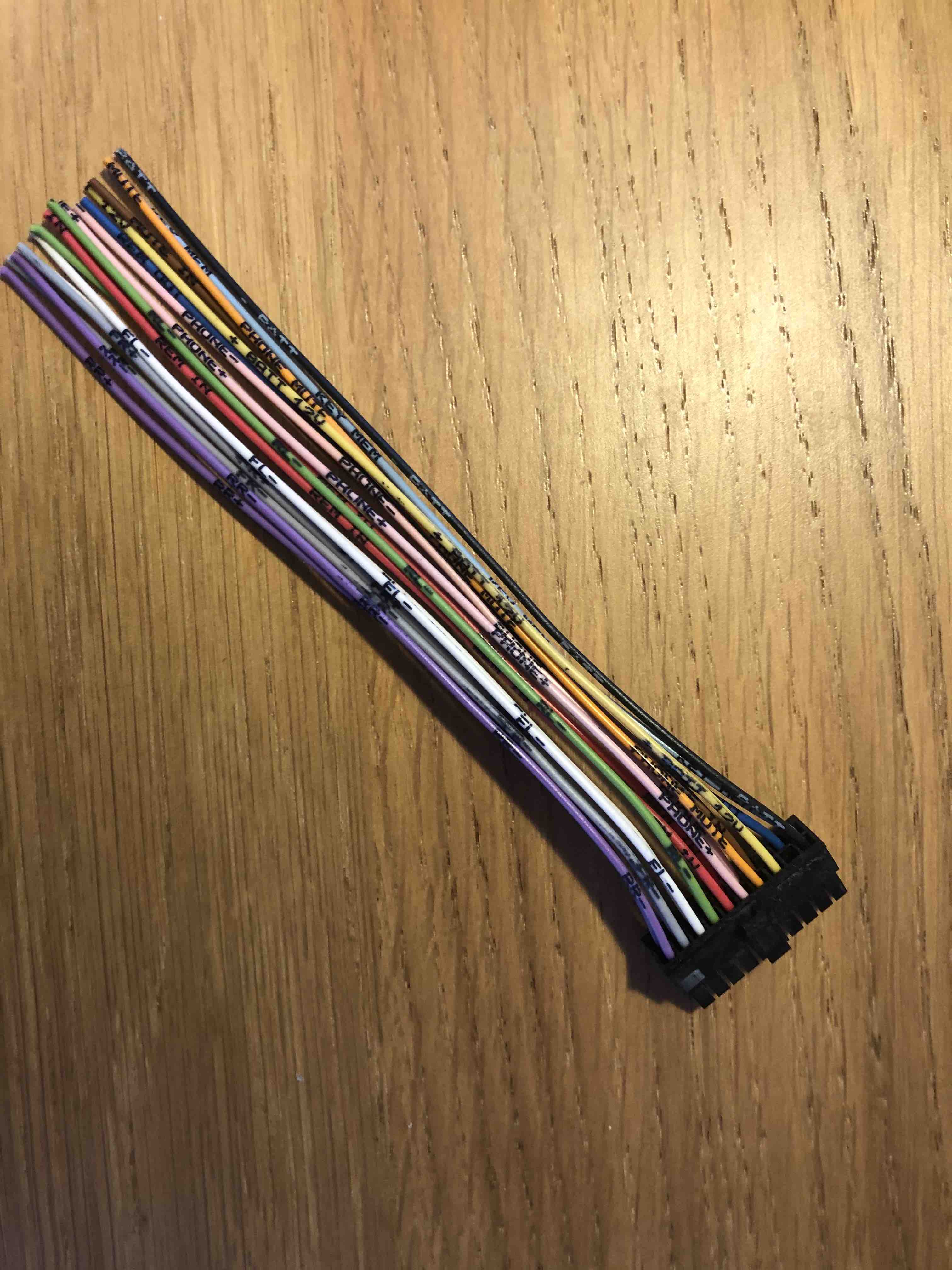

Need help with self installation of a DSP. I had a Hertz amp and speakers installed a couple of weeks ago and after discovering the problem with the EQed output of the factory stereo planned on having an Audison DSP Bit Ten installed. And the government announced the lockdown! So here I am. I have a Hertz HCP 4D installed in the boot of the car with high level inputs going into it and speaker outputs going out to speakers. I presume installing it in the rear will be alright. A few questions that I would be grateful if someone could provide guidance on: a) for power, do I install a distribution box and run power cables to amp and DSP (assuming I add another fuse between distribution box and dsp). b) then, is it a question of connecting the speaker outs from the headhunt into the DSP and RCA cables to AMP? The dsp came with this connector with helpful labels on the wires. I presume I can ignore the wires on the connector other than the battery and speaker in?
