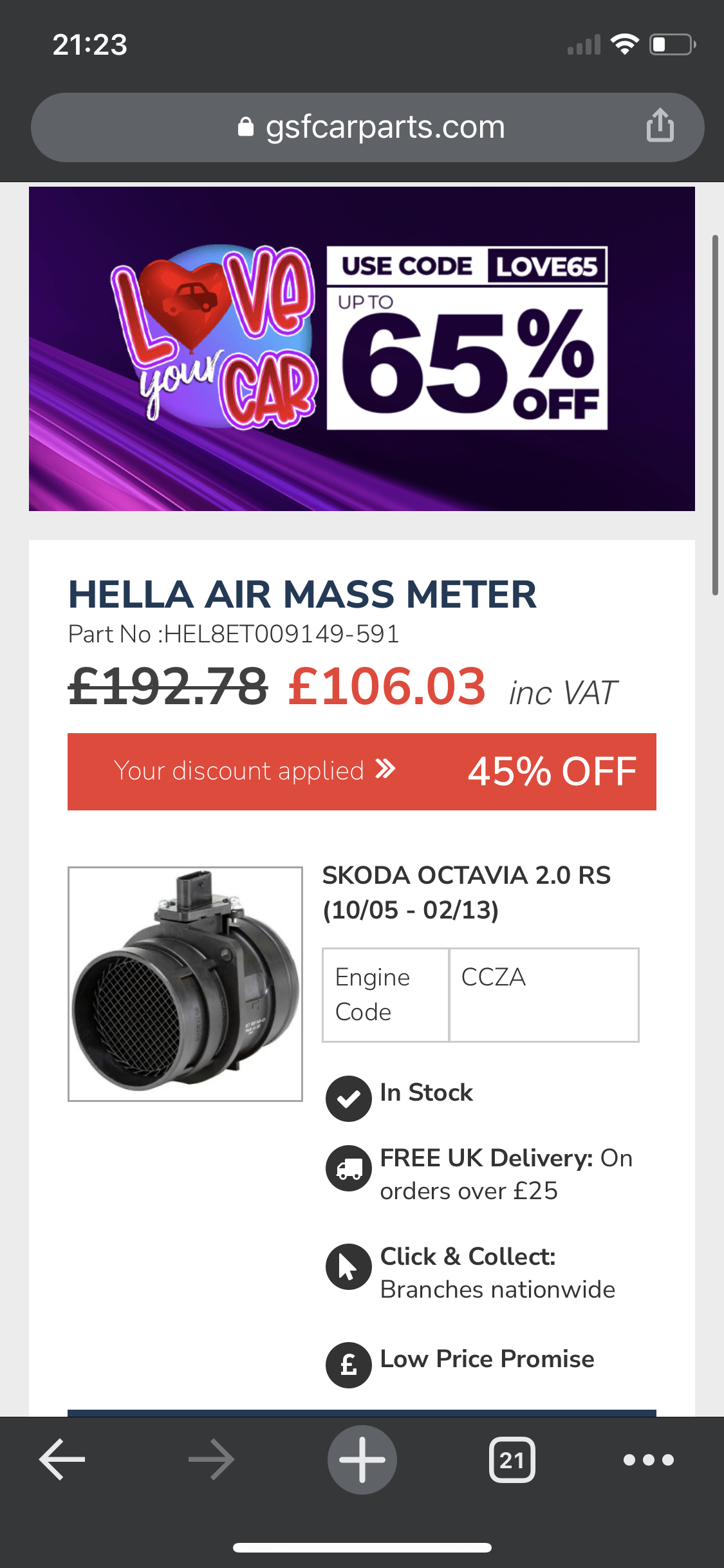

I swear there used to be a lot more tech guys on this board. anyway, I managed to catch the engine misbehaving. I pulled the plug off the MAF in time and the revs smoothed out. I replaced the MAF yesterday with the hella part from GSF. Car has started perfectly since, and is noticeably more responsive. just need to get underneath and rip off the rattling heat shield and that should be it for a while.

Hey guys I have a long term start up problem on my 2.0TSI FL Mk2 Octavia. I'm suspecting a possible dodgy MAF, but would appreciate it if someone could help me check things over with VCDS if this is likely to tell me if it's a culprit, before I spend a fortune on a new MAF?

Not sure how to do that without VAGCOM. my mechanic said it may well be the MAF it does smell rich as hell sometimes when I start it, and occasionally get a bank 1 rich ecu code Anyone got a spare known good MAF before I spunk £100 on one?

This has been an intermittant problem since I have owned the car (2 years). A few months into my ownership I: De-carboned the valves Replaced all injectors Replaced all coil packs Replaced PCV valve Replaced spark plugs. The problem has become more frequent in recent weeks, occurring previously once every couple of months, and now its a few times a week. I turn the ignition on, fire the engine up. It always starts first time. Once started, the revs drop and it feels very lumpy, almost like its running on 3 cylinders. It won't rev cleanly, but will rev roughly, again feels like a lack of cylinders but that is just speculation. It throws no fault codes at the moment, and hasn't for ages. But has occasionally thrown one about running lean - I think it is an air leak as nothing else is wrong. Very occasionally the car then stalls, and I have to restart it and rev it a bit. Driving it slowly causes it to kangaroo a bit up the road, but as soon as I've driven a minute or so, it drives smoothly and has full power. It happens from freezing cold and luke warm, has typically been a problem on very cold mornings. Given I have replaced all the obvious things, and it runs perfectly once warm... And throws no codes, I don't know where to start. But do suspect an air leak of some kind that warms up and seals itself.

Yeah no CEL light on but did see a bank 1 rich code. I've seen that from time to time. Most of the time the noise is not present, and it's likely the evap. I read a post by @TheClient who had a similar situation for many many miles. If it happens again I'll put a long bar against it and see if I can confirm. The car is starting and performing very very differently now, I'm pretty pleased to get it back on the road.
